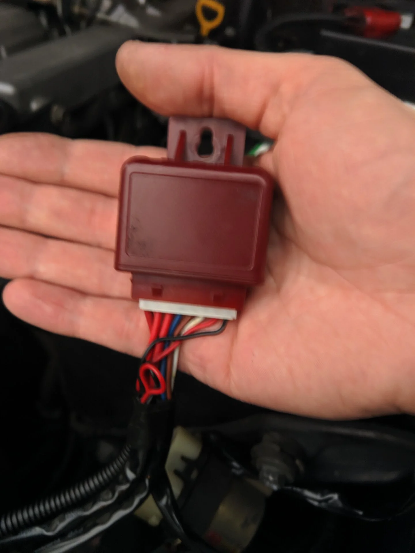

Recently acquired an HZJ73 - yesterday the headlights stayed on when I tried to turn them off. Long story short: tapping the relay in the engine bay solves the problem.. for now.
It looks like there was some LED conversion done at some point. Koito H4 lamps but with LED's inside. There is a relay in the engine bay right by the right headlight, which appears to be the problem. I sprayed some contact/electronic cleaner in there but no relief. 9/10 times they stay on, but tapping the box instantly shuts them off.
I don't know any other solutions other than replacing the relay. Hoping someone recognizes it or has a better suggestion? There is no writing anywhere on this thing. I'm assuming its not stock with the LED conversion?
Thanks for any help!
Sounds like the relay is sticking! It's aftermarket and looks like there was supposed to be a label on that indented plastic portion of the relay case. If you can't find it on google by counting the number of pins it has, it might be easier to outfit another LED conversion kit. Good luck!

Did you just have one relay for both headlights? Every harness I've seen has one for each light, as shown in the photo above.
That image isn't showing up for me, but yeah every system I googled had a relay for each. This seems to have the Red relay box in my photo, but then each headlight also has a metallic looking "digital ballast" which is possibly also working as a relay? I am out of my depth when it comes to this..

Hopefully the PO didn't do something boneheaded, but they shouldn't have needed to remove anything to switch to LED's
It sounds like it is possible that these aren't LED's at all but HID's if they have ballasts. If that is the case, I would be inclined to rip it all out as well. You should be left with just the 2 original 3-prong ceramic plugs that plug into the bulbs

Bingo! They were HID's (PO said they were LED so I just assumed..). I pulled all the extra junk out of there, plugged in a couple halogens, and promptly fried them :hillbilly: Looks like the pair of 24v bulbs I had on hand were actually 12v :cool:
Once I track down the correct bulbs I should be good to go for a while! I might look in to those Holley retro headlights in the near future. They look pretty sharp.

Hmm well I'm no expert when it comes to lighting... I can snap some photos of the old lighting system when I get home. The digital ballasts stated HID on the labels. They were fitted into my Koito halogen glass with some adapters that appear to be made for the conversion. I believe it was done in Japan at some point prior to export.
Ahh ok it sounds like the Holley's aren't made for a 24v system then? The halogens I picked up actually produce a good amount of light so I'm pretty happy with what I've got now. 👍
I mean, if you had ballasts then I'm assuming it was a legit HID system...but I'm just wondering how the projector lens would've fitted into a stock housing. Seems effectively impossible, so yeah, some photos would be great.

I'll still snap a picture, but this HID system on Ebay looks nearly identical to the one I yanked from my 73. It doesn't show the little adapter/shields for the bulbs that go in the housing, but must be the same or very similar.
