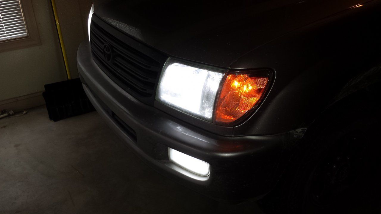

Here we go, easy install and they look awesome...very bright! I also changed the running lights (168s) with some LEDs I had left over from Pfrans interior kit. Can't wait to check them out at night.
I'm guessing they will be bright to opposing traffic. The pattern on my garage wall is a bit higher than stock.

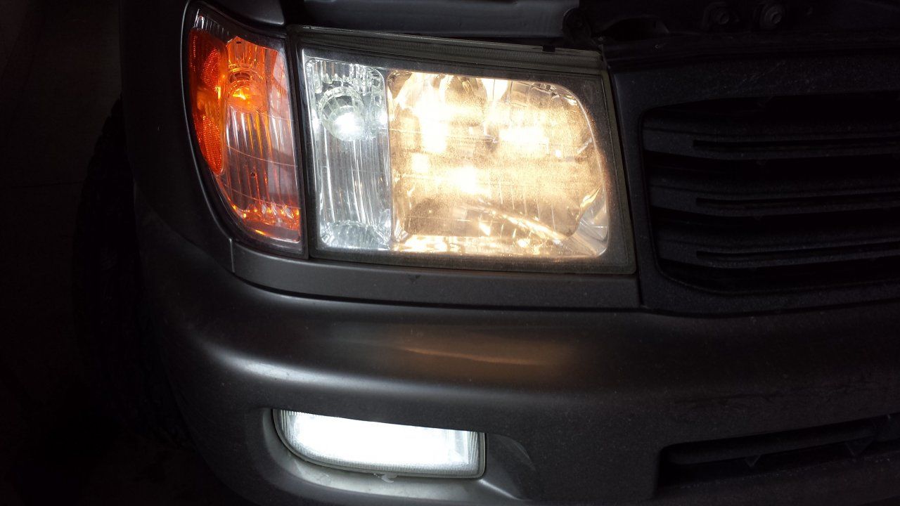

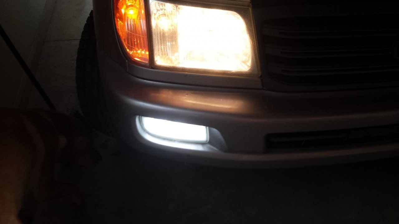

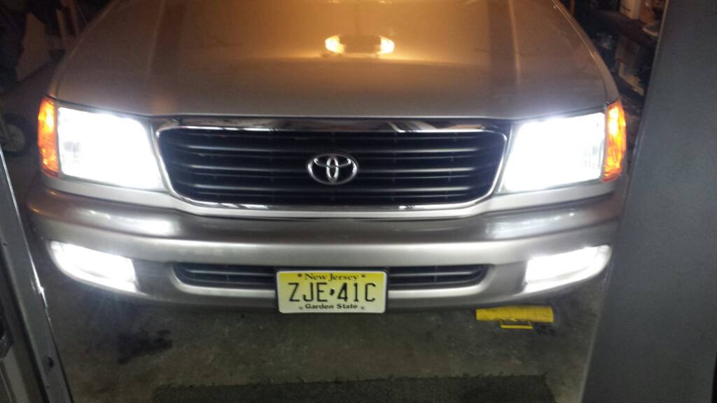

My drl doesn't work either. I just installed authentic torchstar led 9005 and 9006 last night. Nice upgrade but no working drl. Before and after pics. I already upgraded the fog bulbs with led. Driver side has an hir bulb in the before photo
