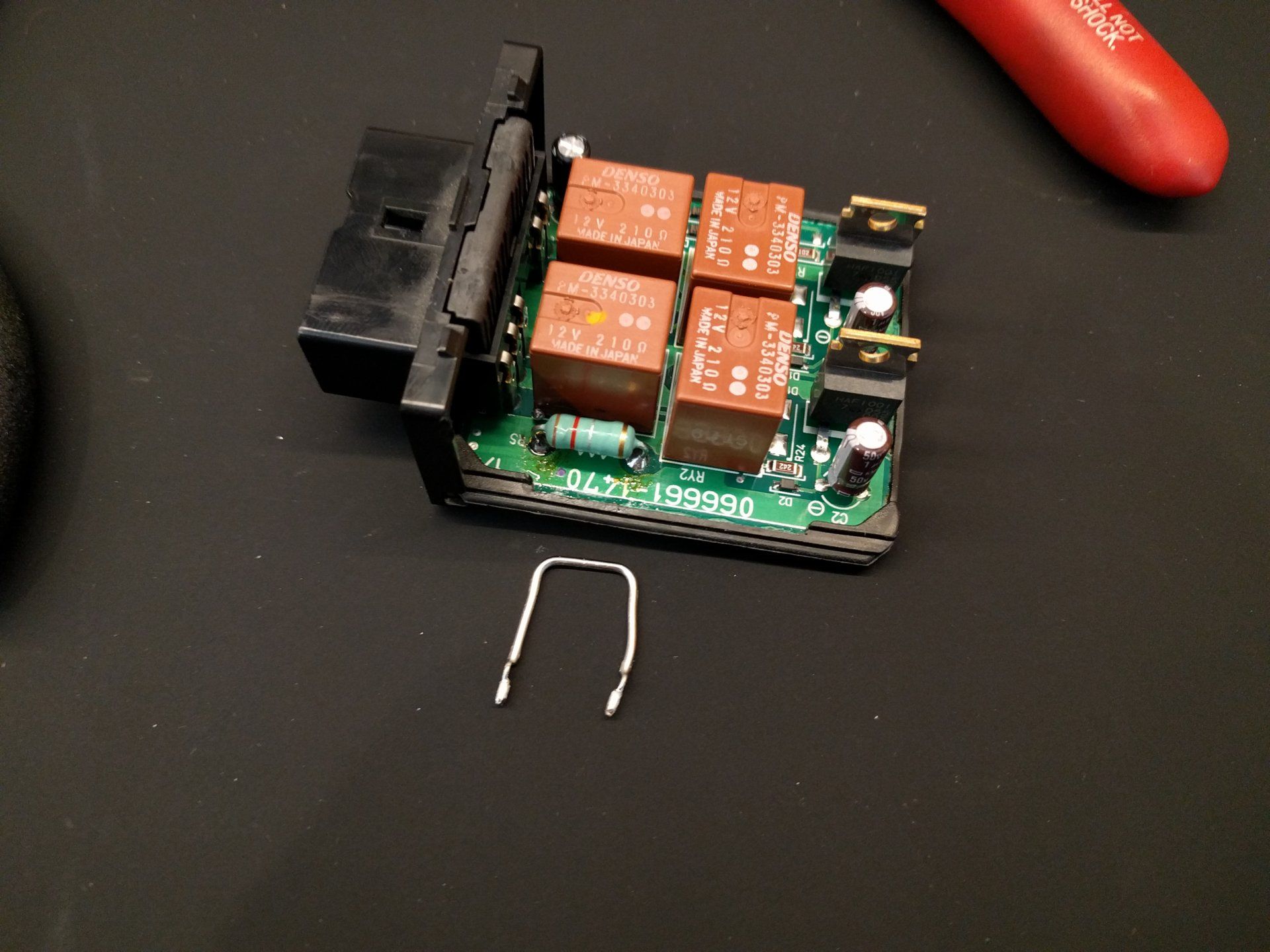

My only thought was I could have gotten the resistor too hot while soldering? Weird that it works fine on the turn signal.
