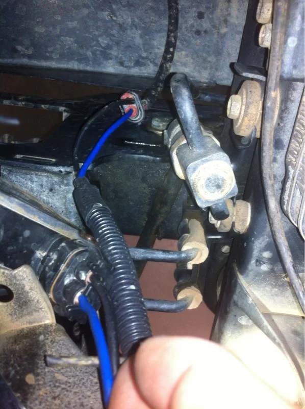

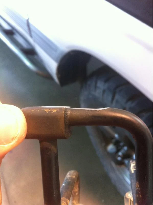

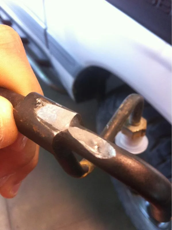

They found it. I apparently hit hit the ARB so hard I crushed the front lines by the ARB mounts.
There have been at least 1-2 others who had their ARB bumper rub/damage the AC line in that same location. All ARB owners should check clearance.

The ARB bracket apparently interferes with the AC lines upfront. I can see where it has flattened the line on the bottom from rubbing and pressure. I'm going to see if the tech can put a small rubber pad or bushing on the AC line so this doesn't happen again

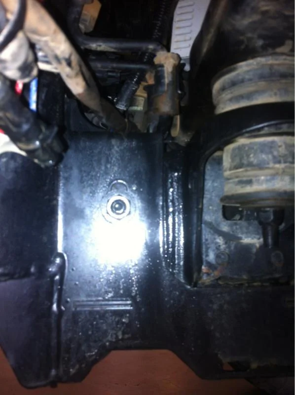

I found my leak this weekend. 5/16 (8mm) tube. Right behind the front passenger tire inside the little shield underneath the hose clamp. Pinhole on the side of the tube. Probably from the road salt here. That cover seems to act as a trap as well.
Cleaned it and degreased first. Then applied a heavy filled epoxy over about 3 inches of the tube. Charging it again this week. Curious to see if this band-aid fix will hold-up.
