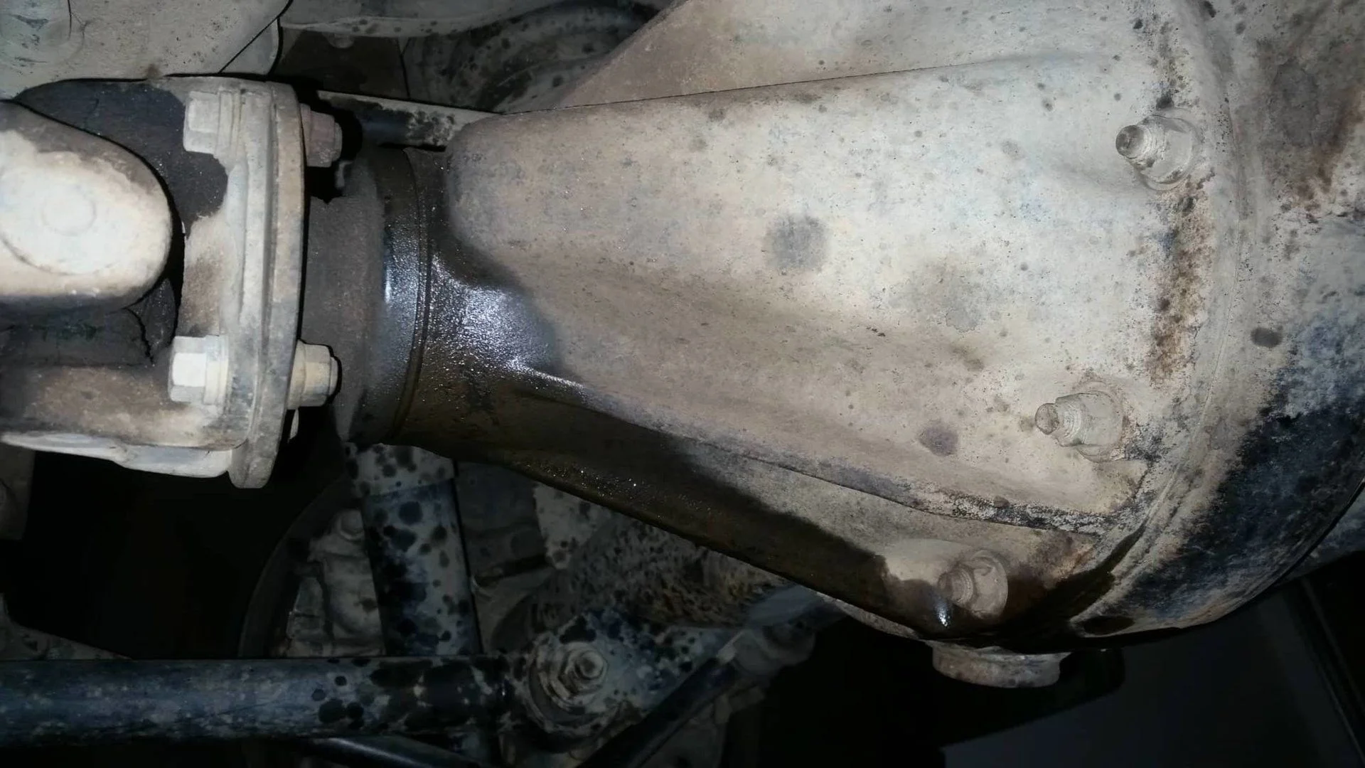

Hey guys on my last outing to the sand dunes here in NZ i noticed a noise reversing up a slight inclination in the sand, had a check under the truck and sure enough the rear diff has a leak at the head where the shaft goes in, will add pictures in hopes that may show what i'm trying to explain.

That is a leaking pinion seal at minimum. Could also mean the the bearing preload is not set properly, requiring possible crush sleeve, bearing replacement and deeper. Have a pro check it out before it gets worse.

By the looks of the oil on the spring and shock in the back of the picture, that thing is leaking bad. I would check to be sure you have oil still in it before you drive it any more.

I would not call that leaking badly. It takes an incredibly small amount of oil to coat everything under your truck. I second checking the breather. I've replaced both the pinion and one of the hub seals, found the plugged breather after the fact.
