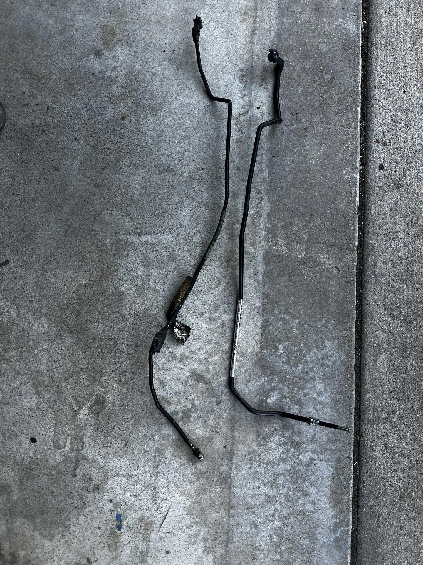

Good evening I am currently camping in Colorado and noticed the ahc line above the rear axle leaking from corrosion. It’s the 48998-60010 p/n. The line has a foil wrap to protect from heat of exhaust below it. The rust was at the edge of the foil.

I've successfully trail repaired a high pressure power steering hose with "Self-fusing Silicone Tape" and a hose clamp. HP P/S hoses are rated about 1500psi. For you, I would sand down the area with fine sand paper, roll the silicone tape tightly over the hole and put a tiny (maybe 1/4") hose clamp over it all. There's no curing time for the tape.
If you can't find the tape, then maybe JB waterweld. Wait until it cures (1 hour) and then some type of membrane over it and hose clamp.
Ok I installed a new tube and clips today, where is the best place to initially bleed out all of the air I introduced with the empty line? According to diagrams it looks like this tube goes from pump to height control valve. Does that mean the air will immediately scatter throughout the system or can I catch the majority of it before doing a standard flush and bleed? Thanks
Is your truck at N or H height now? The best thing you could do is lower it and push the air back to the reservoir.
