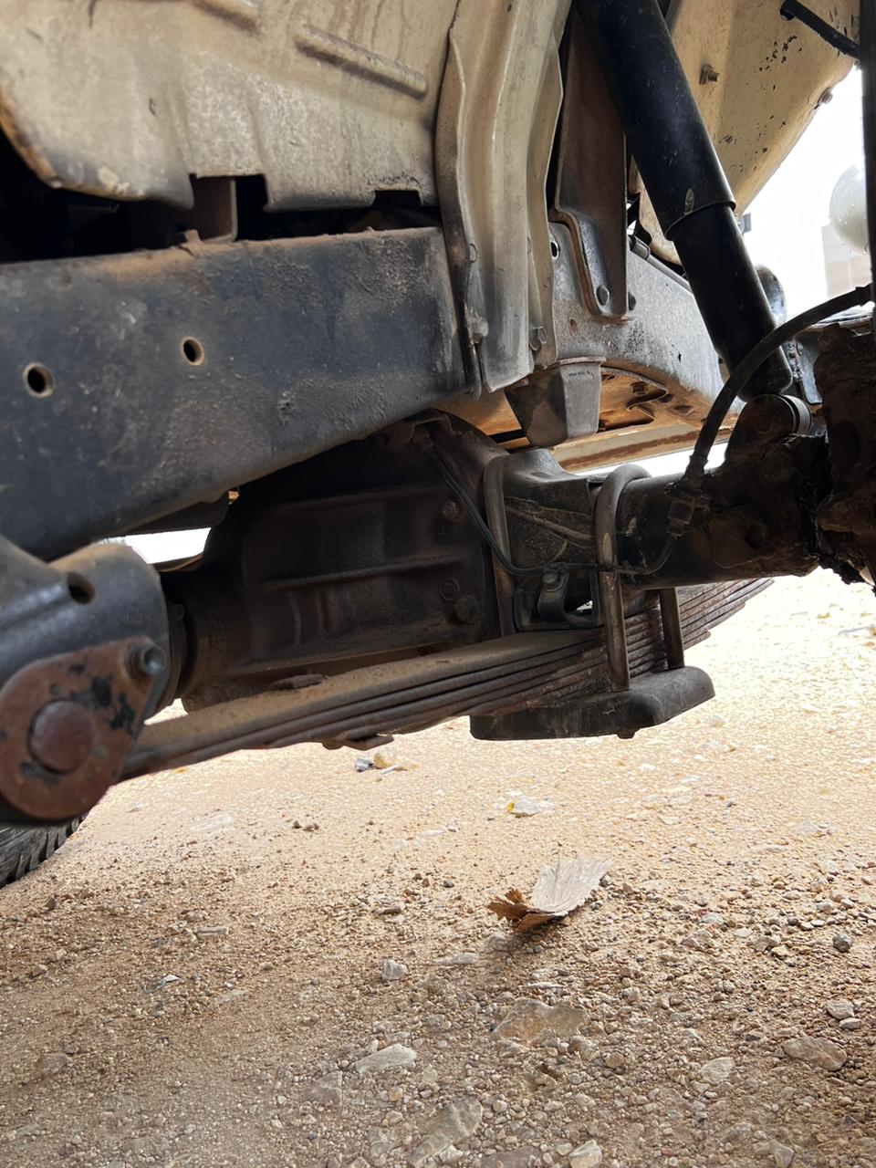

I just bought an fj40 and i was wondering if I should change the leaf springs. They barely have any travel in the front.
are the leaf springs bad, or should I buy better shocks?
this is my first project car so, please bear with me and my bad questions. thank you :)

I have very short travel, hitting the bump stop on almost any bump.

Those springs are gone…..2nd to last picture says it all….the retaining clip is broken and the long (top leaf) is deformed, spring stack is separating.
Agreed. Negative arch on a stock 40 spring is not only a sign of being worn out; it is a sign of fatigued metallurgy and impending failure. Replace ASAP!
thank you i guess ill be ordering new ones,
