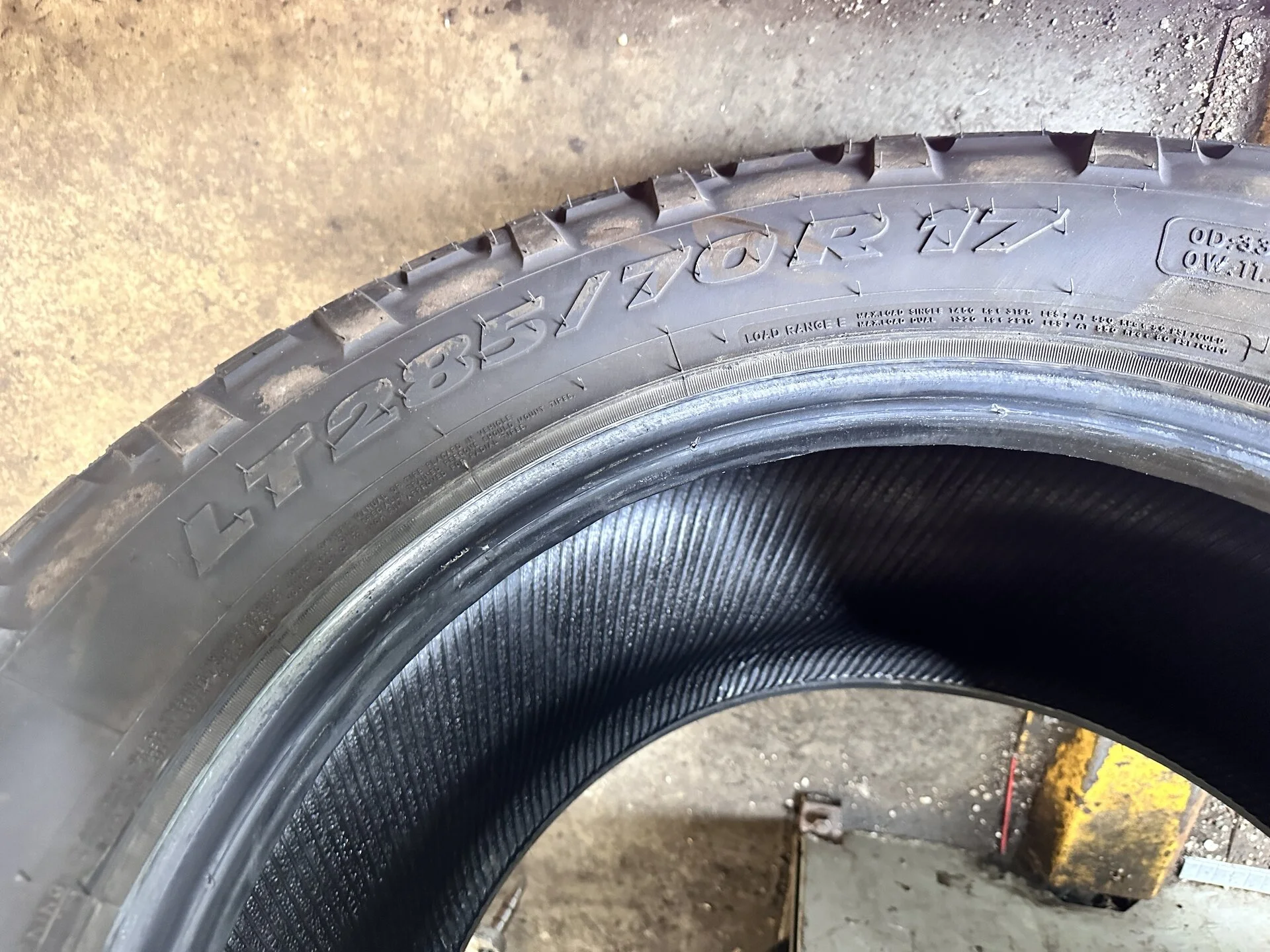

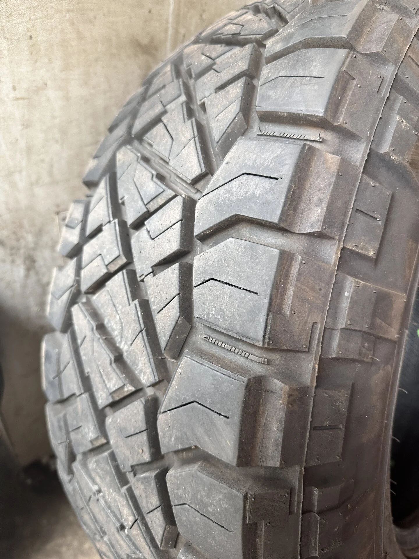

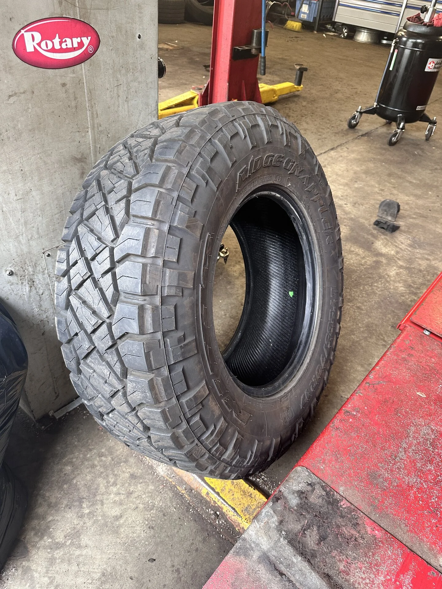

Would anyone at LCDC be interested in one Nitto Ridge Grappler 285/70/17? I had it installed while at LCDC last year, so it’s still very fresh. I’m getting 285/75’s installed at the moment and just want to pass on some good karma
Here are some pictures of the tire

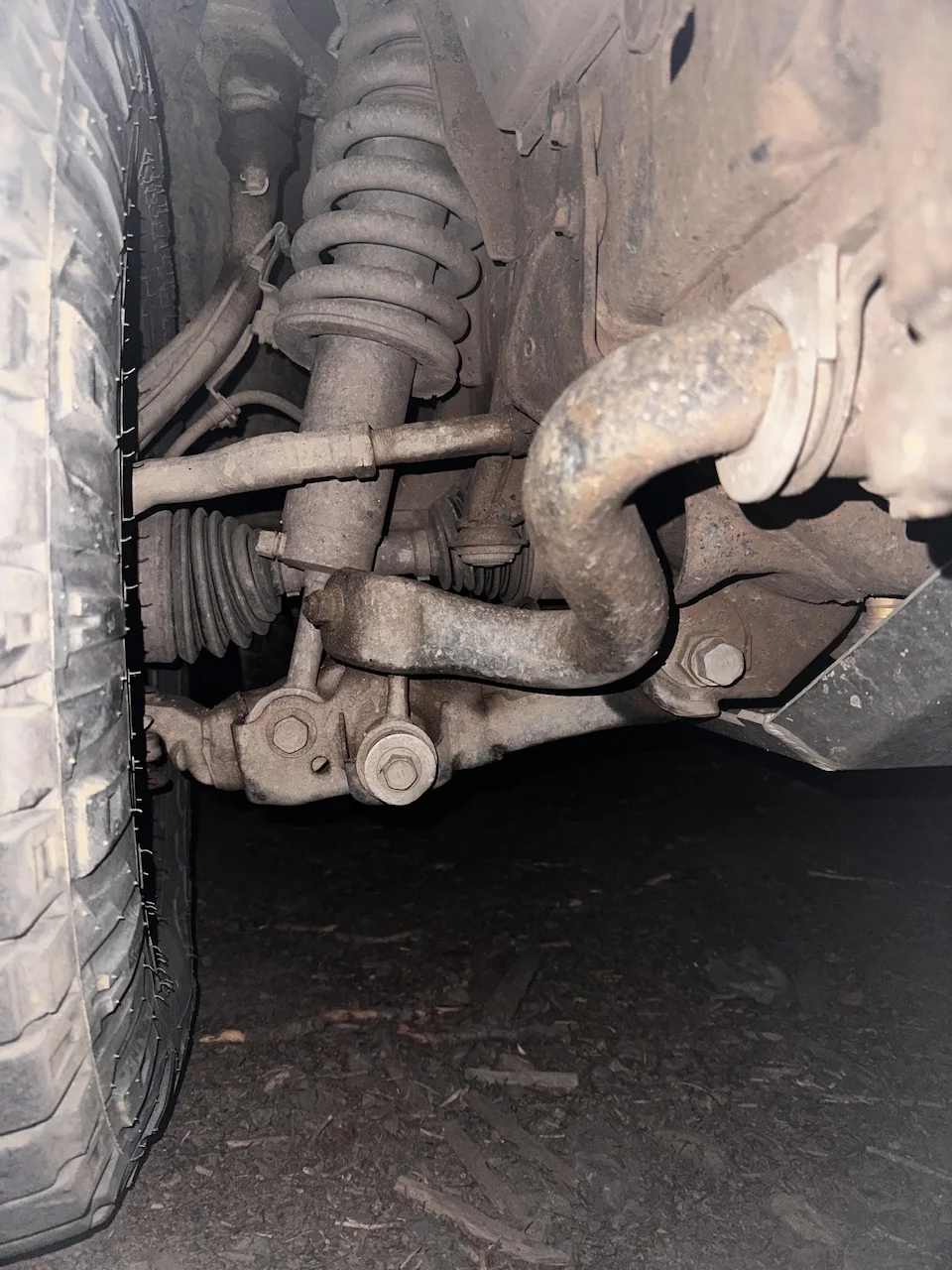

Blew out a shock bushing today. It shedding rubber and no longer centered. Anyone know where I can find a front shock lower bushing for my Tough Dog shocks? Currently in Ouray

Picture? I'm assuming it's a bonded bushing with a metal outer shell and metal sleeve ID? Any idea on the OD? We stock them for OME/Dobinsons shocks.
Fwiw, most common culprit of that is installing and torqueing the lower shock bolt with the vehicle in the air. This makes that bushing in constant torsion at ride height.

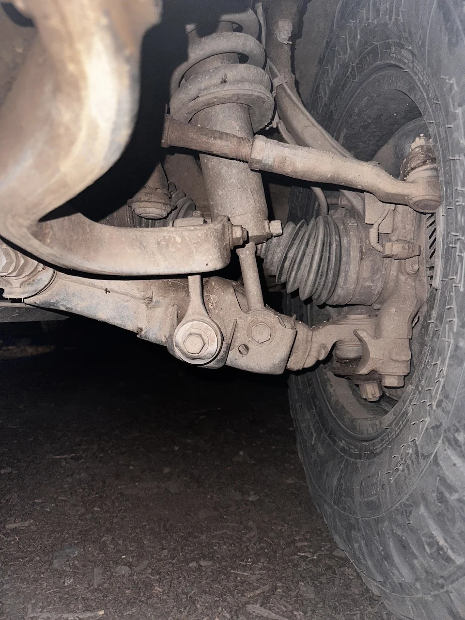

Pics below of passenger and driver sides. You can see how the drivers side is sitting lower than the passengers side by looking through the hole in the LCA. Bushing OD is somewhere around 50mm but might be a few mm larger or smaller. I tried to measure but it’s hard with the strut still installed, and I’m hesitant to pull the bolt and jack up the vehicle in case the bushing has totally crumbled and the LCA cradle is what’s largely holding things together. (And yes I know those sway bar end link washers are bent… thank Top of the World for that)

I'm not at the shop to do any test fitting/measuring but the Old Man Emu part# is 110-110-110. The ID and width will be the same as the bolt is the stock part. The OD could vary as some do between manufactures.
