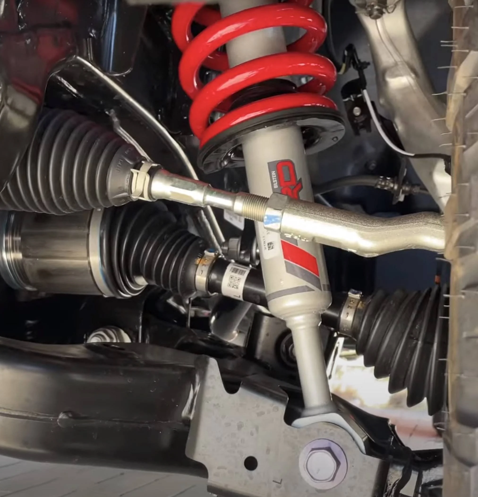

I hate the way he generalizes every brand of front strut in that video. Some brands do reach longer than the ones he's testing, and without a diff drop in place, the CV's WILL BIND at full droop, just like the Icon link that was just posted. Ironman's and Bilstein's options are not extended travel enough to warrant the need for a diff drop kit, which is why they don't require it. Dobinsons on the other hand have longer extended travel front struts that do require a diff drop, regardless of the lift height. At full droop, the CV's will bind without it in place.
So for those that listen to this youtuber, then blow a few $500 CV axles, or get a $3000 repair bill like above, I hope they're happy with the information they got.
On the 120/150 at least, it doesn't matter. Droop travel is limited by the upper ball joint. Even with stock length uniball UCAs that have more droop travel, the OEM CVs do not bind or over extend.
The over-extended CV failures like above that I have seen, are usually caused by missing fasteners. One of the 2 LCA to lower ball joint bolts, one of the LCA to frame bolts, or the UCA to frame long bolt backs out until 1/2 a UCA is free to flop around.

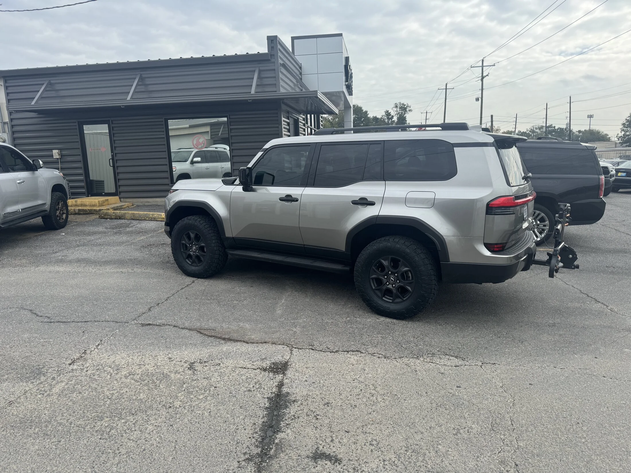

Installed the WesScott lift, Spidertrax spacers and 295/70R18 Toyo Open Country AT3 on my dad's GX. Zero rubbing and zero cutting to fit!
So that’s Wescotts 2.5” / 3/4” collar/puck kit? Looks great. How big a spacer are you running? 25mm?

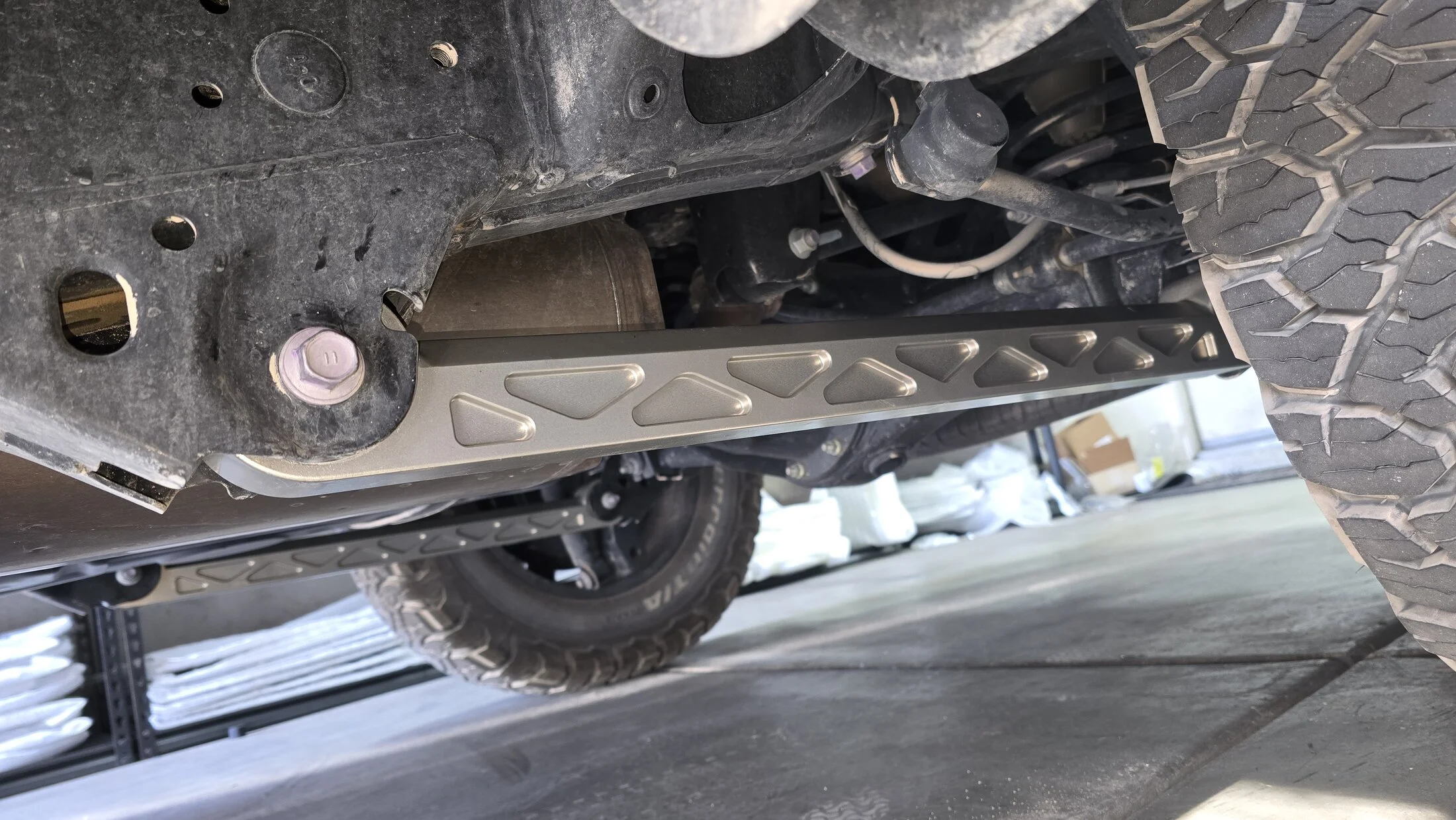

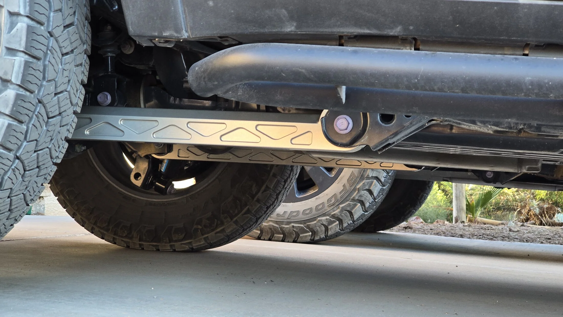

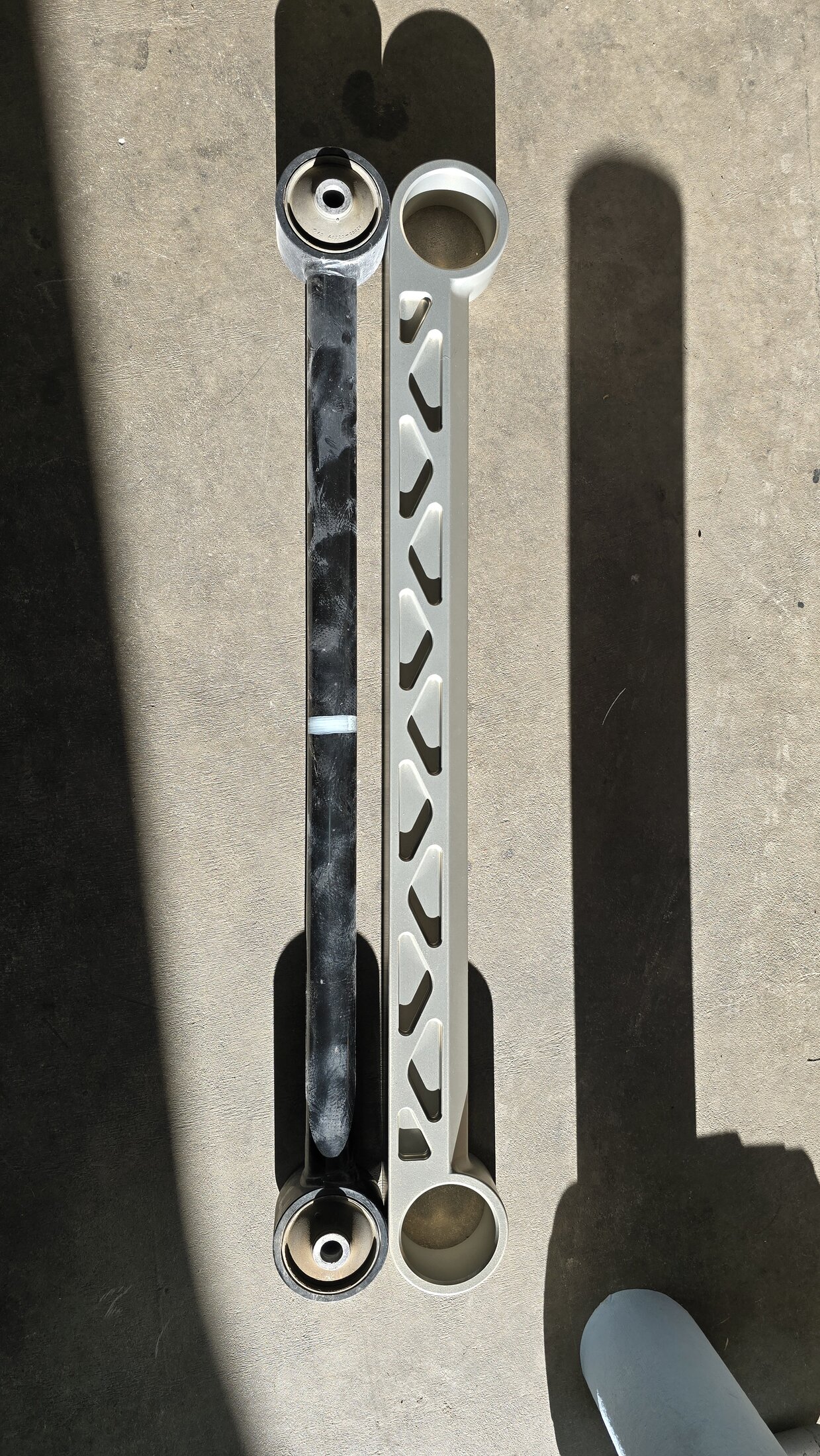

Made billet rear lower control arms that use 200 series oem type bushings for the 250/GX.
On a side note, when loosening the control arm bolts, don't lossen from the nut side, loosen from the bolt side. The nuts have 4 teeth on them that dig into the frame.
Yup, 6061-T6 with a hard anodize. Parts are outsourced.
Made a few sets.

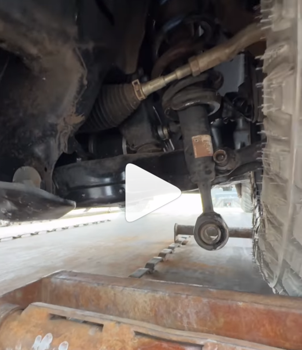

Looks like they lost the bolt. The mount is still on the LCA
Good thing the 250s still have a dedicated bump stop, unlike the tacomas, which bump off the shock.
Yeah, that just seems like such an insane idea!!
@Dixon Santana What part number or model Radflo's did you use front and rear? There seem to be several LC250 options. I'm curious which you chose and why. Thanks.
From a post in the 200 section. This is a LC250 in Australia on a tow truck.
That's wild. I'd love to know if that was an OEM assembly or if someone had removed that bolt and not properly torqued it back on (and/or if the FSM requires a thread locker on it). The design is relatively common, but not a common failure. That's why I'd suspect it was removed by someone at some point. The Tacoma LCA is more like prior generations with a double shear design, so if it did come loose, it would just ride in the bracket bucket and not drop onto the bump stops like this. Overall I think the Taco LCA is superior design, but the bump stop thing is a pretty odd omission. On my J150 I often had the opposite problem of having to cut the through-bolt out to remove - enough times that I kept a spare one in my parts box for when I needed to service the shocks. But it only ever happened on one side. Possibly this is also the case for the LC250 in this config where it'll tend to work loose on the left hand side. Either way - probably want to use some thread locker on there going forward.
