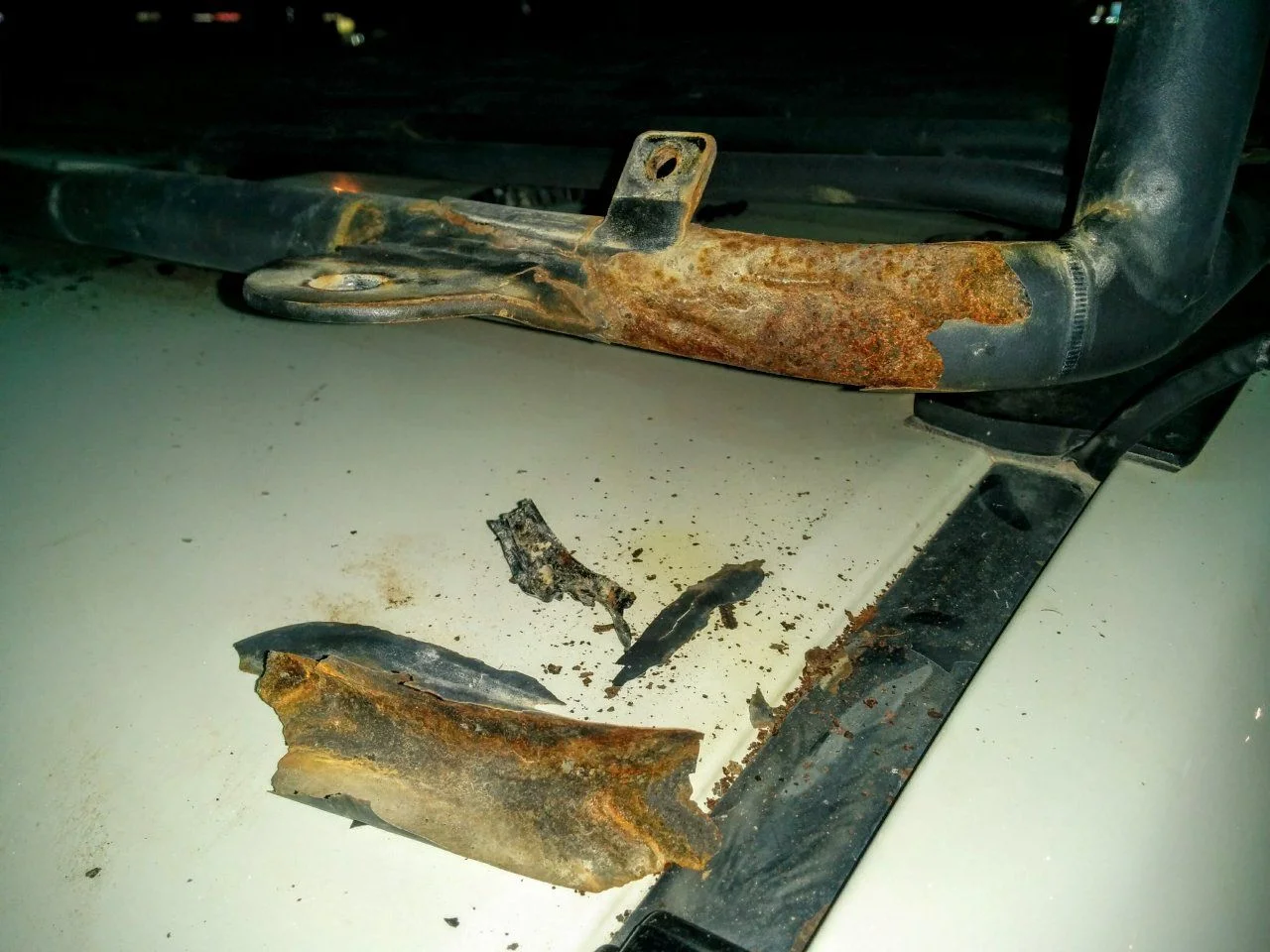

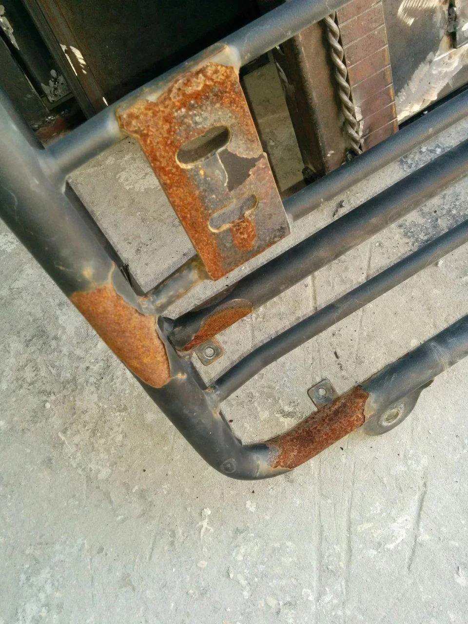

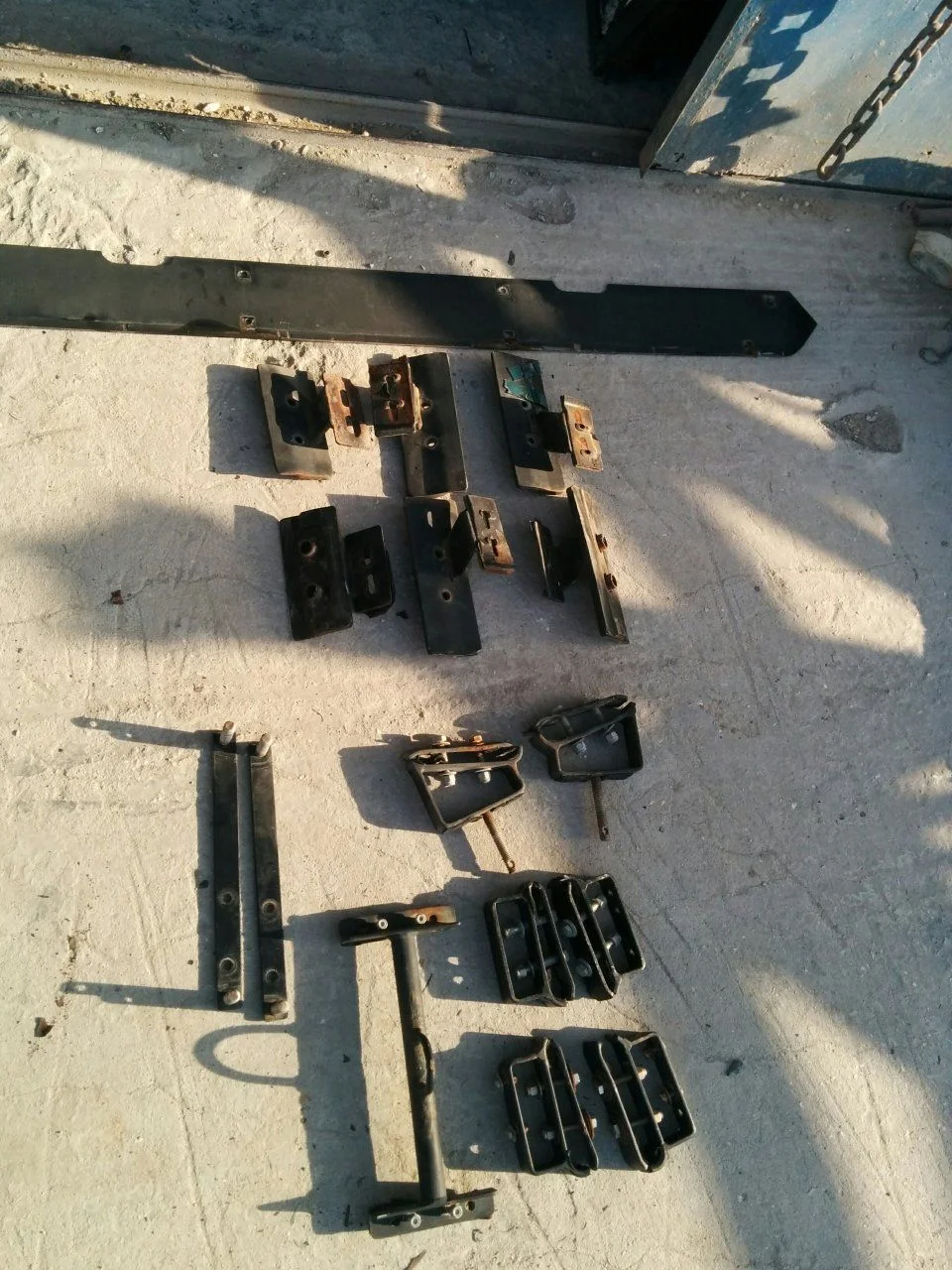

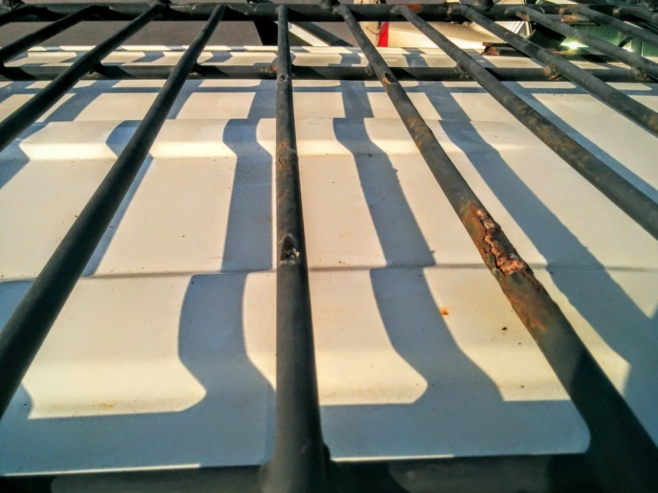

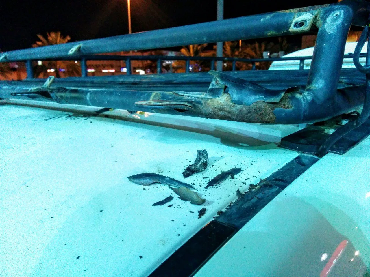

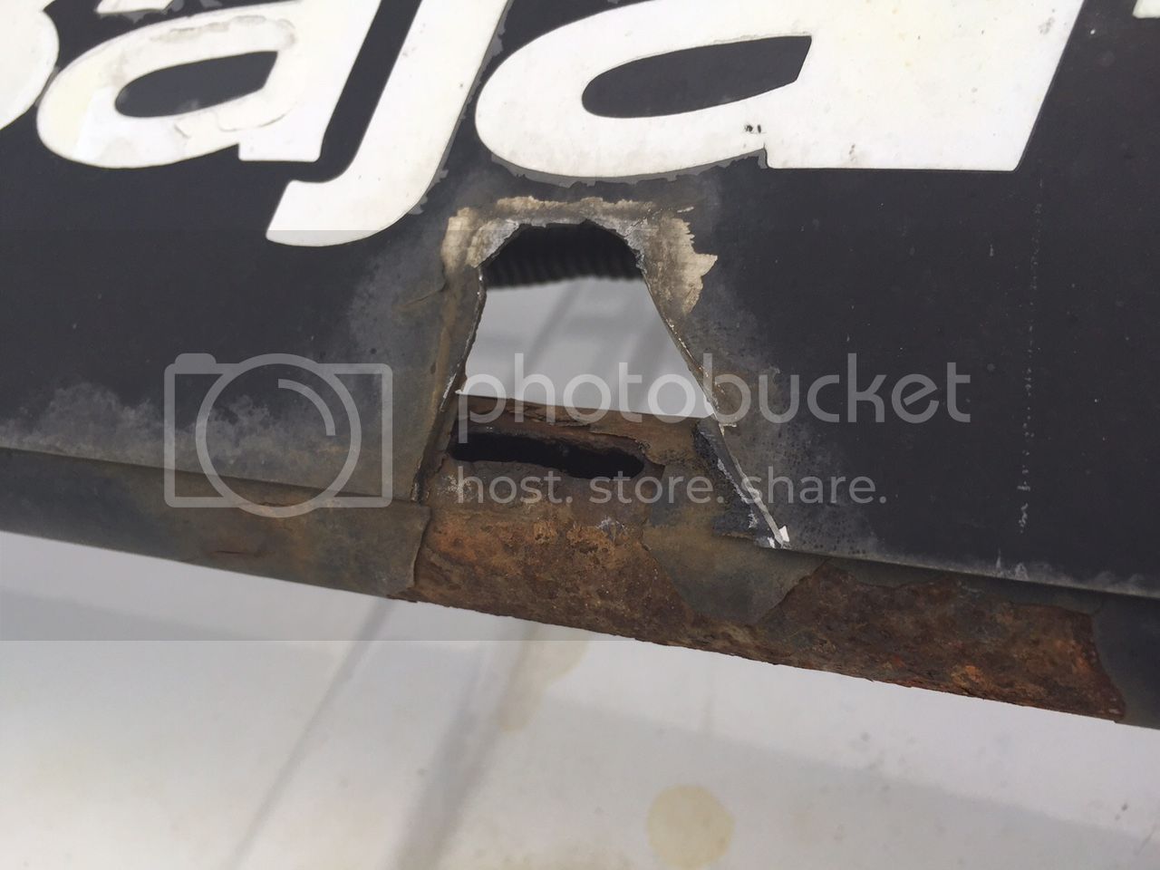

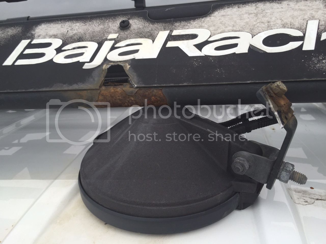

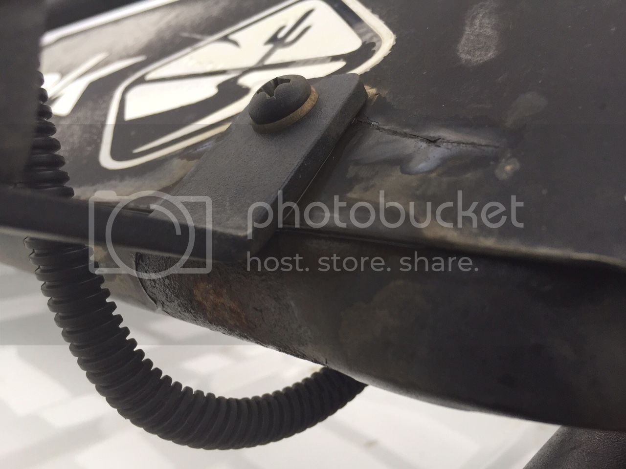

So around about somewhere mid 2015 we started to spot few rust spots and my friend went ahead and applied a rubberized coat. I didn't, I was lazy, and hence by early 2016 the rack had started to literally fall apart and leave rust stain marks on my roof. I was horrified. I took off all the mounts, LEDS and was appalled to the level of rust - see pictures below.

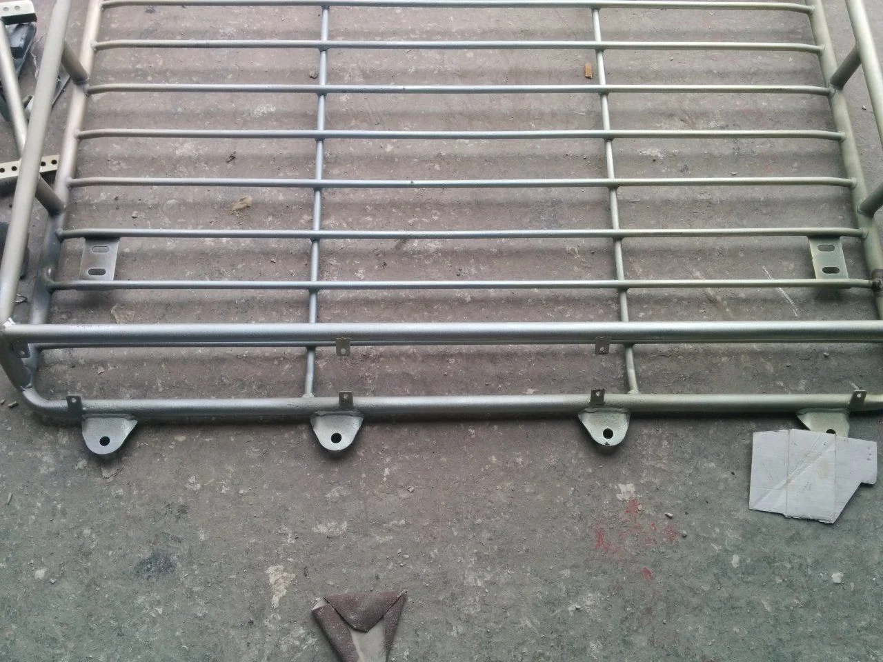

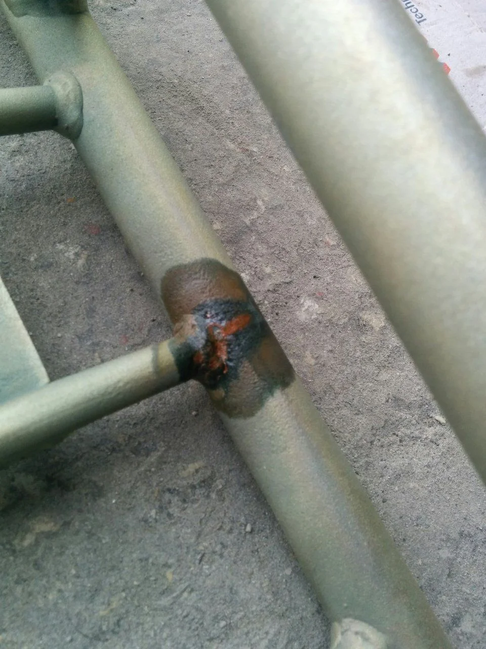

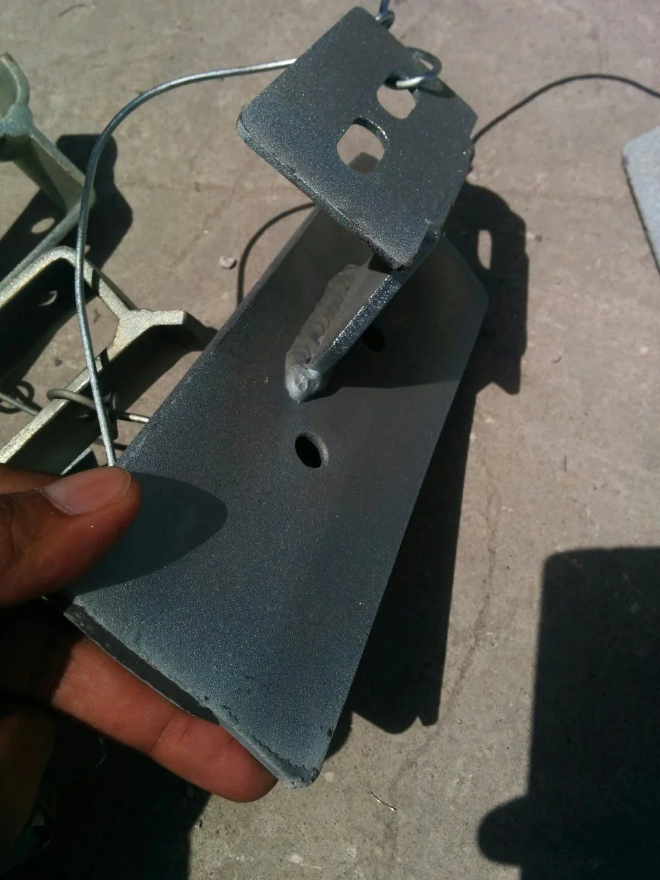

Anyways - you will see the pictures BEFORE & AFTER - in the After process, I went with ;
  • Full sand blasting of the rack and all the mounts, (did i tell you that the mounts were equally rusted?)
  • Galvanization of the rack and all the mounts
  • Red rust proofing primer as the base layer -
  • checked all the joints , welds etc were intact or not..
  • 2 coats of powder coat
  • oven bake
  • 1 coat of some shiny stuff - don't know what that was..

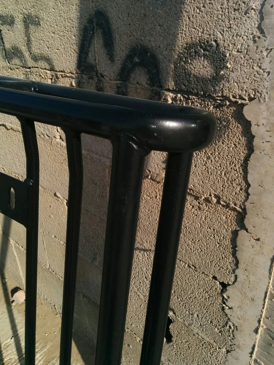

the rack is back on the LC200 : the good thing is that the painter accidentally painted the BajaRack logo and it looks much nicer.

RUST PICS : BEFORE : please observe the BroWN stains on my roof !
And the mounts ! All equally rusted..
AFTER : Sand blasted - galvanized - pics
AFTER : the bake - final powder coats and fixing the rack back on...
