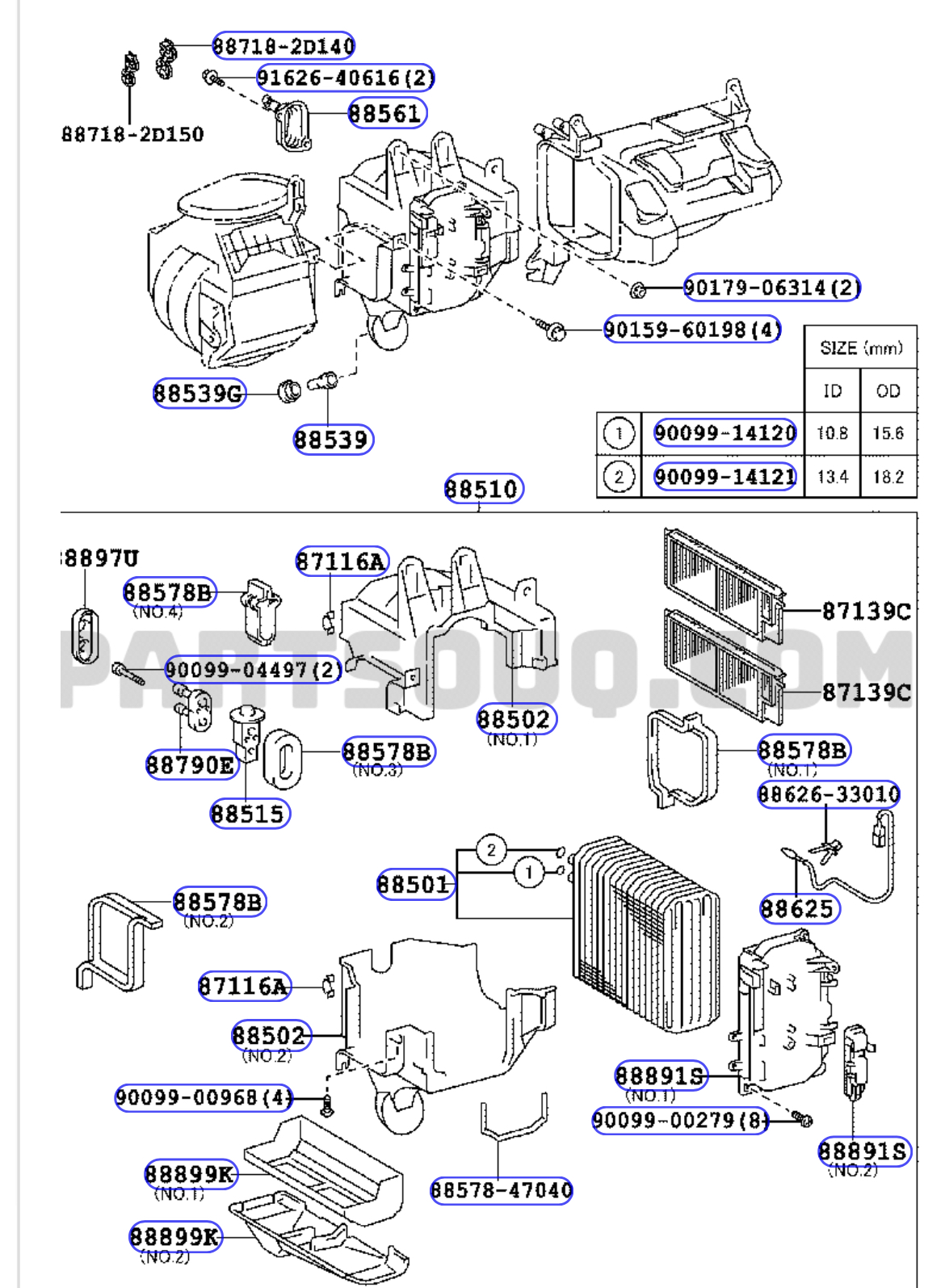

1. Looks like it, yes. Do you have the door/cover?
2. I get Denso on Amazon, 453-1001 for around $13.
3. Out here, absolutely. The desert is a dusty place. I suppose the benefit comes down to how you use the truck.
4. Not really :cheers:
That slot actually holds two identical filters. They lock together sort of to make one big filter. You insert the first one and it should drop down and only be partially visible. The second one then slips into the slot, the upper edge of the lower (first) filter mating with the lower edge of the second filter. You should definitely poke around in that slot with a chopstick or something and loosen up any accumulated crud, then vacuum it out before new filters go in. I slap a piece of masking tape on my “door” and write the date the new ones are installed.

TYC 800099P2 Lexus Replacement Cabin Air Filter​
Every time I get back from Death Valley, or anywhere in the desert, the 1st thing I do is change the filters. My Land Cruiser didn't come with them from the factory so I did the retrofit. It has been worth every minute of the 10 minutes it took to do it.

I have a JDM 2002 UZJ100, and my cover / cabin is flipped. But, I figured the filters would fit the same, as there was a part on a fiche to source.
But, once I pulled off the cover, the depth on the a/c evap coil, is no where near as deep as the USDM enclosure / coil. My coil is about two inches shallower…
So no filters for me. Unless I just stuff some foam in there.

Not sure where you got stuck, I'm assuming with replacing that cover with one that has an opening for the air filter. Potentially you could cut a hole in that cover where the slot appears to be and get some air filters to put in there, maybe even a door to cover it up. Looks like some possibilities though so I wouldn't give up. The air quality upgrade is possibly worth it imho.
