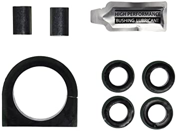

In your PDF @Ayune you mention using the Toyota "Large Rubber Bushing" (45517-60010) as shown below, or to use the Whiteline W13210 kit that a number of Mudders have used (also shown below).
Quick question: It looks like the Toyota part is a single bushing vs. the Whiteline which contains the large D-style bushing plus four grommets - what are these used for/are they necessary if I purchased the Toyota rubber bushing? Thanks.

It looks like they sit around the bolts holding the D-style bushing in this post.
Correct, the smaller Whiteline bushings can replace the two rubber bushings that come pre-installed in the new rack. From what I’ve read they could be a PITA to remove, plus I was on a tight timeline, so I did not exchange them. The Whiteline bushings are two-piece so they should install pretty easy.
