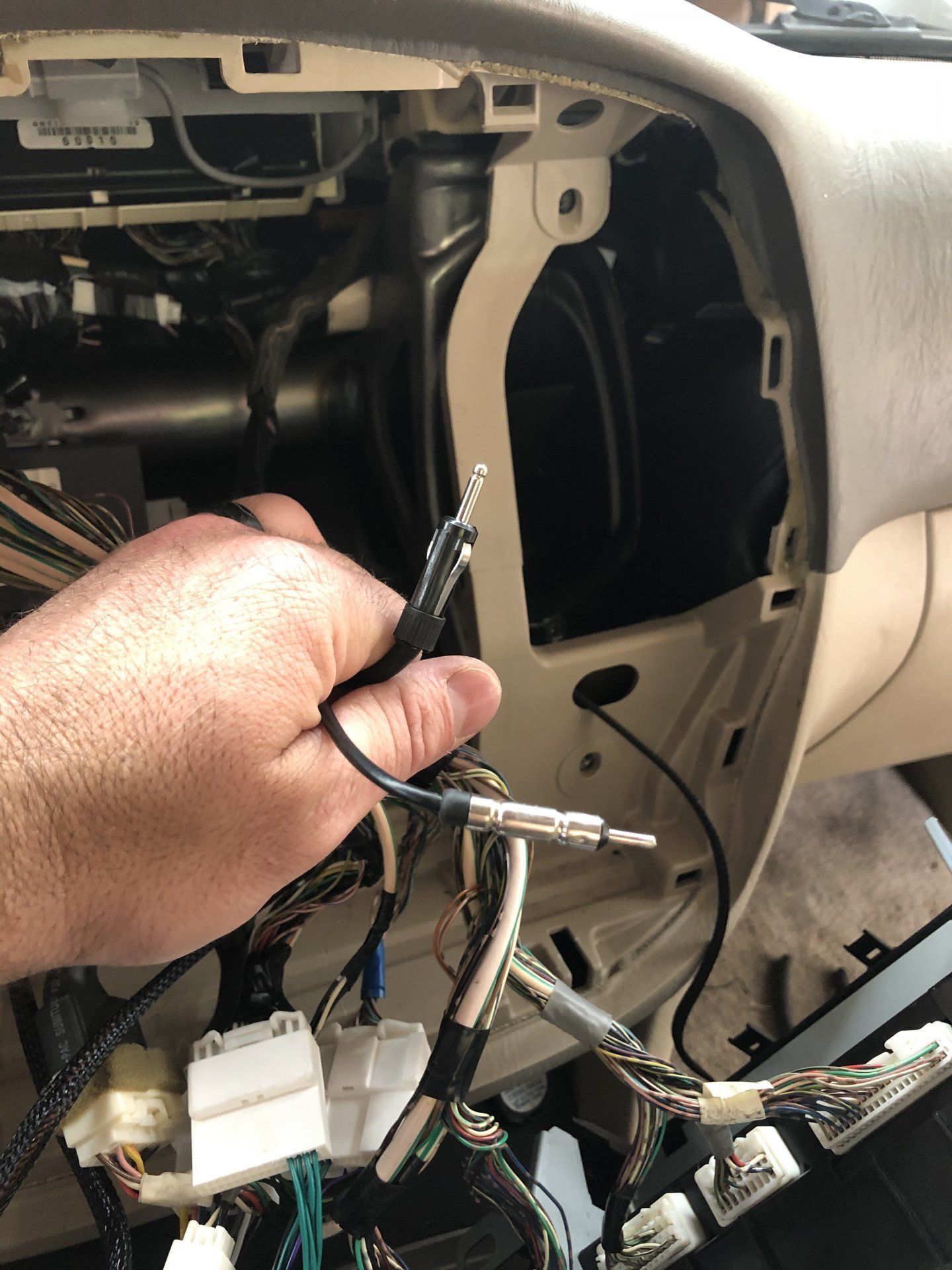

Are these supposed to plug into anything?? My air works but I am getting no sound at all.
Ordered my radio from rhino and agree that their customer service is absolute garbage. I’m hopeful that it get a solid unit when ever it arrives 😒
One of those is the antenna... Looks like the lower one.
Some folks had the no sound issue and they fixed it by connecting the old radio and turning up the volume.
Also I have nothing to plug into these line out rca jacks. My stock harness had no rca connections.
You don't need to do anything with those unless you have after market amps.
