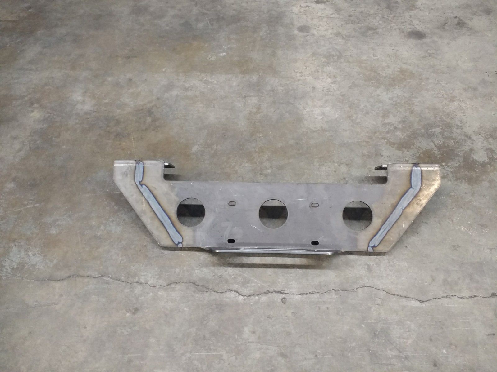

Jason at Trail Taylor's hidden front winch mount for the 200's. Depending on pricing this may fill the need until I can order the full front bumper. Quality looking unit :cheers:
