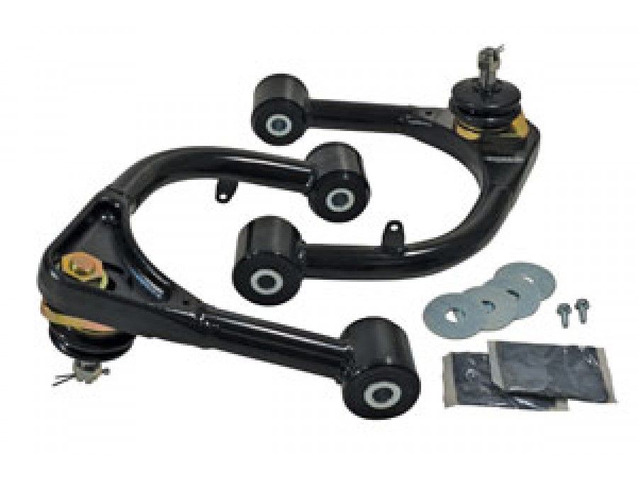

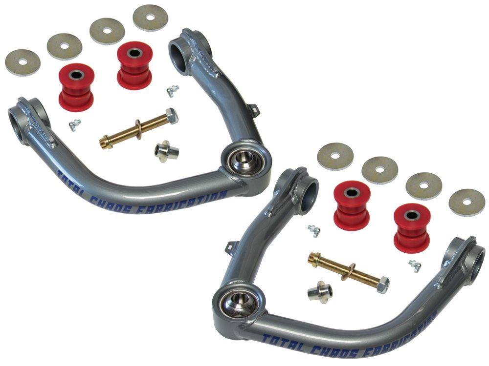

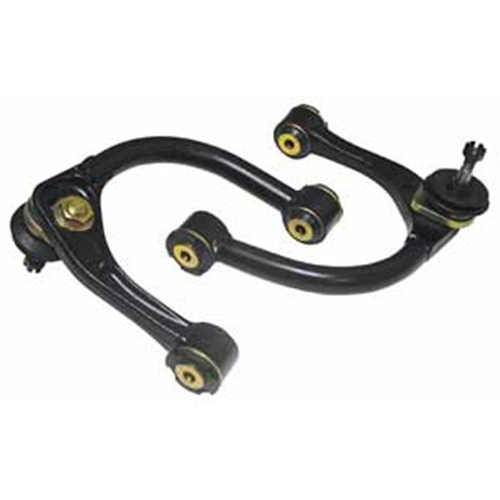

On the UCA's I spoke to Jason at Trail Taylor and when I asked about the SPC's he only said he had some issues with them on customer rigs and his own 100 Series didn't really elaborate other than he liked the Total Chaos more. Honestly I looked at the Total Chaos and they remind of the All Pro design I had on my Tacoma they were nice but the design didn't cap the spherical joint so with dirt, water and other road grime collecting on it I didn't really care for the design. I'm leaning toward the light racing but haven't made up my mind I'd rather not go UCA's on this one if I can help it but if I can't get the tire footprint to run flat I'm gonna have to order a set. I saw your SPC UCA's they seem like the way to go I really like their design, I hope yours go smoothly bud :cheers:
Light Racing (looks a hell of a lot like the SPC design)
SPC
Total Chaos (looks a hell of a lot like the AllPro design)

On the UCA's I spoke to Jason at Trail Taylor and when I asked about the SPC's he only said he had some issues with them on customer rigs and his own 100 Series didn't really elaborate other than he liked the Total Chaos more. Honestly I looked at the Total Chaos and they remind of the All Pro design I had on my Tacoma they were nice but the design didn't cap the spherical joint so with dirt, water and other road grime collecting their I didn't really care for the design. I'm leaning toward the light racing but haven't made up my mind I'd rather not go UCA's on this one if I can help it but if I can't get the tire footprint to run flat I'm gonna have to order a set. I saw your SPC UCA's they seem like the way to go I really like their design, I hope yours go smoothly bud :cheers:
First off sweet two hundy amigo!! And yeah those Light UCAs look a whole lot like the SPCs.
I have been pleased with the SPCs that I'm running on my LX470. Have about 64k miles (90% pavement and 10% gravel/dirt) on them so far and they have been quiet. I read where the ball joints were a problem with earlier orders from them on the 100 UCAs, but believe that they upgraded the joints to a larger and greasable unit that can be changed out easily if necessary, unlike OEM. Talk to @wct49 as he sells them and may have feedback from others who have been running them long term.

Agree PK, I noticed ICON started capping theirs in their 2nd design, also Dobinsons does as well.
Thanks and I certainly appreciate the feedback. I really like the SPC design hopefully they worked out the bugs with a greasable and easily replaceable joint and a notched adjustment plate or some sort of lock to keep the adjustment plate from walking would be my concerns. I'm not planning to do any hardcore stuff with it but will be using it off pavement plenty with some overland trips.
