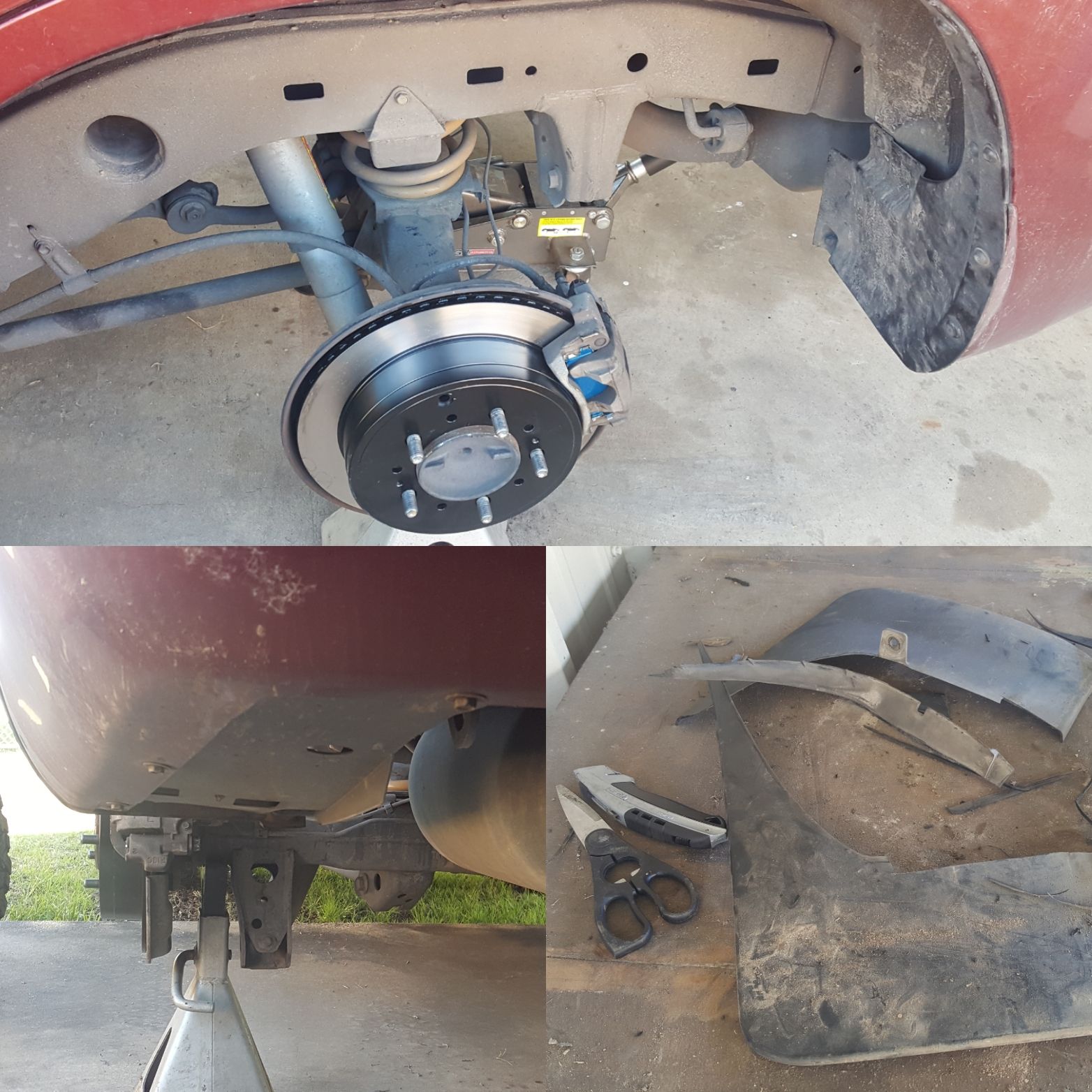

Back to back brake jobs on the rear :mad: 3 weeks ago I had O'reilly turn the rotors (did a piss poor job of it) and put the trusty Wager pads on it. On the test drive to break them in I could tell the rotors were not true with vibration in the pedal. I ordered some Wagner rotors and dove back into it this weekend. I went back to O'reilly gave them the old rotors and pads they ruined of which they credited me for turning the rotors and gave me a new set of pads. The rear is good to go now but I still plan to go back and replace the TRD pads I put in the front and replace them with the the wagner as well. Thats the first bit of advice I got in the 200 forum I disagree with and wish I would have just stayed with the wagner pads I've been using the last 15 years without issue. I took the rear mud flaps off while at it and trimmed the flap away and kept the inner fender portions. Funny how such a small change gives it a different look. Will do the front as well when I dive back into the front brakes. Hope you ALL had good weekends :cheers:
I like to rip the mud flaps off on a trail lol
They may crack or tear but they are attached pretty good with clips and a few bolts but that sounds like good challenge to go try :D. Post up the pics of your build as you make the changes you are going with a different suspension, wheel and sliders so it'll be good feedback for the others :cheers: that color and wheel combo look awesome.

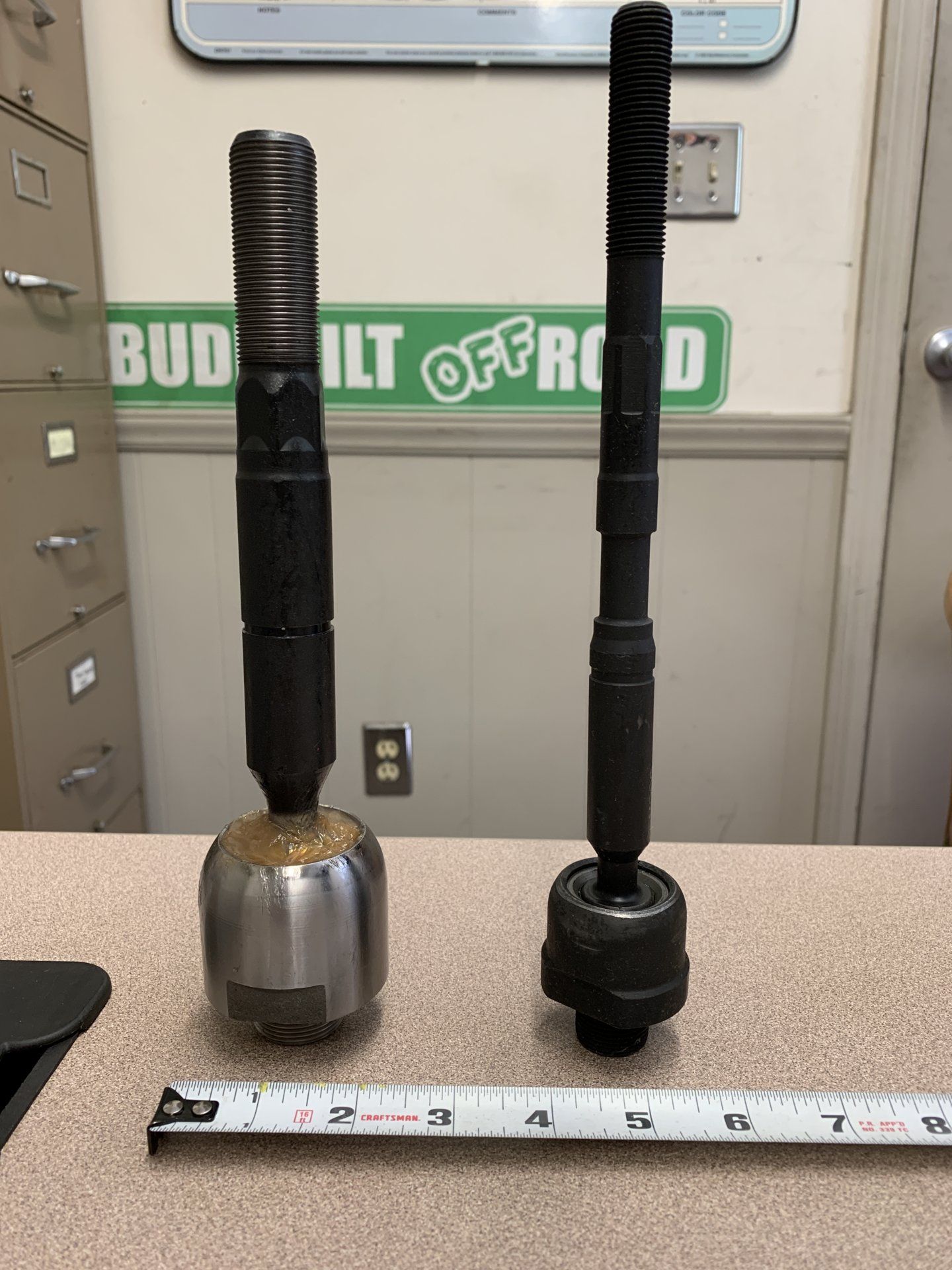

Your Iron Man kit? the shocks are stout but as you lay under the 200 you'll notice it looks like it has 3/4 ton truck parts under there. Here is an inner tie rod posted yesterday in comparison to the Taco/4R/FJ inner tie rod.

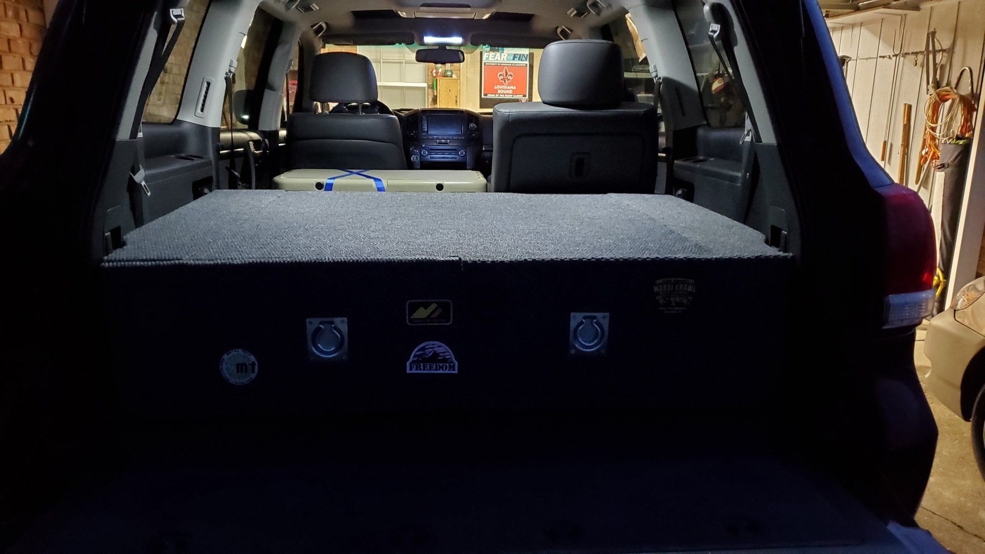

I needed my drawers finished for the Big Bend trip that got cancelled and turned into the Corona Escape trip I took with Scott. Here is the finished product of the drawers modeled after KISS drawer system using 8020 aluminum frame, skinned with furniture ply that Jude helped me with and covered in some outdoor rug carpet from lowes. The right drawer has a divider in the middle, the left is one big drawer for longer items as needed. With the 8020 it gives me the flexibility to reconfigure as needs require. I'm very please with the way it came out. I have lots of time in it when you do a one off build by looking at some pictures its to be expected. KISS just released his drawer wings for the 200 and a cutting board option if I did it again I'd probably just order his kit.
Very nice! I like your roof mounted water tank. With the black color it should be well heated by solar rays. How much does it hold?

Thanks the water tanks came out great and will come in handy on future trips. We made a pair of them for the trip. Mine will hold 5 gallons and Scott's holds a little more than that 6/7 gallons. Unfortunately the cool temps in Arkansas and being under the canopy a lot of the time the temps never warmed up the water much so I sucked it up and danced to a cold shower, LOL. Scott heated his water on the stove to warm the temps and said it worked well.
