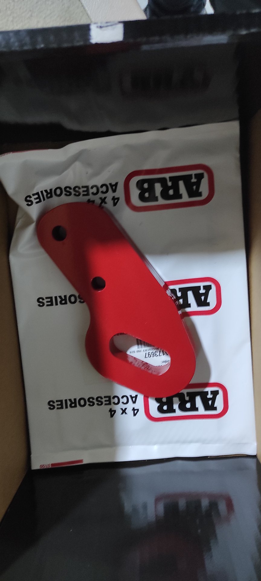

Hi All,
planning to install ARB protection.
I saw two options for front recovery points by ARB both with the same serial #: 2815020
any recomendations?
many thanks,
Aifer.
I have this one. I don't know for other item/number. For LC200 only this one...
Soft shackle destroyers. So many people use soft shackles these days. Take a burr grinder and give them a rounded edge and refinish. I'm surprised ARB hasn't changed the design to put a radius on the edges, or if they don't because it would cause them to have to go through retesting/re-rating with the various agencies and certification bodies...

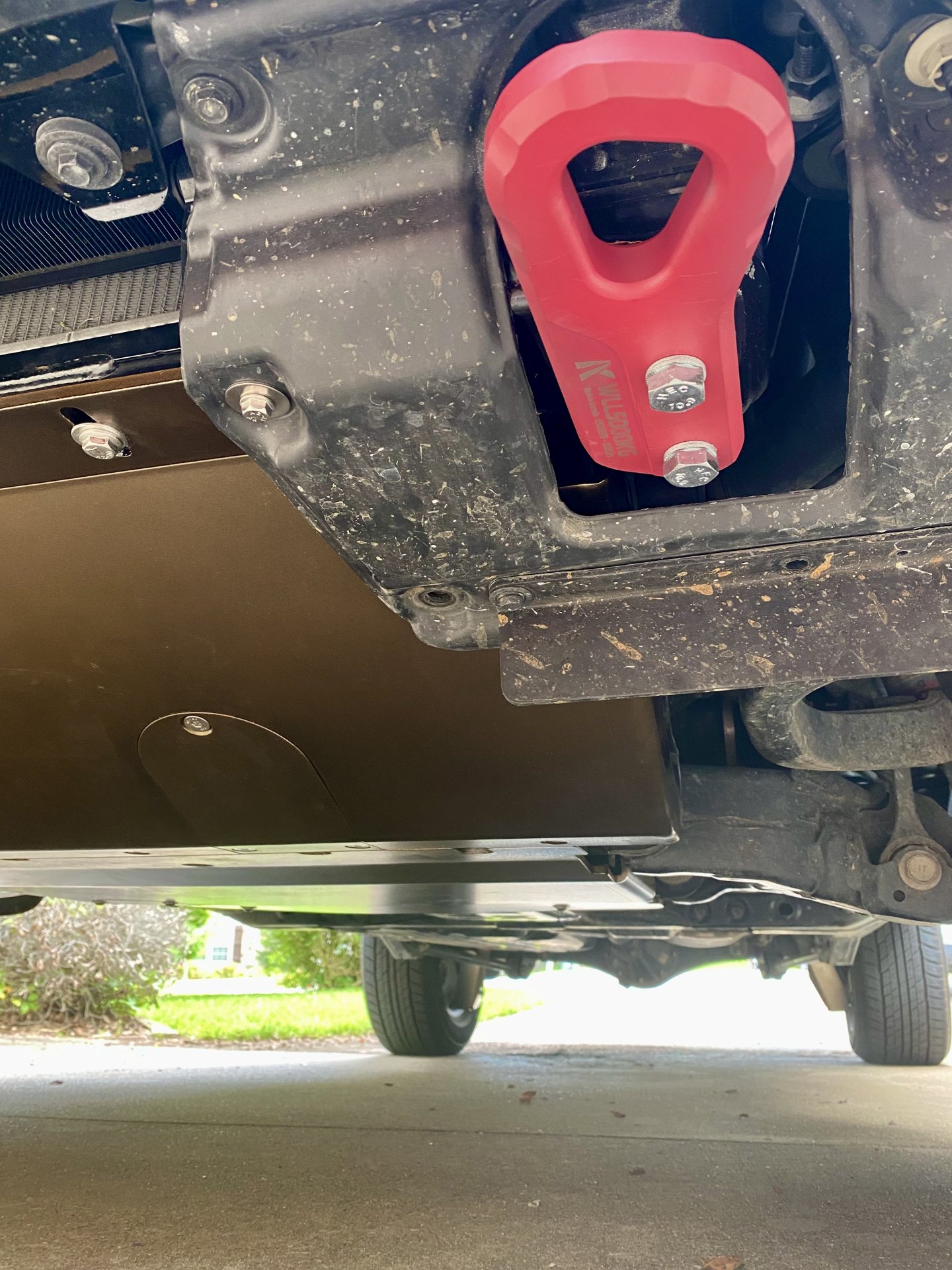

I still have the factory recovery points. I just removed the tie down from the bottom (which unbolts easily enough). Why spend the $ on ARB recovery points, exactly?
Don't act like you haven't seen how cool my truck looks with those recovery points.
I mean, isn't they we do all the mods we do? ;-)
If i do anything, ill just rattle can my factory mounts red....it will look 90% as good that way and if i ever have to use them there will be red paint marks on everything i attach to them (Double bonus!)

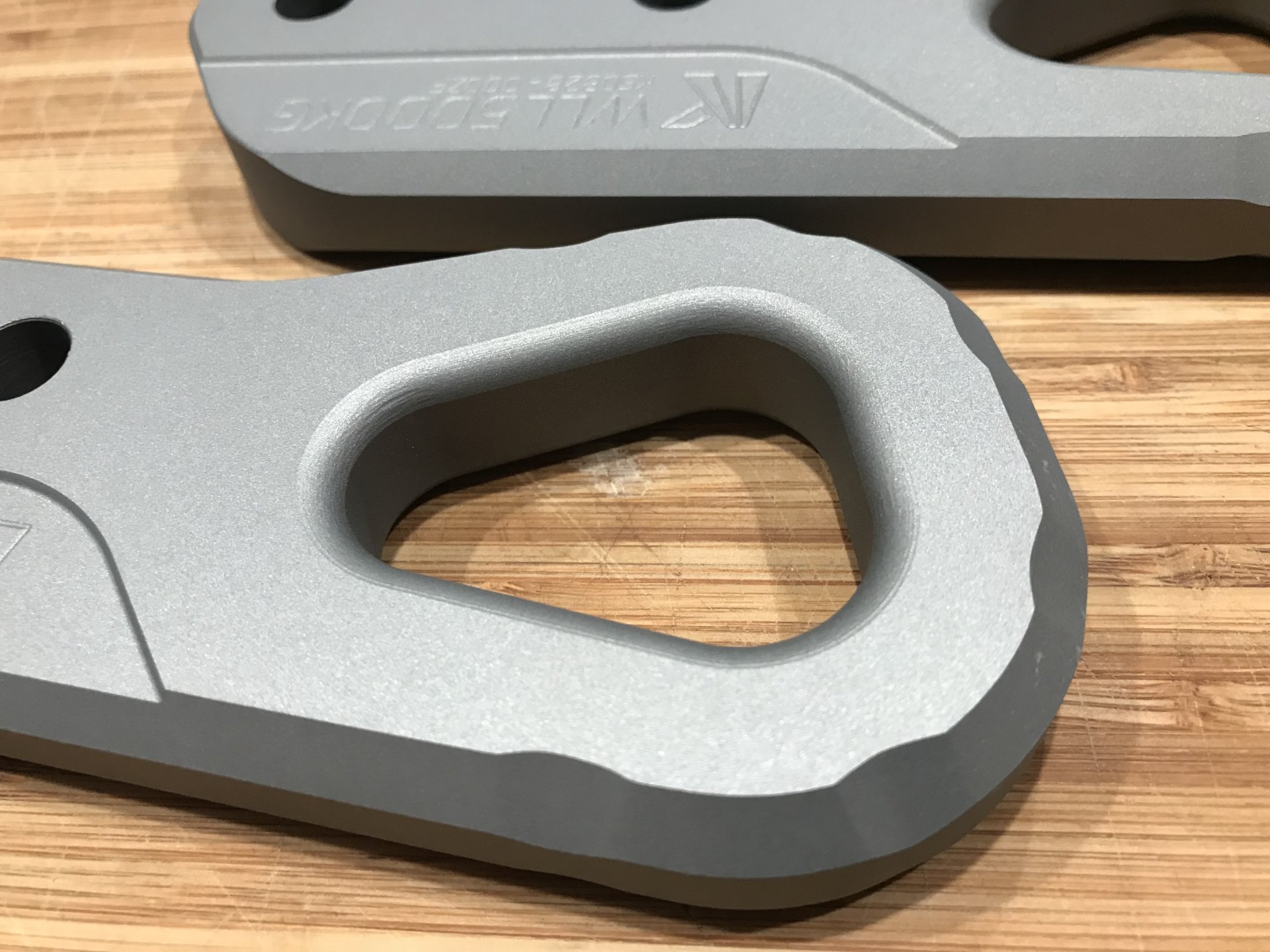

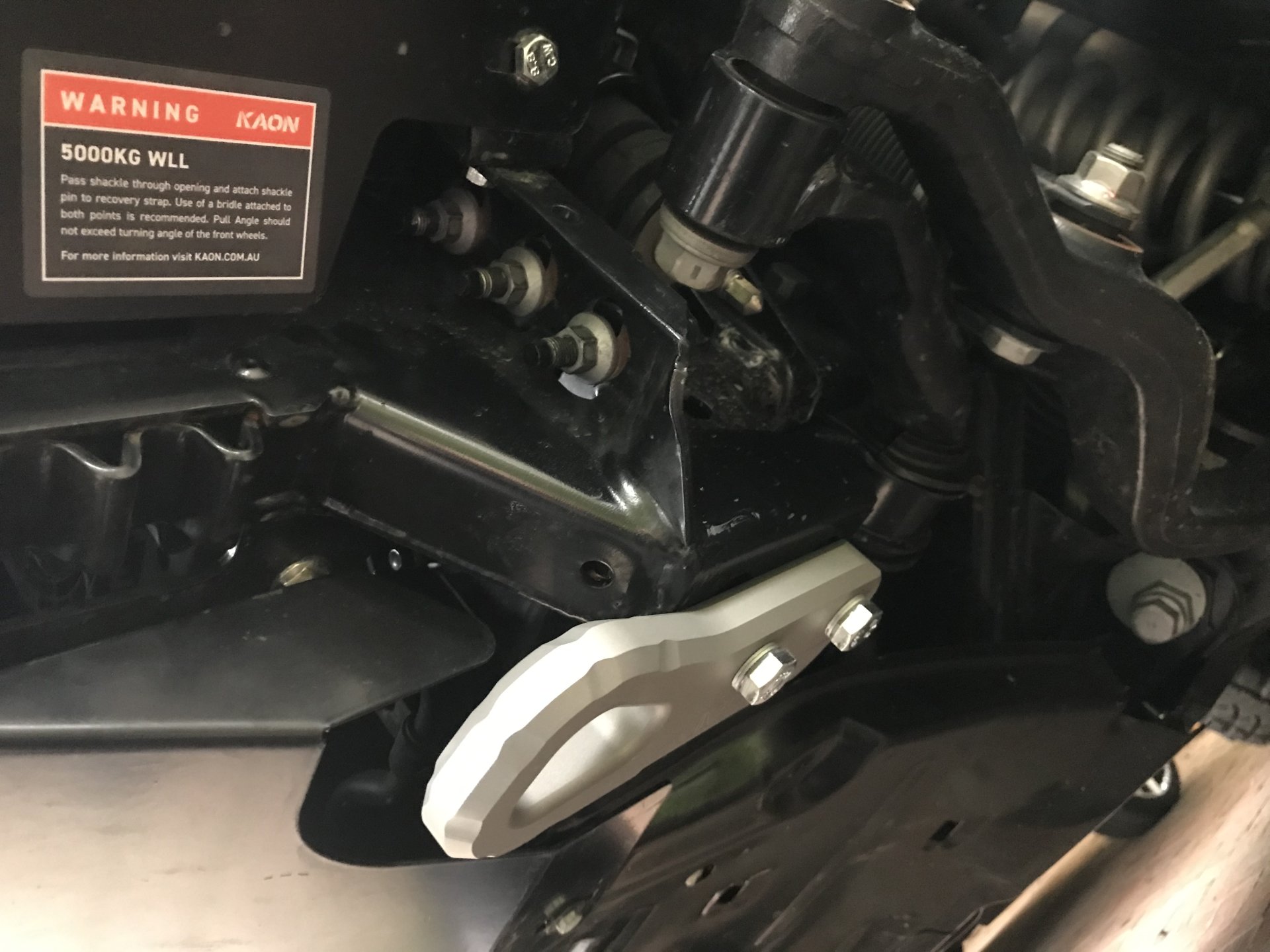

Kaon make a similar recovery with 'softer' corners. That said even if a pure 180 deg edge curve, it's too sharp an angle for a soft shackle. These kind of fibers have decades of experience on ocean racing boats, tight bends will reduce the breaking strength and life in half or more.
Cost an arm and a leg but very nice
