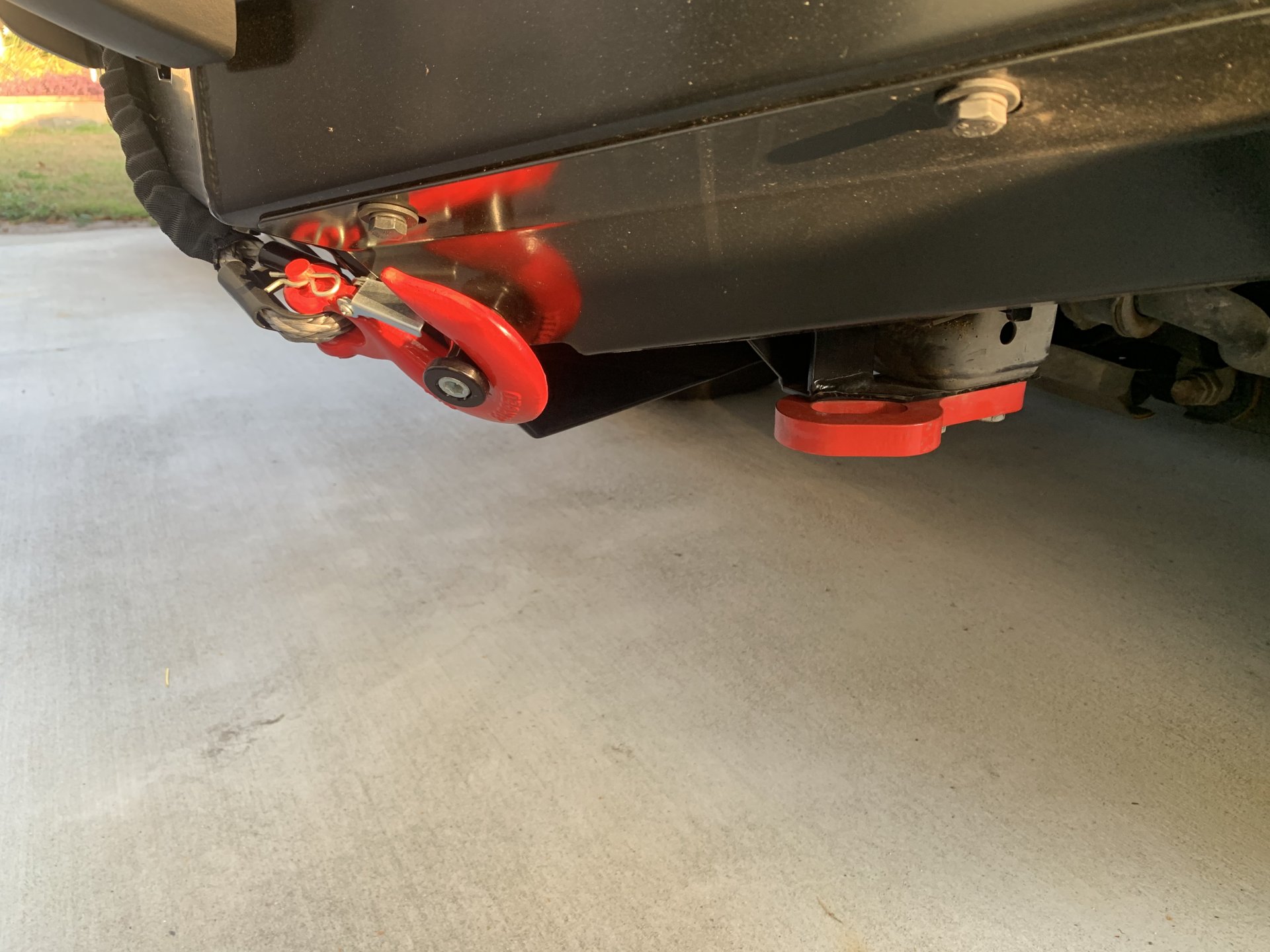

IIRC the bolts had Toyota graded markings on them and should be sufficiently strong, and they fit snugly in the remaining recovery point. I suppose I could throw a steel plate between them as a washer but on the whole it seems stronger to me than a 9500# D-ring.
My TrailTailor bumper has recovery points on it so I could just use them. They’re attached with 4 bolts per side to the frame horn. I feel like the factory recovery points are better suited for high forces though
Looking at the stock points the bolts wouldn’t be my concern, due to them probably being made of much, much higher grade steel than the hook itself. But pulling those bolts out of the base plate is my concern. When they are tightened down they clamp a relatively small amount of steel to the frame.
The L shaped bracket being such thick steel means much more of the base plate is clamped to the frame, which will distribute the forces more evenly. Basically you’d have to rip the sides of the base away, vs just turning the holes in the base into a big slot.
The downward hanging portion of the tie-down with the large hole in it isn’t necessary.. could be cut off if you wanted to clean things up. But I believe having the tow hook clamped between the frame and the horizontal part helps the strength of the system significantly.
The Arb ones seem beefy and aren’t too expensive.

Pictures in some other threads on this same topic the Tundra ones are about 25 to 30 percent bigger in terms of metal size and the are direct bolt on.
And an analysis by an engineer in the other thread indicate them actually appearing weaker…
But if size is all that matters…
