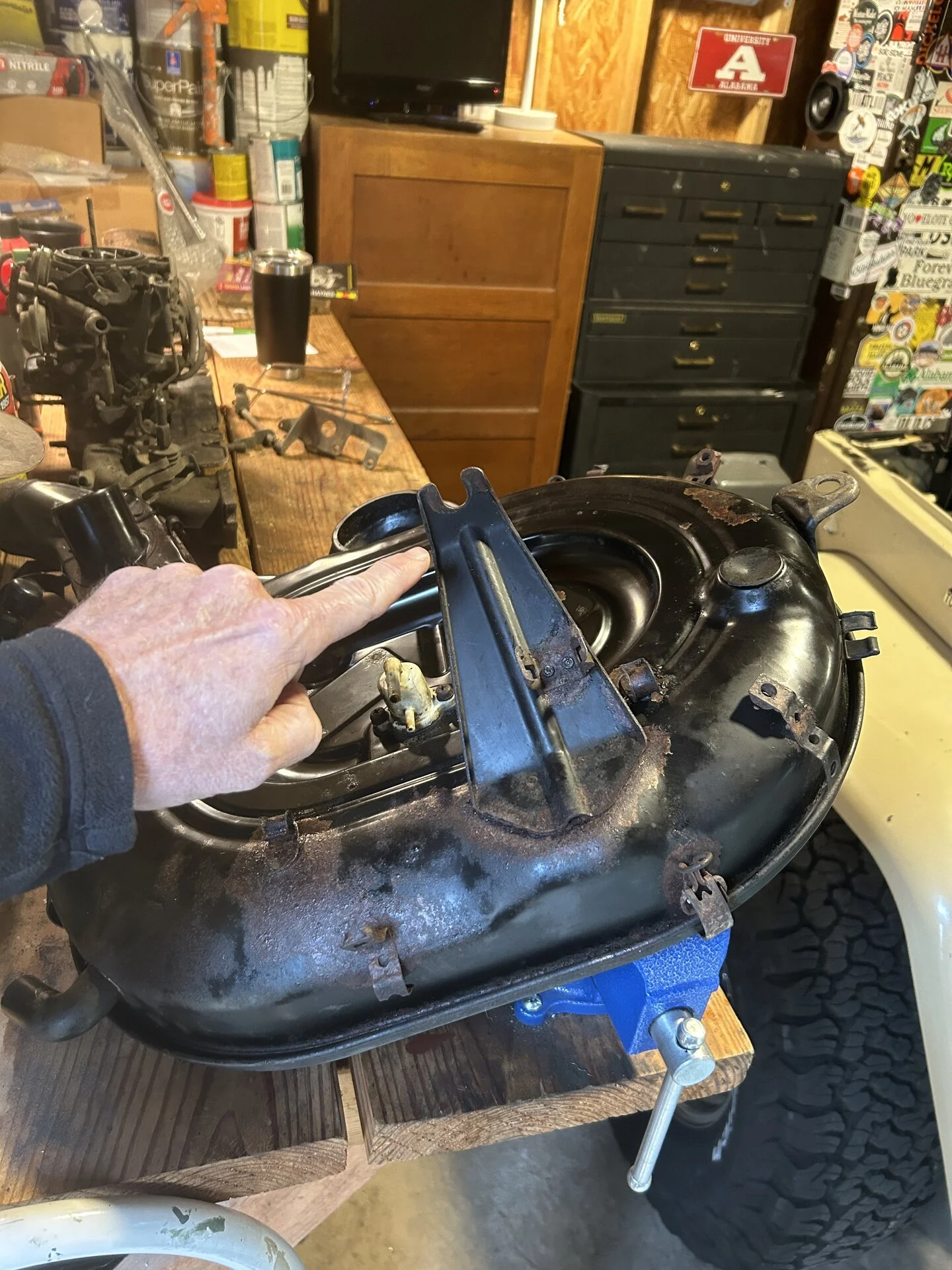

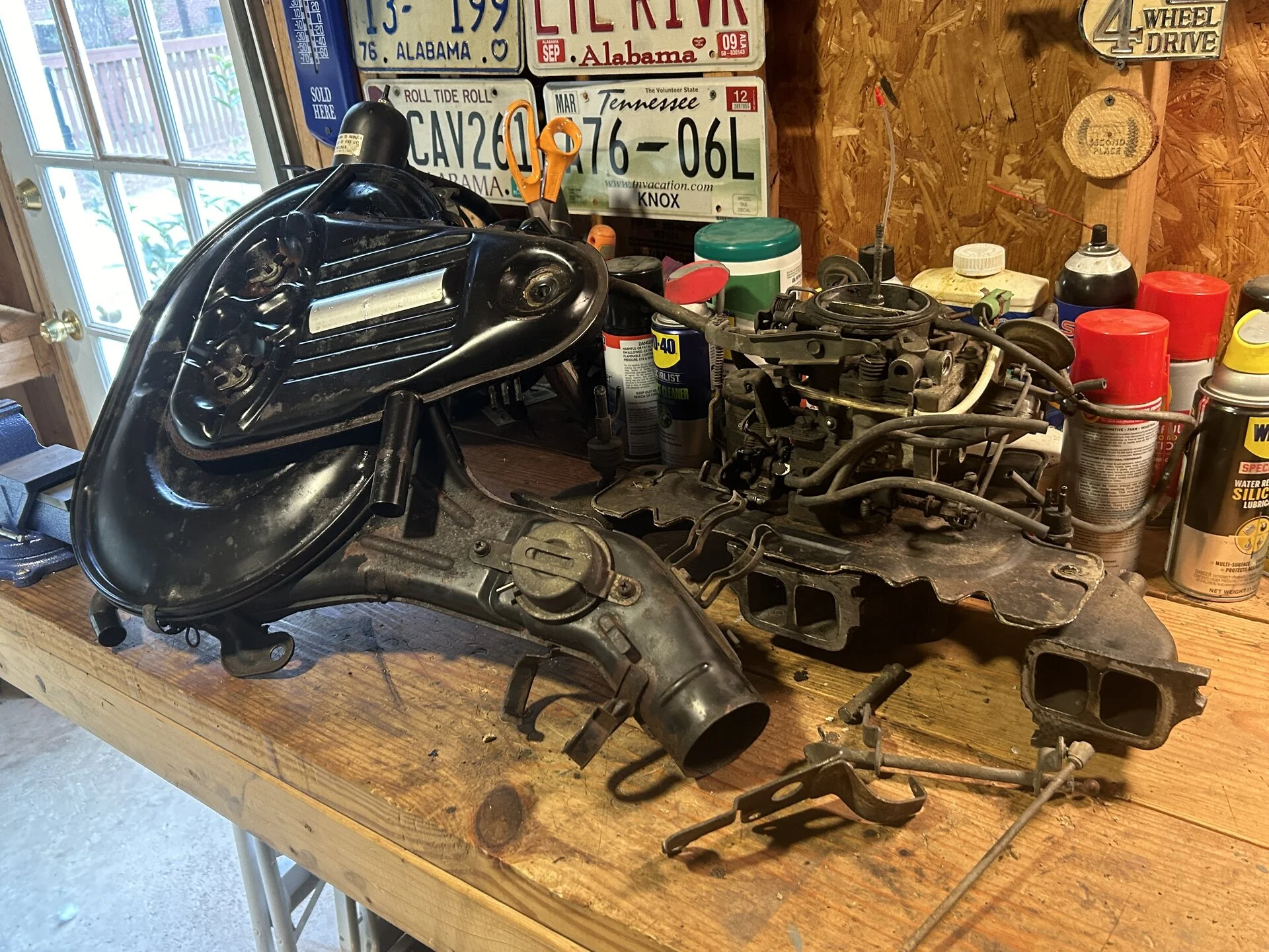

Have sourced a 1984 60 series intake,, carb and air cleaner to take my 82 NA 40 series back to stock. Not so sure that this air cleaner is going to fit or not (or if I am missing a bracket). Search results haven’t helped so far. Trying to figure out how this side bracket mounts to the side of the valve cover/head (passenger side). Would someone mind shooting me a pic of how their air cleaner mounts on that side? Many thanks!

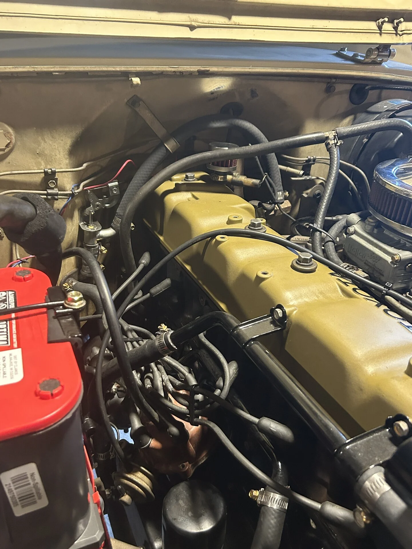

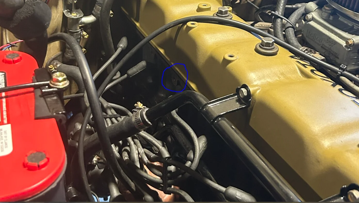

On the 40 that part bolts to the head down by the spark plugs. There is a threaded hole there between the 4th and 5th cylinder. You can see it in your attached photo just below where the valve cover meets the head.
