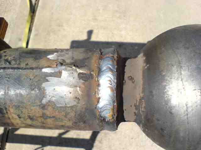

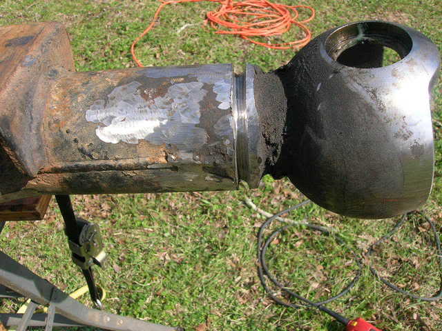

My grooves are a bit larger than some others, but I felt this way I could get plenty of penetration. I figure once I have it welded up and install some knuckle gussets it should be plenty strong.
lookin good man, love to see the progression, and looks like version 3.0 will be the best yet. keep buildin!
just wanted to comment on the groove u put in between the axle and knuckle....
you should of beveled it at a slope and left a gap in the center.... the included angle should be between 60 degrees to 75 degrees... so each side should be beveled 30 to 37.5 degrees...
basically the same way a pressure weld is done with a root pass and then a hot pass then the fill and cap...
just i have done pressure welds and that is the correct procedure for welding pipe...
Got the knuckles welded up this morning. Made a root pass along the inside edge of the groove, then filled the outer edge. Used a friend's 180amp Hobart...made a much better weld than my little 130A.

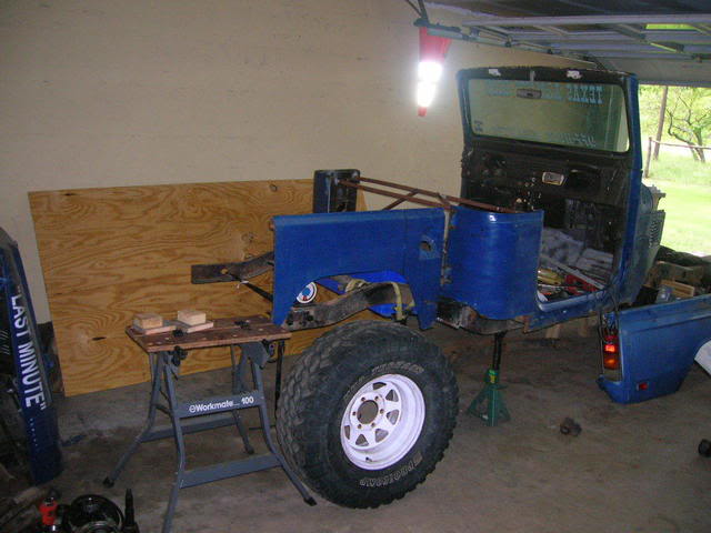

Thanks to some friends who came over sunday we put the body back on the frame. I built some sawhorses to put the frame on, then we set the body down. I'm going to chop the rear and make a pickup cab. Also planning on cleaning up the firewall...will probably have to do a little floorboard work as well.

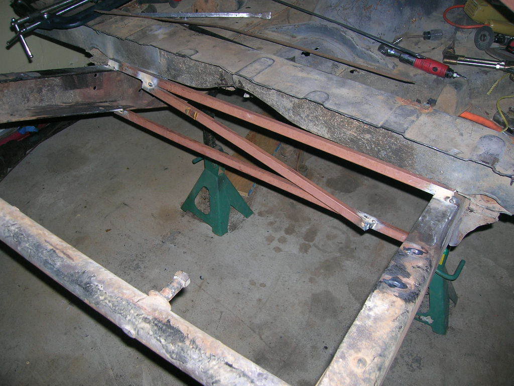

Got the bed cut out tonight. First welded in some braces to keep the body from getting out of whack once I cut the sides. Then cut the bed out...I really gotta get a recipricating saw, it took me 4 4.5" grinder cut-off wheels, 2 die grinder cut-offs, and 1 jig saw blade.:lol:
so....lots of chopping today:D
Turns out the rear of the cruiser is bolted on to the back of the door frame. This made it pretty easy to remove as the only weld I had to remove was at the top rail. This is the plan I had originally...
the idea was to mount the tank directly behind the main beam of the cab then enclose it with the rear of the tub. After mocking up the 105" wheelbase, I found that this would have most likely resulted in the rear of the tub coming into contact with the tire on full stuff...you can see the rear of the tank is already behind the front of the 33" tire (and I'm going w/ 36's). So now what I'll have is the cab will end just behind the seats and the tank will be in the front of the bed.
I did a bunch of measuring on the seats been using, and determined how much cab I needed to be able to clear seats mounted in a similar location. So here it is mocked up.
I still have some cleaning up to do where the rear of the tub meets the door frame, and I'll tack it in place till it's cage time. I'll also need to make a fill panel where the doors were, finish out the floorboard, and make a fill panel to transition the bottom of the rocker panel to meet the bottom of the rear corners.

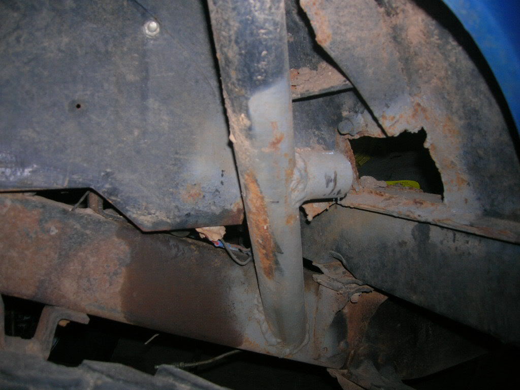

Noticed this while doing some measurements on the frame....gonna have to do a little swiss cheese repair.:(

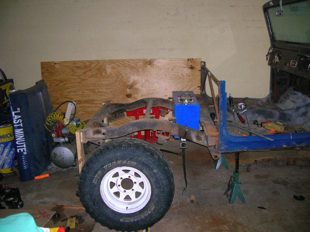

Let the obligatory mock-ups begin...:D
This is the spring at 105" center pin to pin. I used a high tech spring mock-up system to hang the spring in its approximate position.
Here's where the fuel cell will be. I'll have to wait till I get a drivetrain in to see how high it will need to be for driveshaft clearance. I want to keep it as low as possible for COG and so that I can run a regular filler neck on the cell.

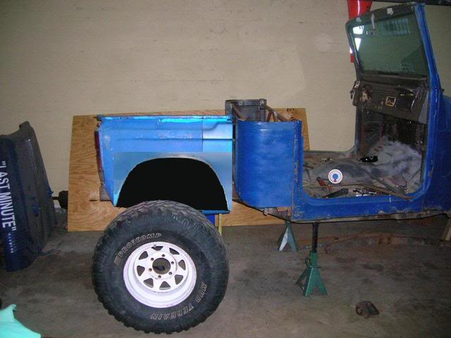

Tacked the two ends of the bed together. My thought was to try without the wheel well first, then if I still want it I can add it in there.
I'm not sure about if the wheel well will look better or not. If I put the wheel well in I'll have to put in a fill panel behind it anyway to cover the frame. I chopped a wheel well onto one of the pics just for grins...
