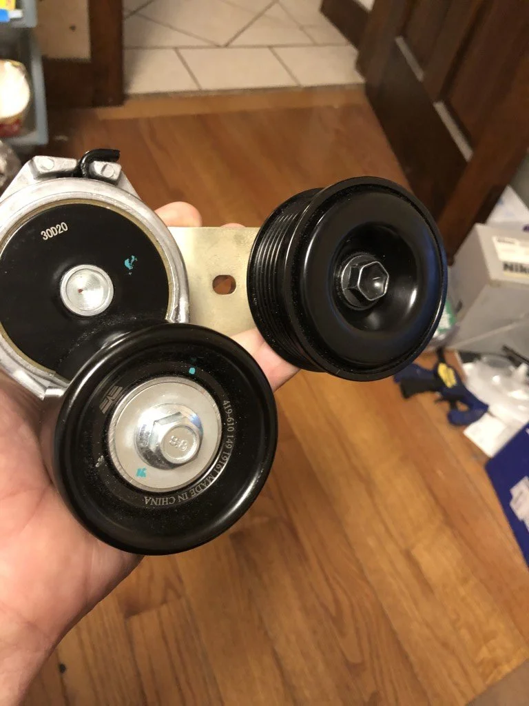

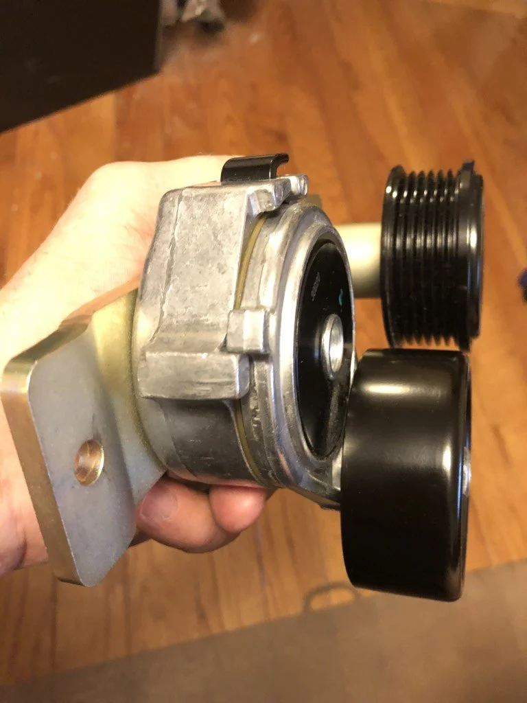

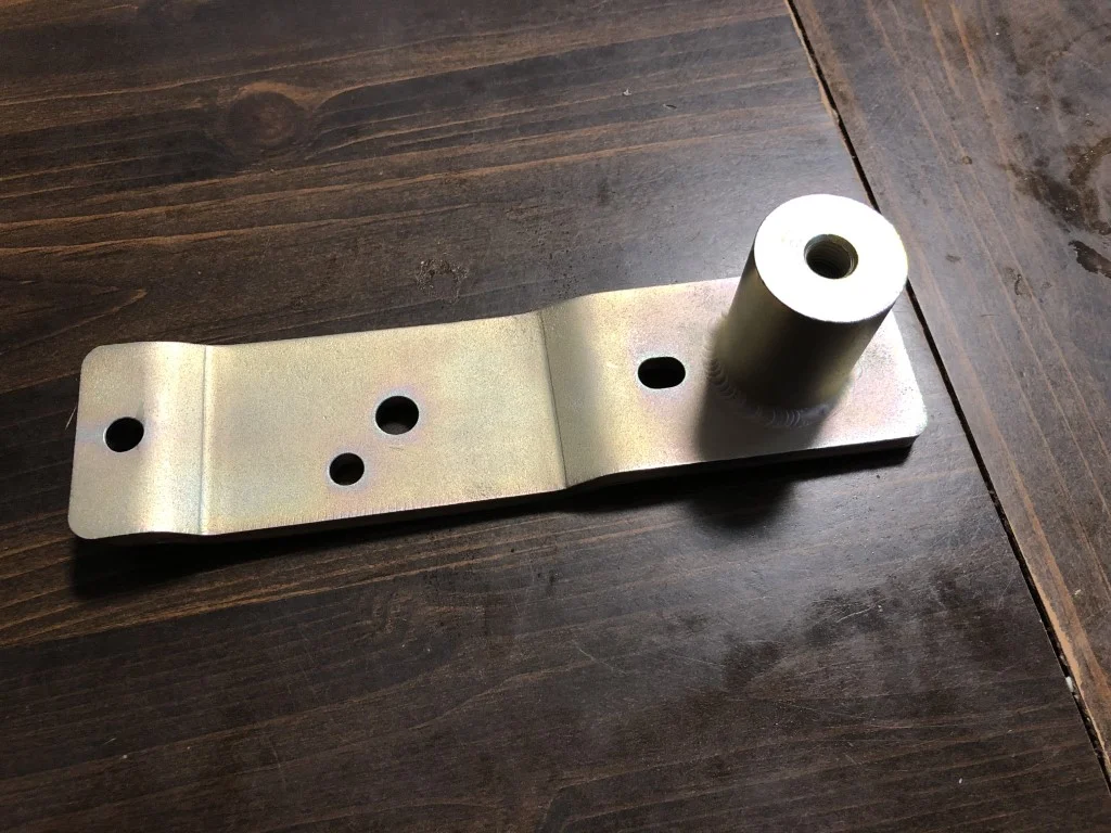

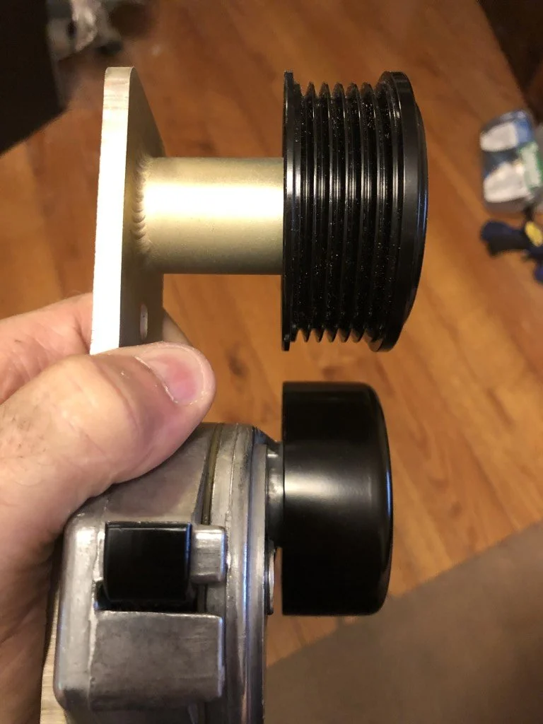

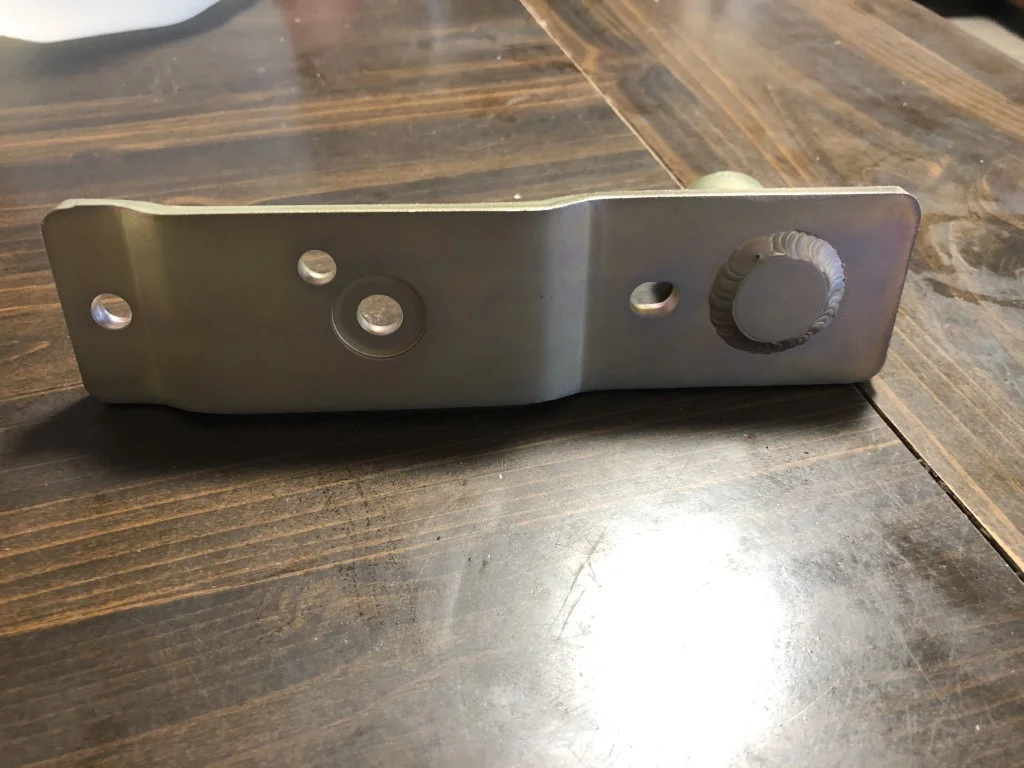

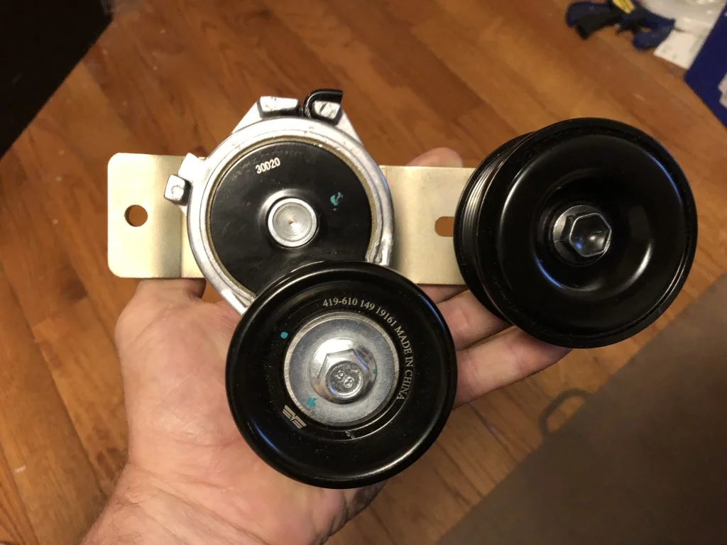

I was hoping to show some progress a month ago but the parts came in made wrong. What I have to show you here is the finished tensioner assembly.
the tensioner used is a sealed unit with a bolt extended out the back and mounts to the bracket with a serrated flange nut.

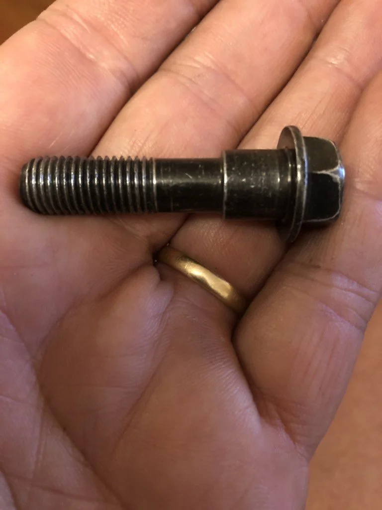

The idler is a machined steel piece with a HD bearing. Upon ordering and receiving the part I realized that it required a shouldered bolt. I figured the best place to start my search for that would be to find the idlers application. To my surprise it was a 2004 GX470. So the bolt and ldler cap are Toyota parts.

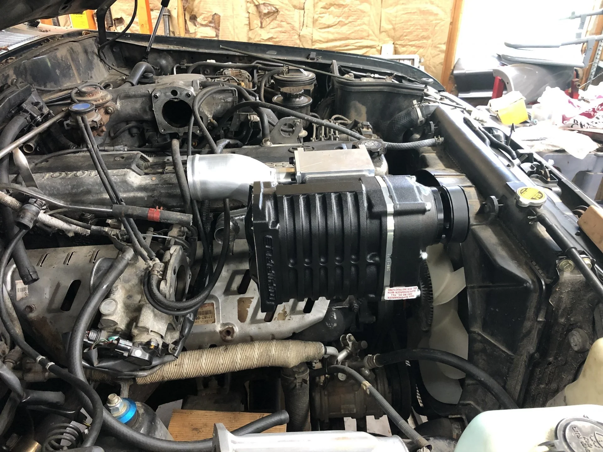

As of right now the compressor mount is undergoing some revisions, the water bypass pipe has been mocked up and at the fabricators as well as the exit pipe that bolts to the compressor mount and directs the air flow to the extension tube on the intake.
Once these are returned tested and confirmed correct I need to design the extension tube, throttle body mount and vacuum pipe for the brake booster.
Now once those items are completed and confirmed correct I will have a whipple blown SC on my truck.

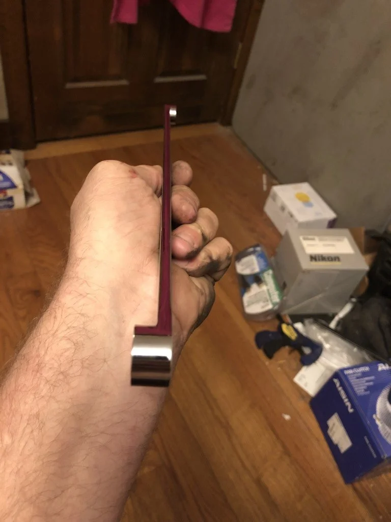

a little update. One of the things I wanted to supply was a tensioner release tool. There really isn't a lot of space to work especially if you are running my orange fan clutch. the blades are really close to the head of the tensioner pulley.
Problem solved, I found a long reach 0 offset box wrench in a 14/15mm size from a company called Capri. I just tried it a moment ago and the 15mm side slides right over the pulley bolt and fits between the pulley and fan blade for easy use. Because my idler post is fixed position this wrench will allow you to change both the idler and tension pulley in place.
This should work equally well on TRD SC but there is no need to have a 14mm end so the cheaper 13/15 mm wrench would do fine.
Ebay pricing at this time is 13/15 - 19.99, 14/15 - 24.99 both free shipping

So I got the mount and discharge pipe back and mounted to the engine. I've already redesigned the discharge pipe and have an order in for 6 units (one is for me).
We've started the process for casting and have met with a pattern shop and will talk with a foundry this week. These meetings will drive any last minute changes to the mount and then an order will be placed.
