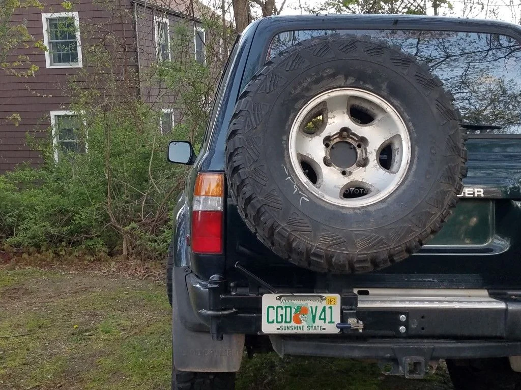

I finally got a beta unit for final evaluation and to work out any kinks in the design, which were a few but small ones.
Nice work Landtank, but I have a question ? Why do you have it on the driver side ?
IMHO, I would prefer it to be on the passenger's side swinging out to the right, for me it make more sense as it is the driver, 99% of the time, that needs to access the rear for whatever, recovery gear, food, beer, dogs, etc. Also if you were to get something from the rear, in case of an emergency, that open tire carrier would be an obstacle you have to go around and perhaps a hazard if you do a quick move. It seems that one of the disadvantages, if many exist, would be the line of sight of passenger's side view mirror with the 35" bulging a bit beyond the body of the vehicle wouldn't give you good vision on that blind area. Anyway, keep up the good work.
the reason for me to have it on the drivers side is for ease of access when parked on the side of the road. If you are parallel parked with someone behind you and you open the swing out on the right side of the truck you are blocking access to the curb.
I am considering making a cooler swing out for the right side which would also restrict access but not as much as a tire carrier would.

so time for another update.
Drove out to Cruise Moab with the carrier on and ran a bunch of trails. I didn't have my high lift mounted as it needs to be serviced and I'd rather not have it than be tempted to use it in it's current condition.
Overall performance was great but a few things did show up.
The major one is that the position of the CB tab is not usable or at least easilly used. I've redesigned the index plat and the new location will be on the lower fixed arm instead of the swing out. This actually works well as the cabling doesn't have to travel with the arm causing posible problems.
The rubber bumper was too soft and I've already sourced a replacement.
Realizing the benefit of the cabling being on the fixed arm I'm going to move the license plate light to the fixed arm as well.

It might add an ounce of weight, but what about extending the back plate to utilize/cover all four pintle mount bolt holes.
If someone wanted to drill out the remaining two holes, from the plate, you would have a flat mounting surface for the pintle hook area.
Just a thought. Otherwise it looks awesome.
I didnt utilize all 4 pintle holes because i wanted to leave the other side open for a possible right side swingout. That plate is 3/8" thick and a simple drilled plate could be used to shim out the other side if you wanted to use a pintle.
If its something people would want i can put together a kit.
