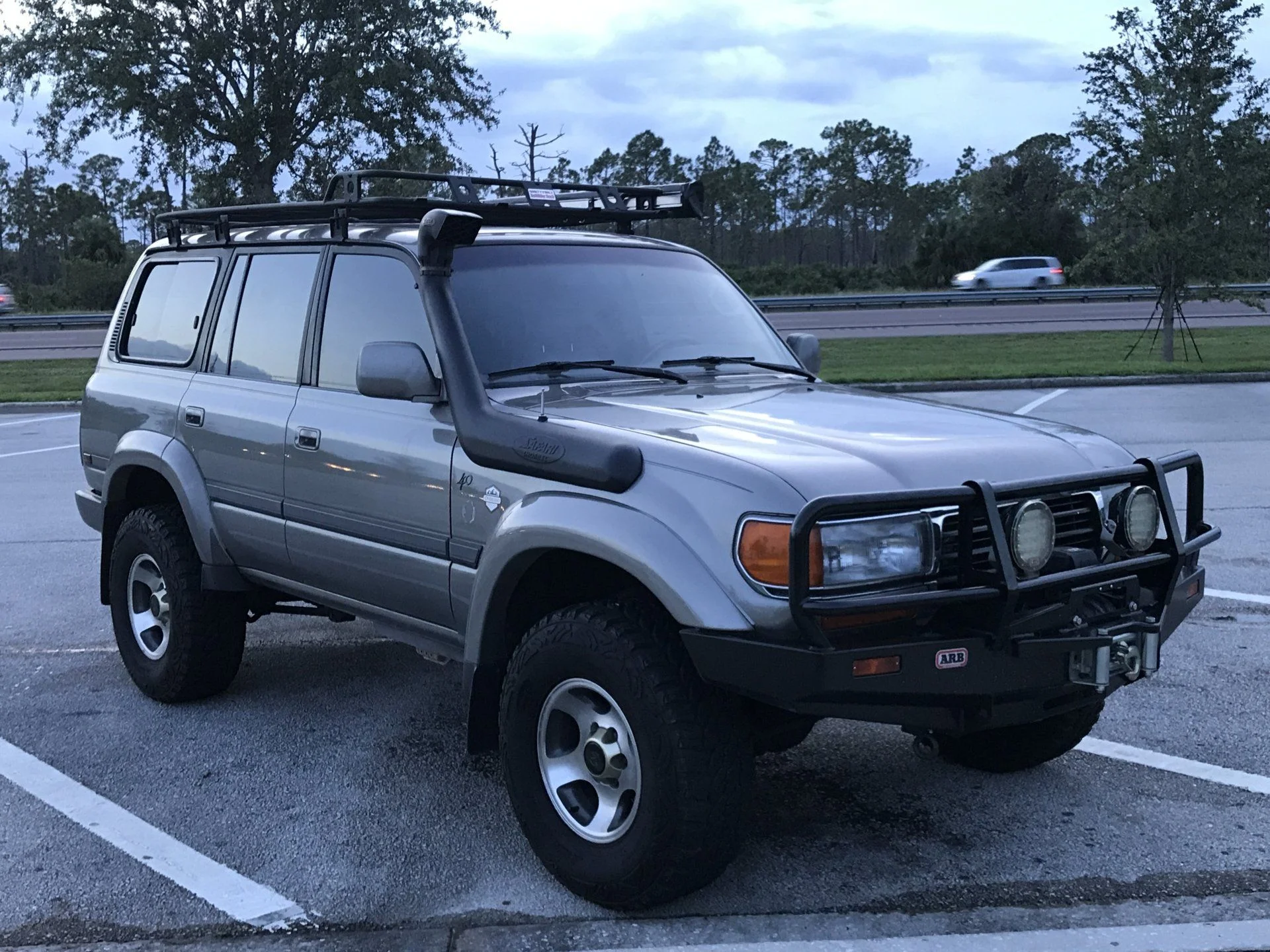

Here are the specs of the current rig:
1997 40th Anniversary
298,000 on the clock
unlocked
ARB Bullbar
7" Led Lights on Bumper
Smittybuilt 12,000 lb winch
Smittybuilt roof rack
Smittybuilt awning
OME Suspension
Procomp 285/75/16 MT tires
Safari Snorkel
Double Din Pioneer HU with sub and 2 amps
Aluminum radiator

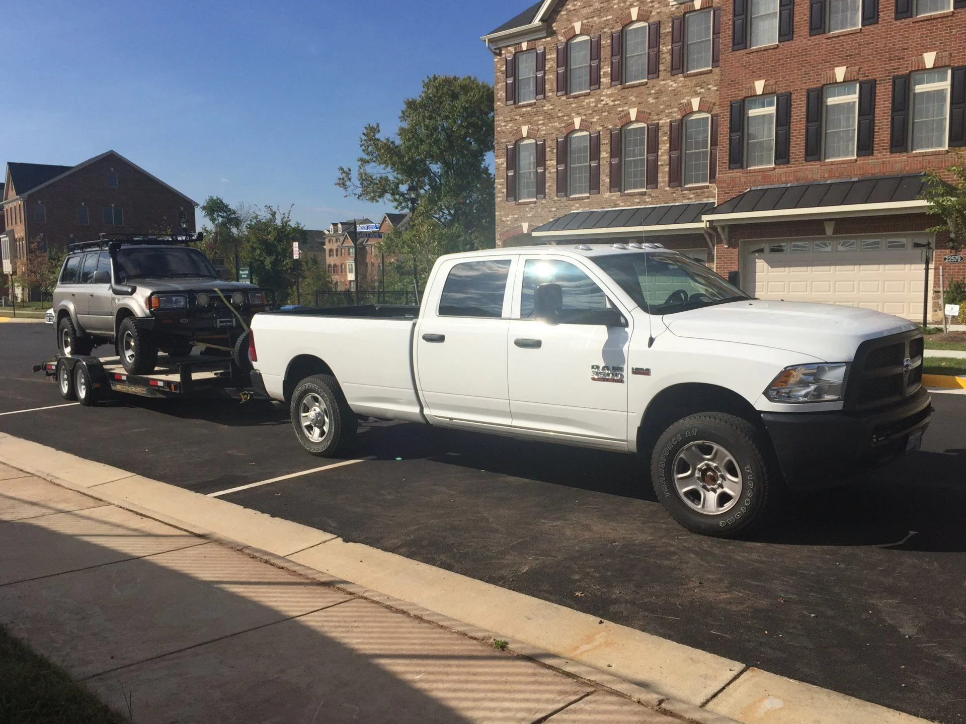

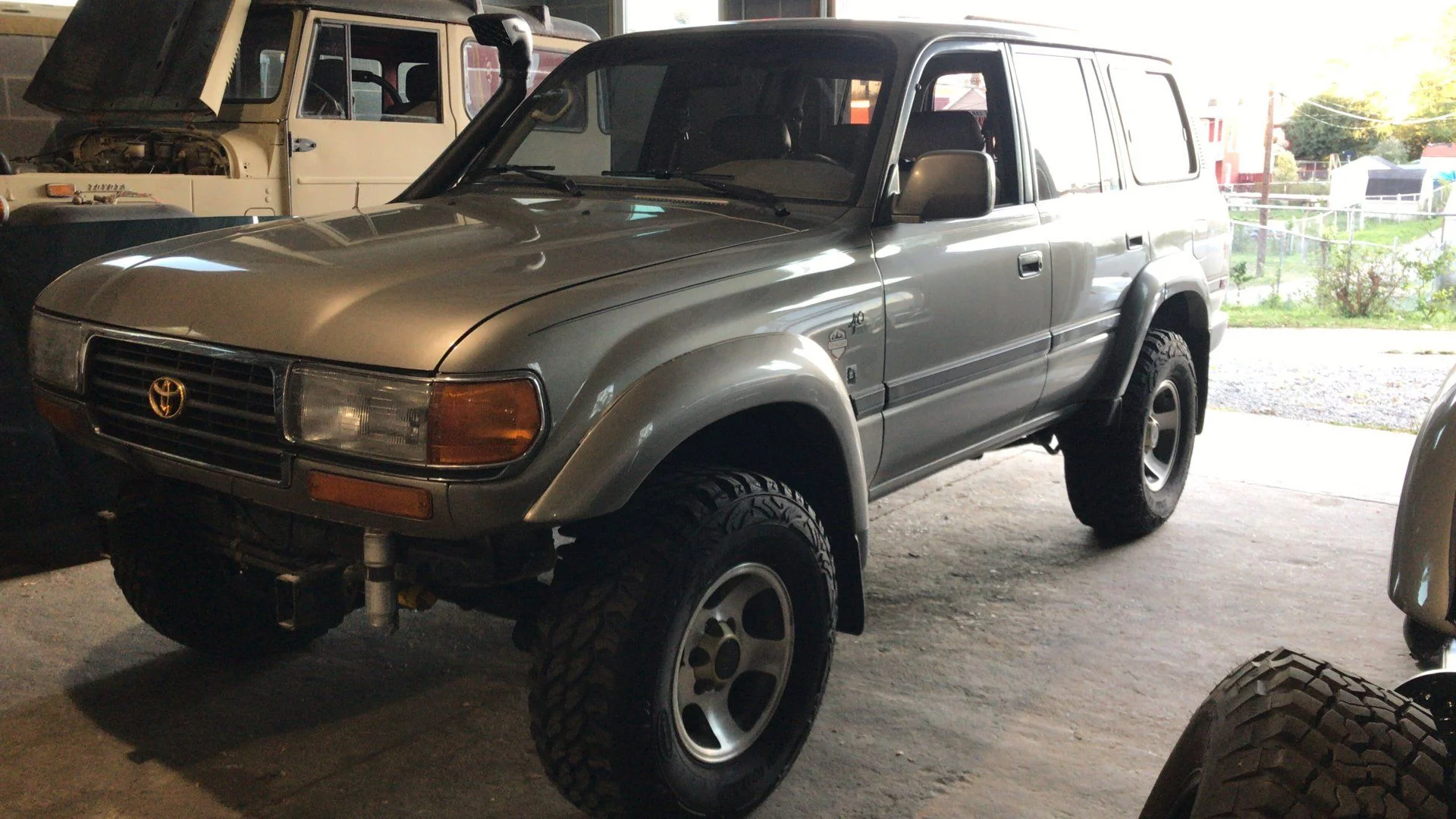

Flew down to Miami from DC after not even being back from an LCH trip to the mother land (Colombia). Met up with my customer and went and looked at the truck. The 80 was what we were expecting with a few unexpected surprises but we were ready. I then proceeded to take it on a 1000 Mile test drive from Miami to DC. She didnt skip a beat. Made it home safely with my family in tow. The next day took her up to the shop to her final resting spot for the next few months.

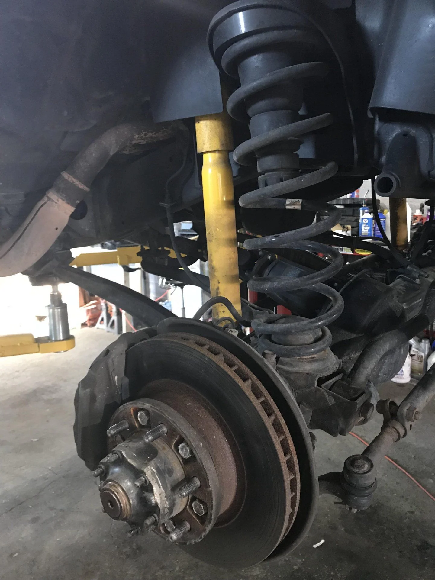

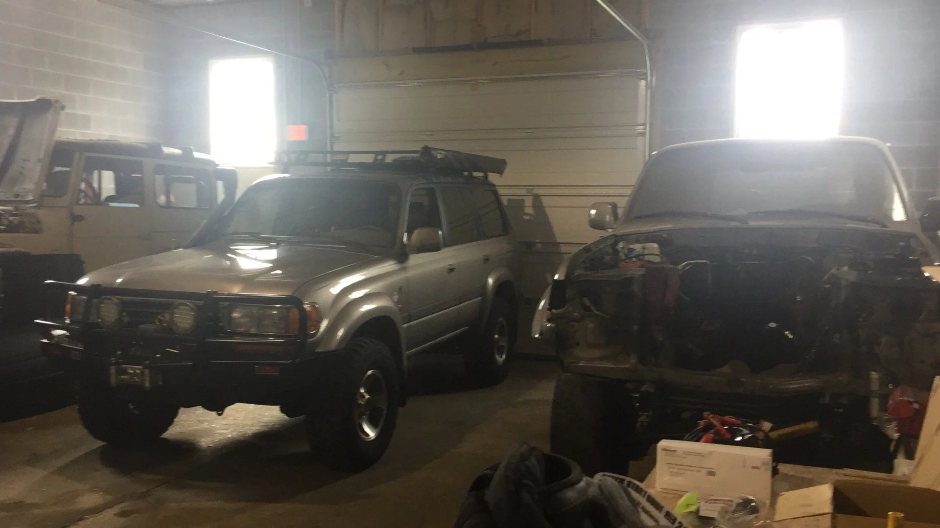

Started the tear down of the truck. Removed the front ARB bumper with a 12k Smittybilt winch to make way for a Slee short bus front bumper. This look has me drooling. Next 80 I build for myself would have a small lift, 33" KO2s and thats it. Love the plain mildly stock look of the 80 series and of course a naked roof.

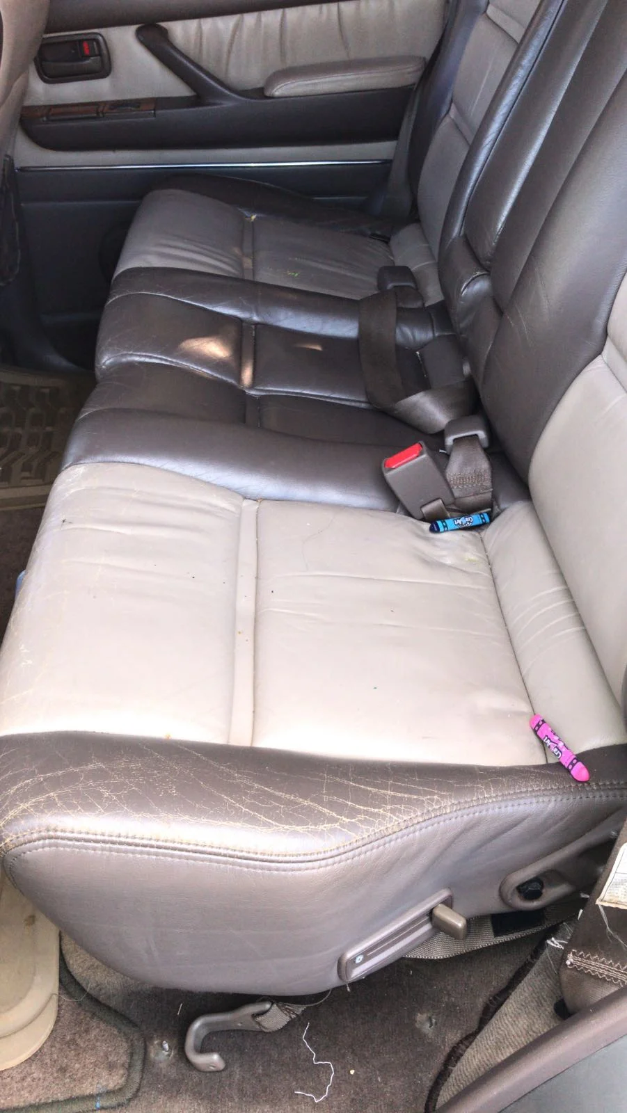

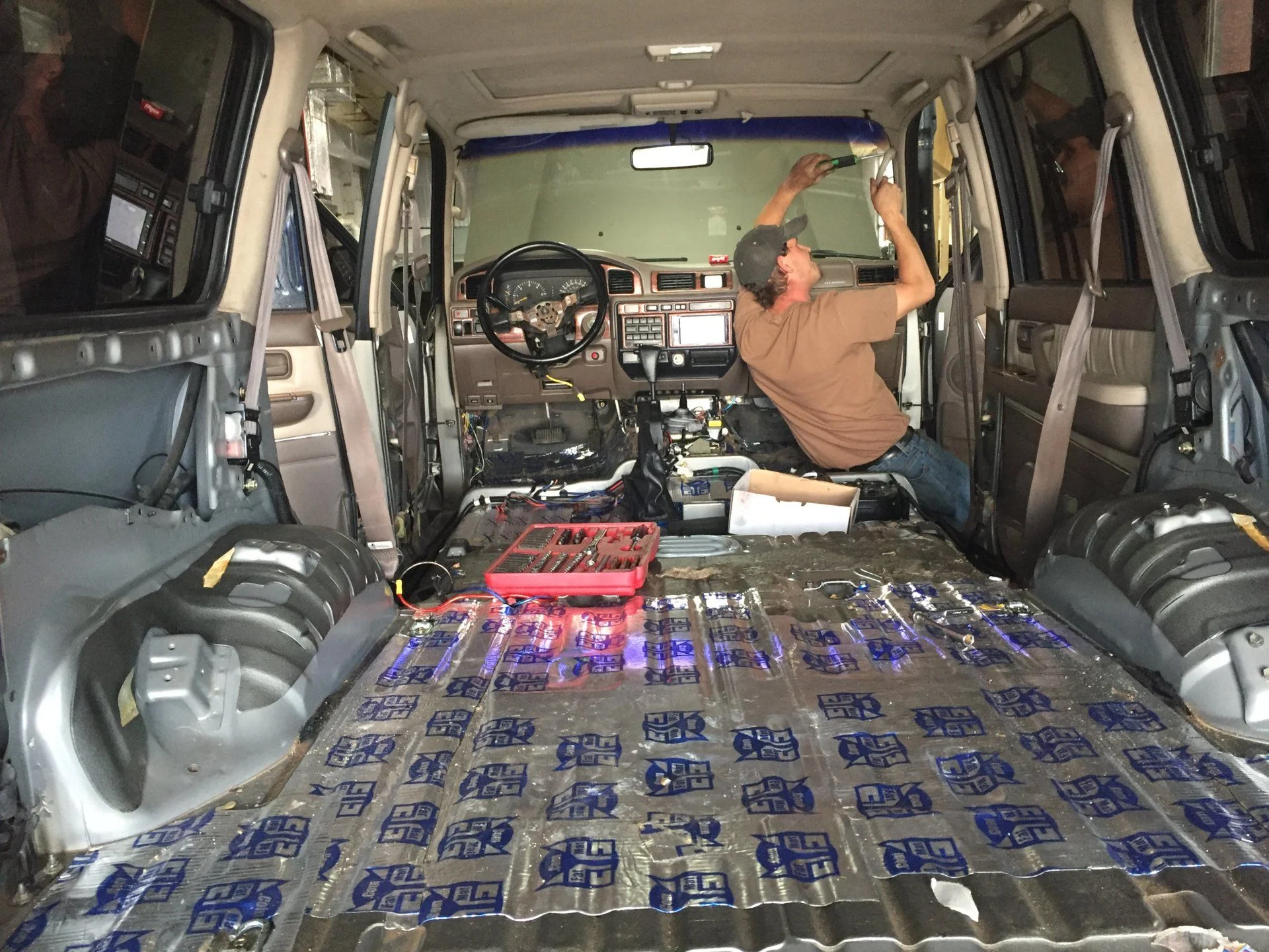

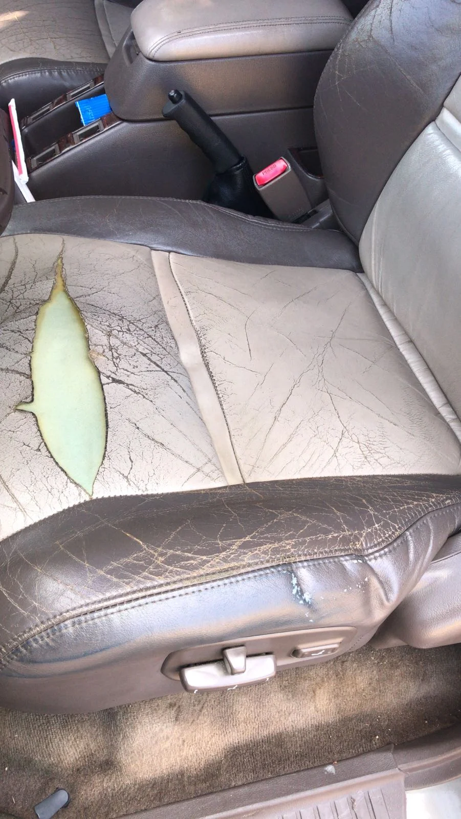

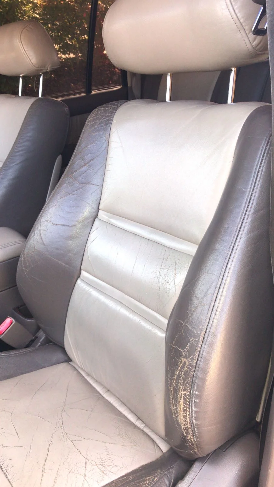

The interior will see a complete renewal from a 2 row Land Cruiser Heaven 40th anniversary leather seat cover kit. The steering wheel will also get rewrapped in Factory brown with LCH steering wheel leather. The carpet will be replaced withh all new OEM carpeting up front and underneath will be covered with some sicks ass sound deadener as well as above the headliner. We want to bring modern utility to this beautiful classic.

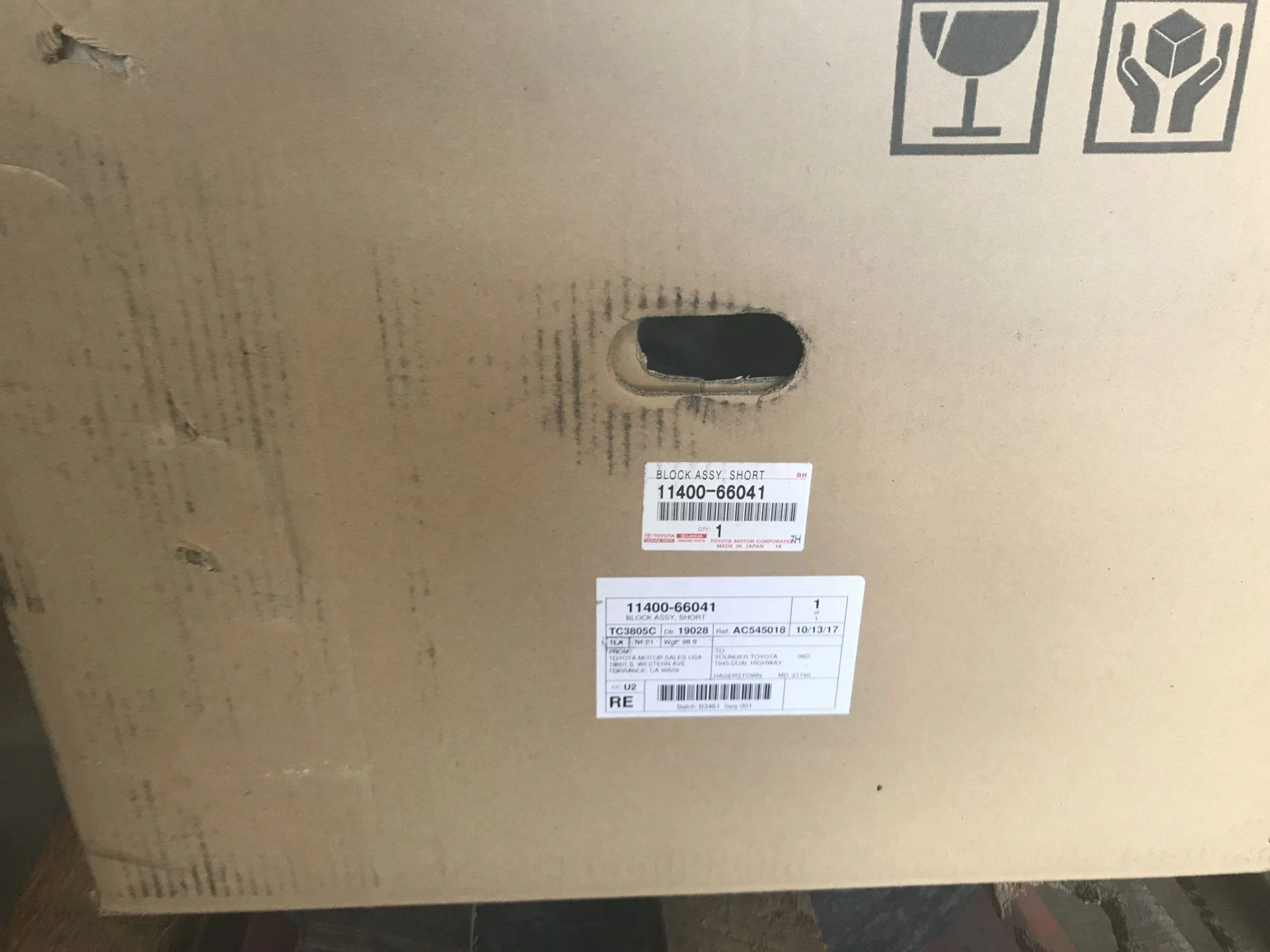

  • Engine - Current engine has just about 290k miles on it. Even though she doesnt leak or smoke, we dont have much history on it other than what the PO said he did to it. So in order to have peace of mind and to prolong significantly this rig we opted to do a complete rebuild using only OEM parts with the exception of the block. We ordered a complete 1FZ short block assembly and will be building the rest off of that. We want the engine to be in perfect condition for when we add the Magnuson Supercharger kit to it.

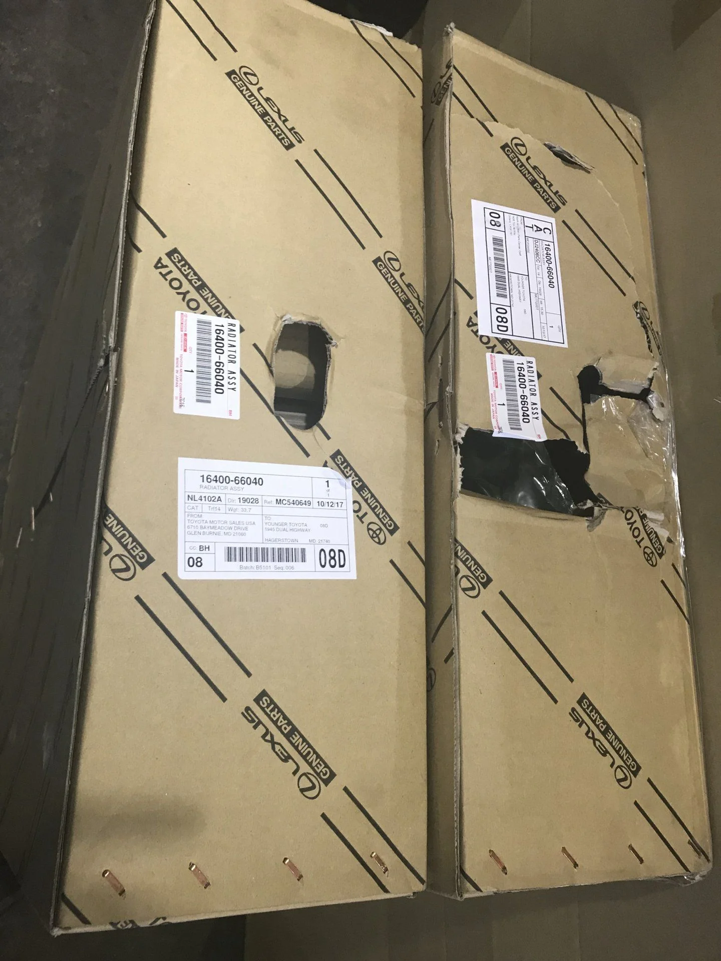

  • Cooling - The cooling system will be headed up with a 93-94 Brass 3 Core Toyota OEM Radiator with a modified blue fan Clutch.

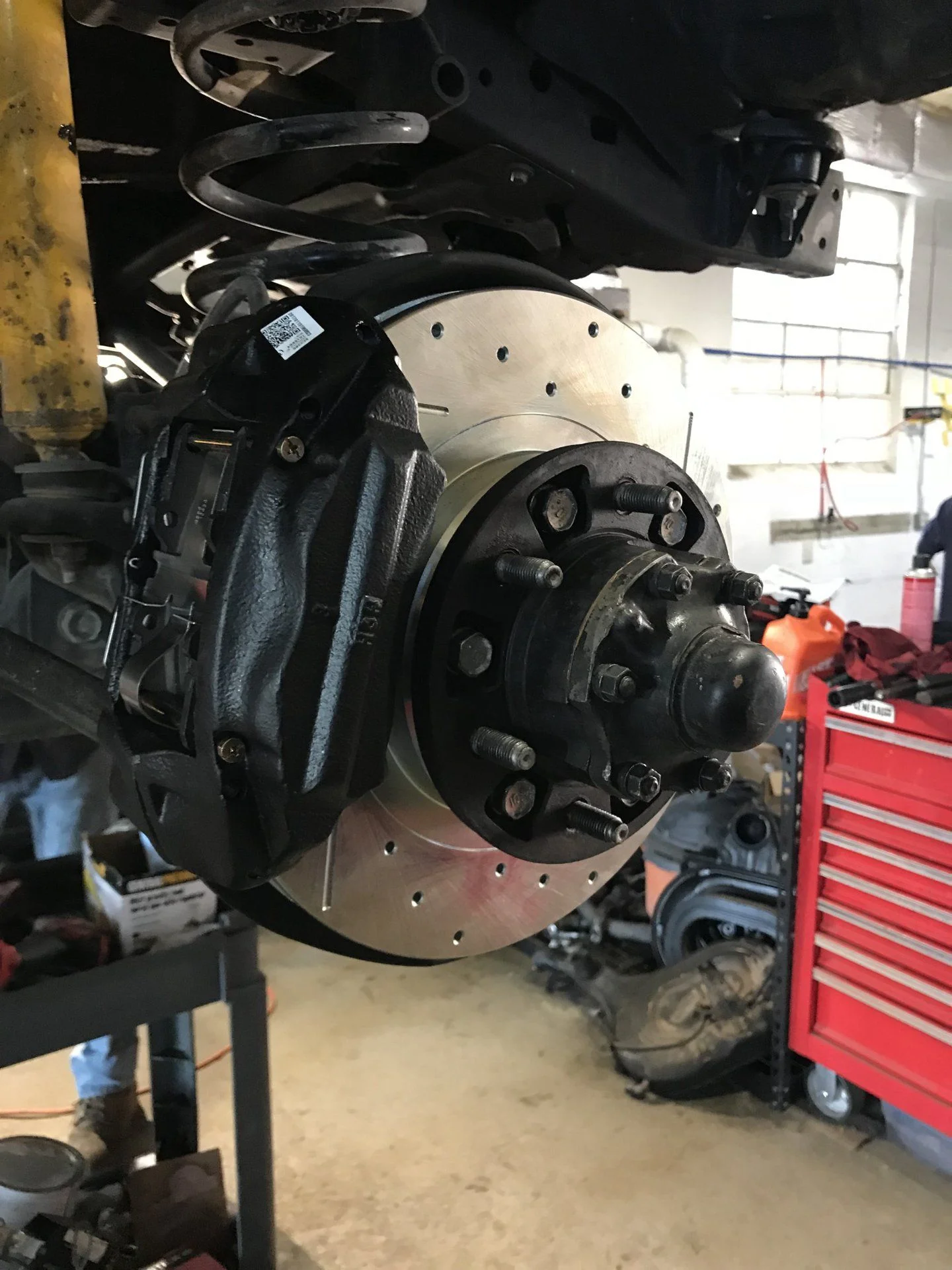

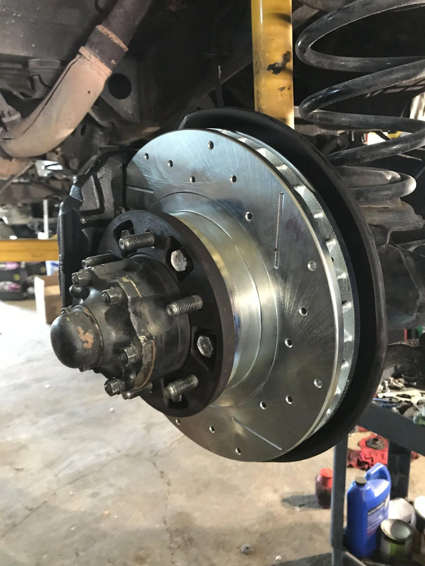

  • Brakes - The brake system was in great shape, but we wanted to again baseline it and upgrade it so we went with some Cross drilled rotors new Calipers and pads. Along with all new soft brake lines upgrading them to the Slee Extended stainless Brake line kits for both frame to axle and axle to caliper.

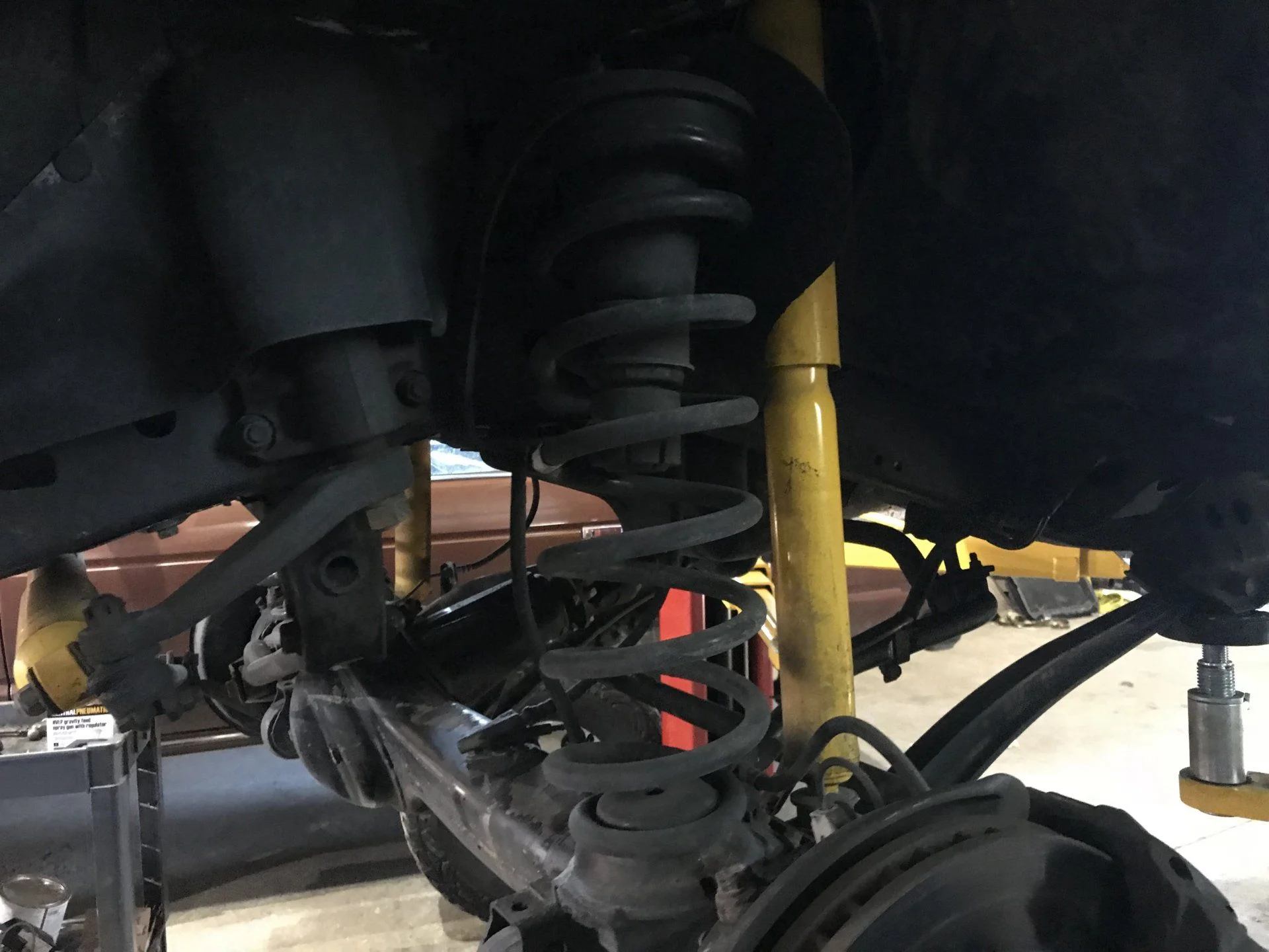

  • Suspension - The EFNY truck came with an OME J spring kit. We will be upgrading this to a 4" Dobinson Heavy kit running C59-312 and C59-313 coils, Dobinson Adjustable Panhard Rods, and Castor Plates

  • Seats - Like I stated before the seats will get redone in LCH 40th anniversary Combo Leather. The power motors will get fresh gears from Gamiviti.
  • Floor - The floor is already covered on a fatmat sound deadener but we will be taking it to the next level with more layers of sound deadening. The floor and doors will also see these. More to come on this. This will all be covered with a brand new OEM Oak 3/4 carpet.

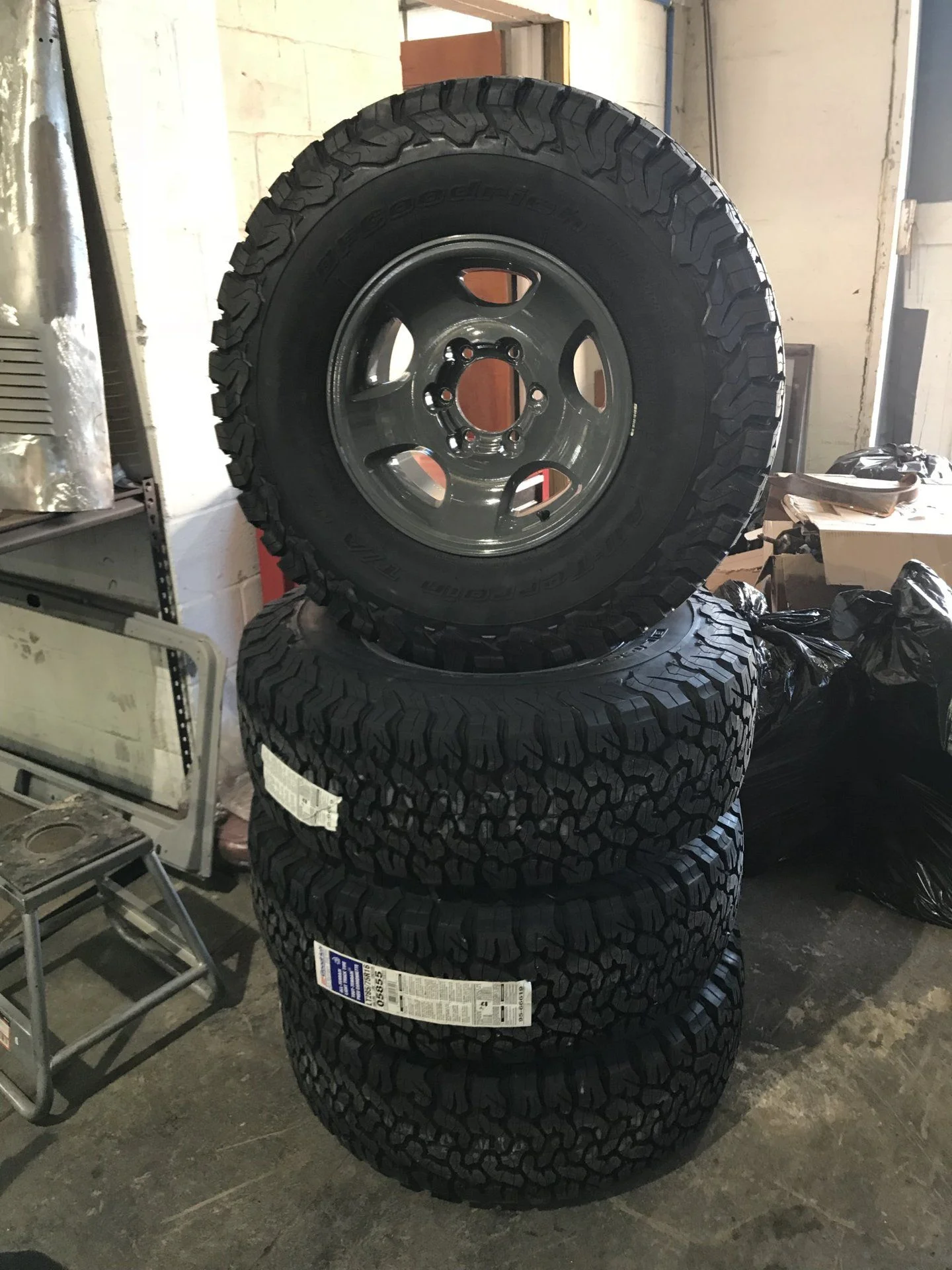

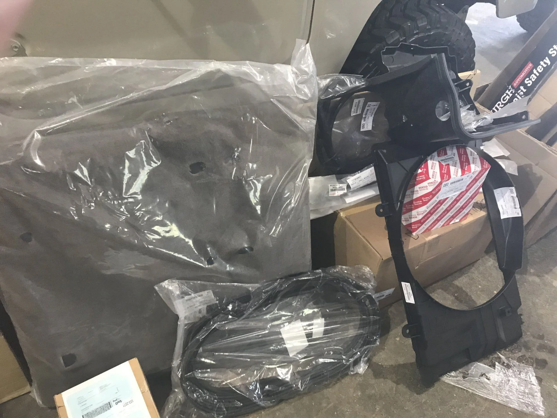

So last week was a busy week placing orders with all my vendors. I needed tires for various builds so called up BFG and placed a tire order. Also mated EFNY's new tires with some dark gray 80 series wheels. They will look amazing when its all said and done.

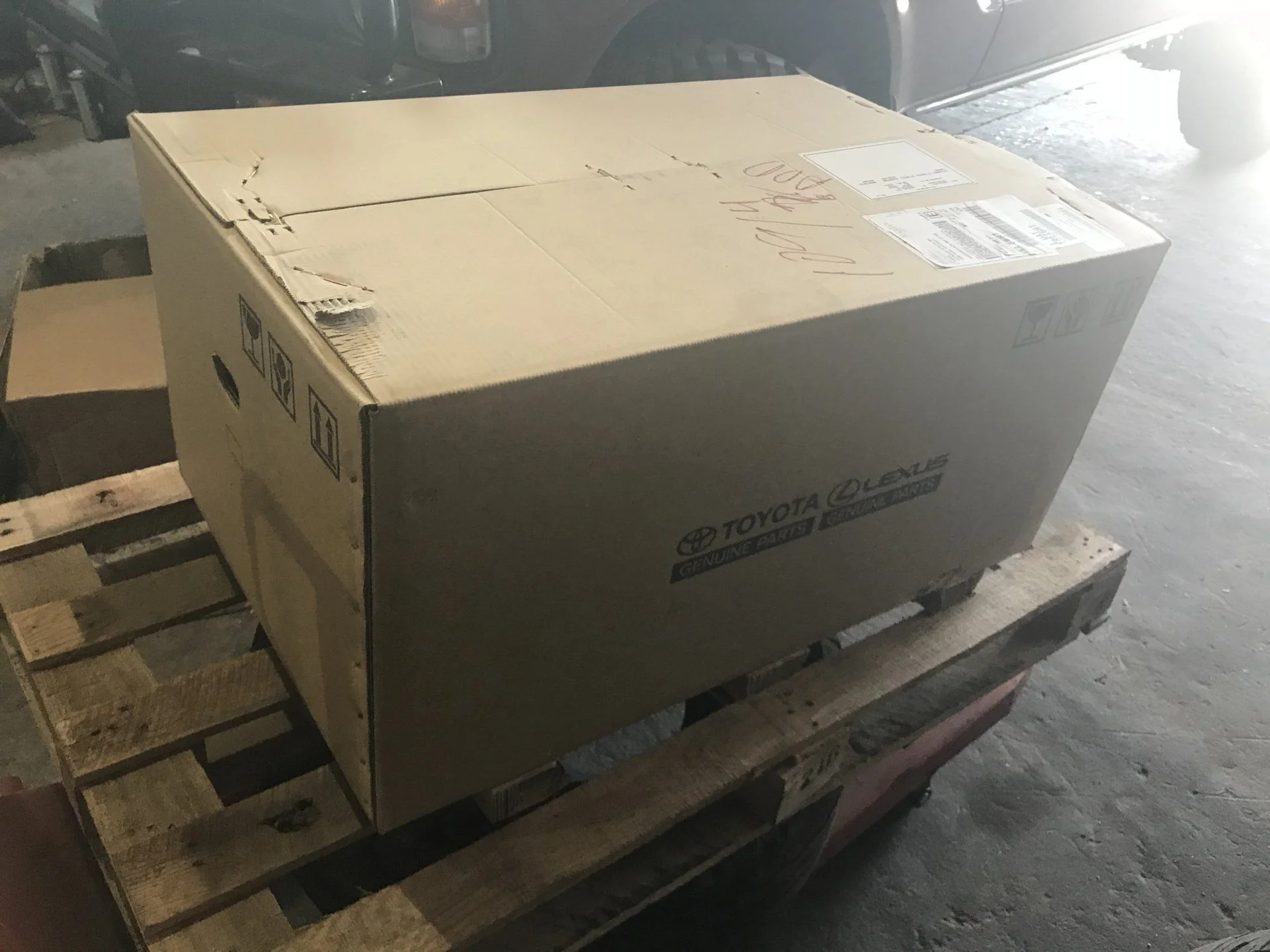

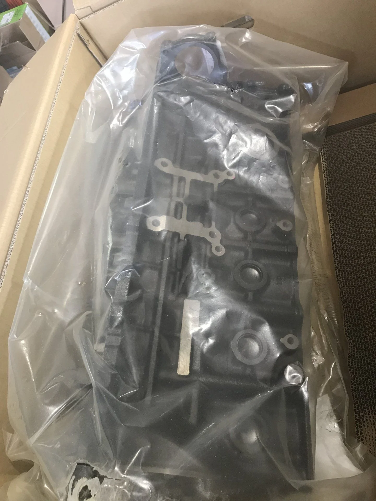

Next call was to Toyota. We needed some parts for our Stage 1 build. So 3 days later we had everything show up. This 1FZ short block is such a beauty.

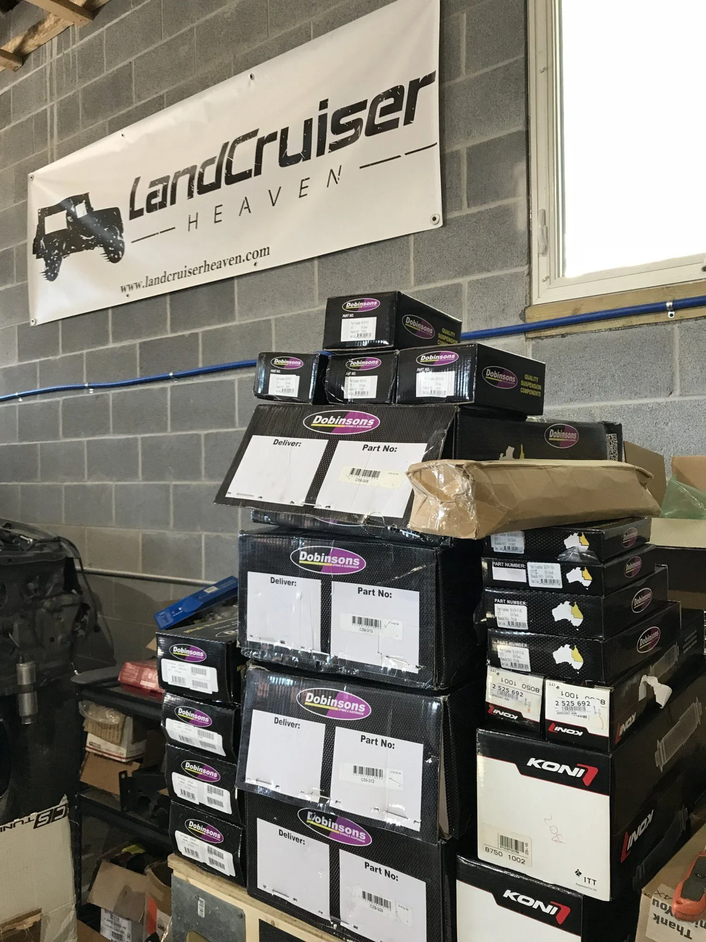

The next call went to Dobinson. We are a Dobinson Reseller but needed some parts drop shipped for EFNY. It always great to deal with them!! @David Otero Thanks for great service. We have put Dobinson Suspensions on all our rigs and have been really happy with the outcome.
Cant wait to remove that old OME suspension.

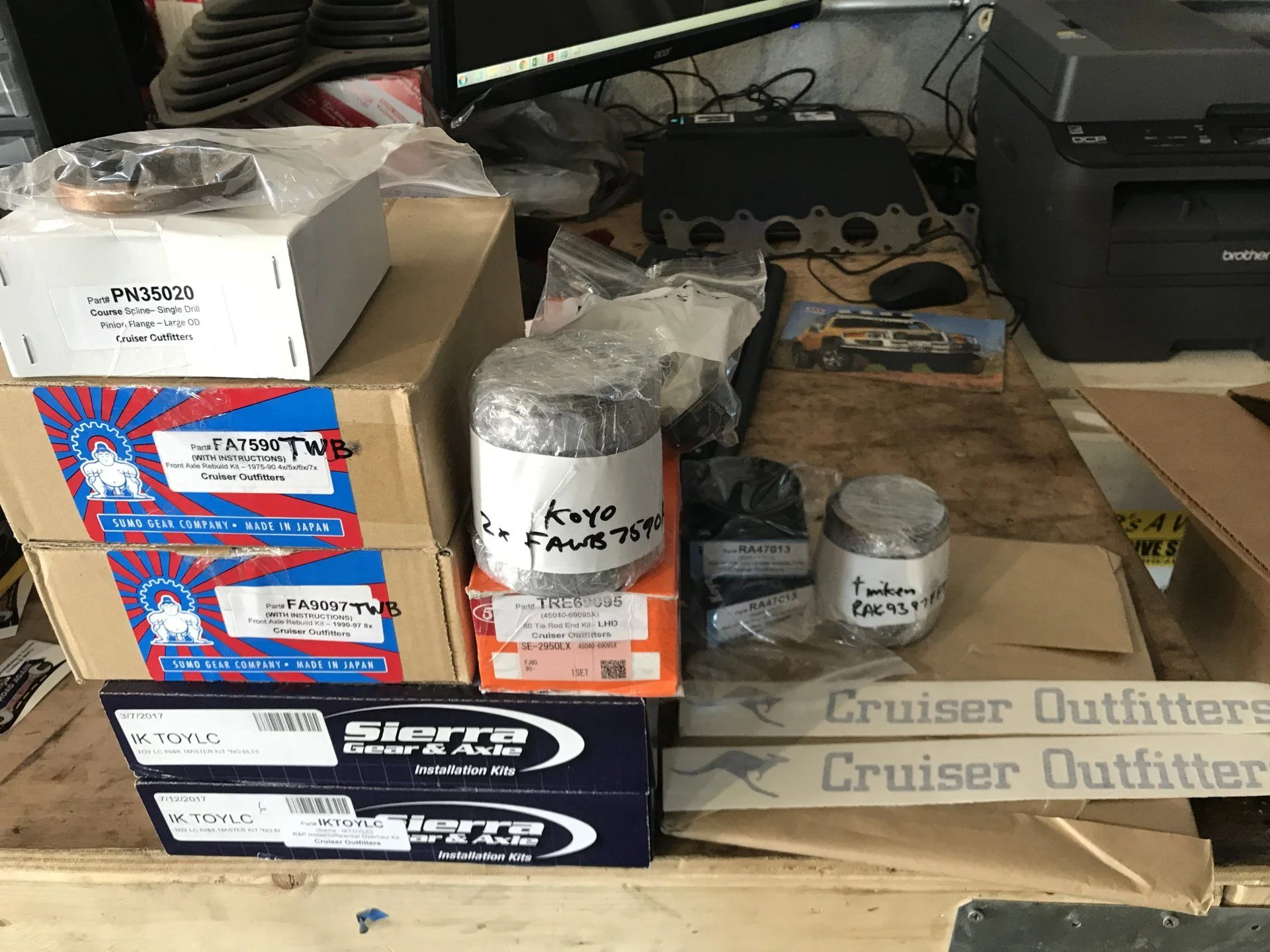

Our next call was to Cruiser Outfitters. We needed to start work on the knuckle rebuild and the rear axle. Spoke to @cruiseroutfit Kurt and he had me all taken care of in no time. Another amazing company and cruiser head!! A few days later everything arrived and we got to working.
