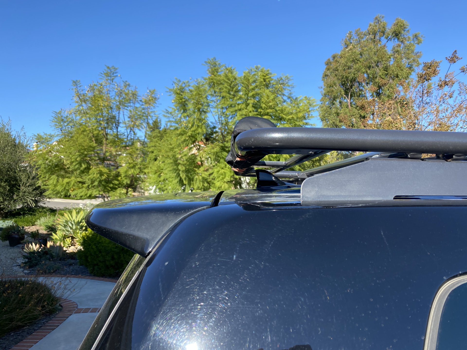

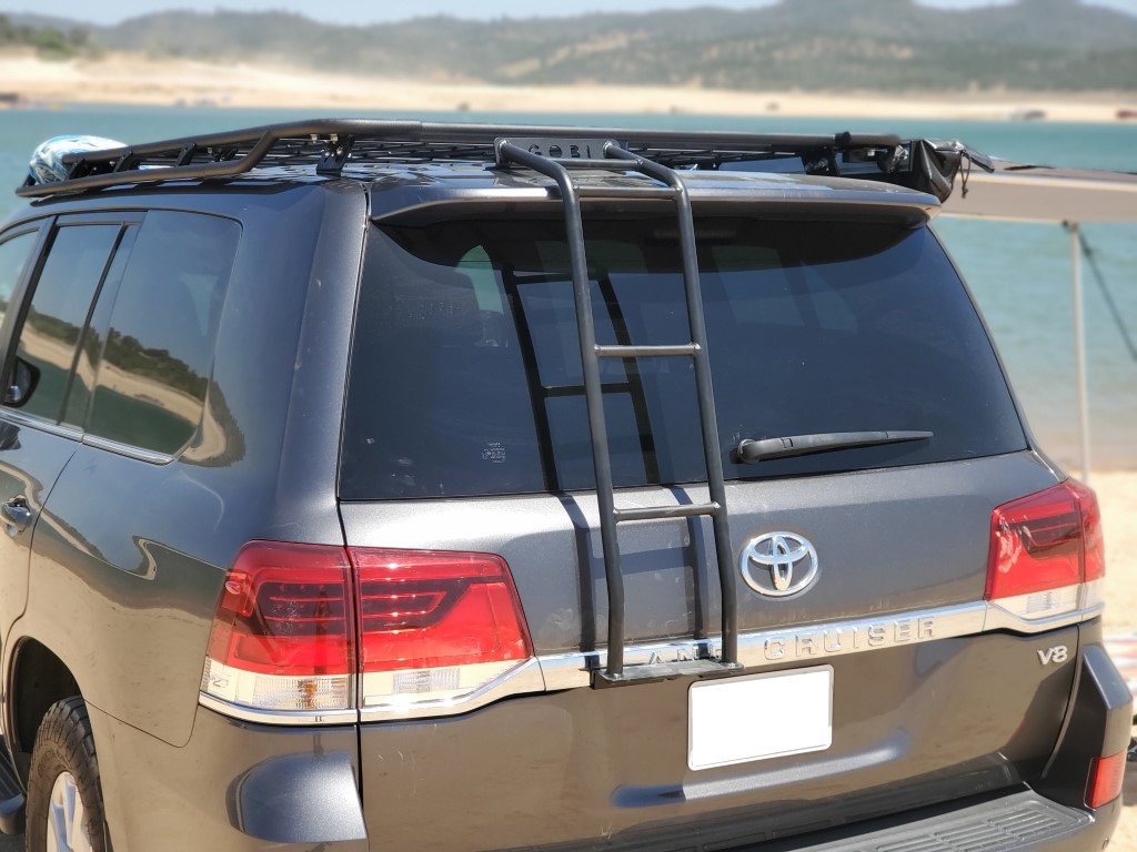

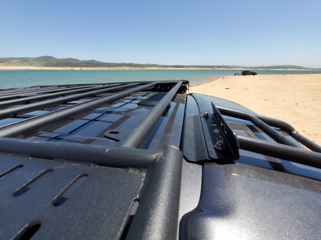

My Frontrunner rack is pretty far back, and I didn't have to adjust it for the Gobi ladder. If there's still daylight when I get out of work I'll measure and snap a couple pics. Here is a basic view though:

Rack looks great. I think it'd look even better if it had some legs that "floated" down further, towards the rear bumper, perhaps not touching but it'd be a nice additional step or two. I sent a message to Gobi Racks via their instagram. Hoping to speak to one of their techs since they say these are made to order. I don't see why they wouldn't be able to weld to legs and another step bar below that last latching point. Otherwise it seems like a pretty high first step!
Only reason I had this idea is because I really like the look of the gobi ladder on the 4Runners which cover the entire back side. Obviously this Land Cruiser variation is a result of the dual-door trunk system. Either way, I'll be sure to share what I hear back from them!

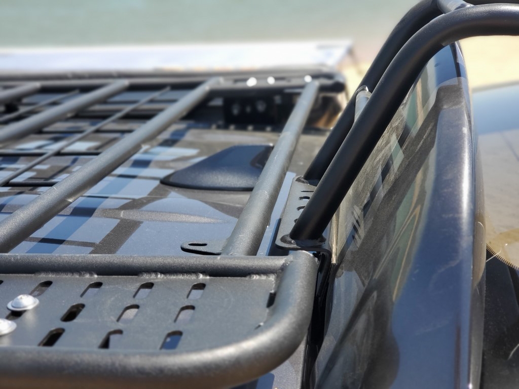

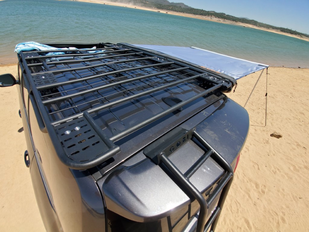

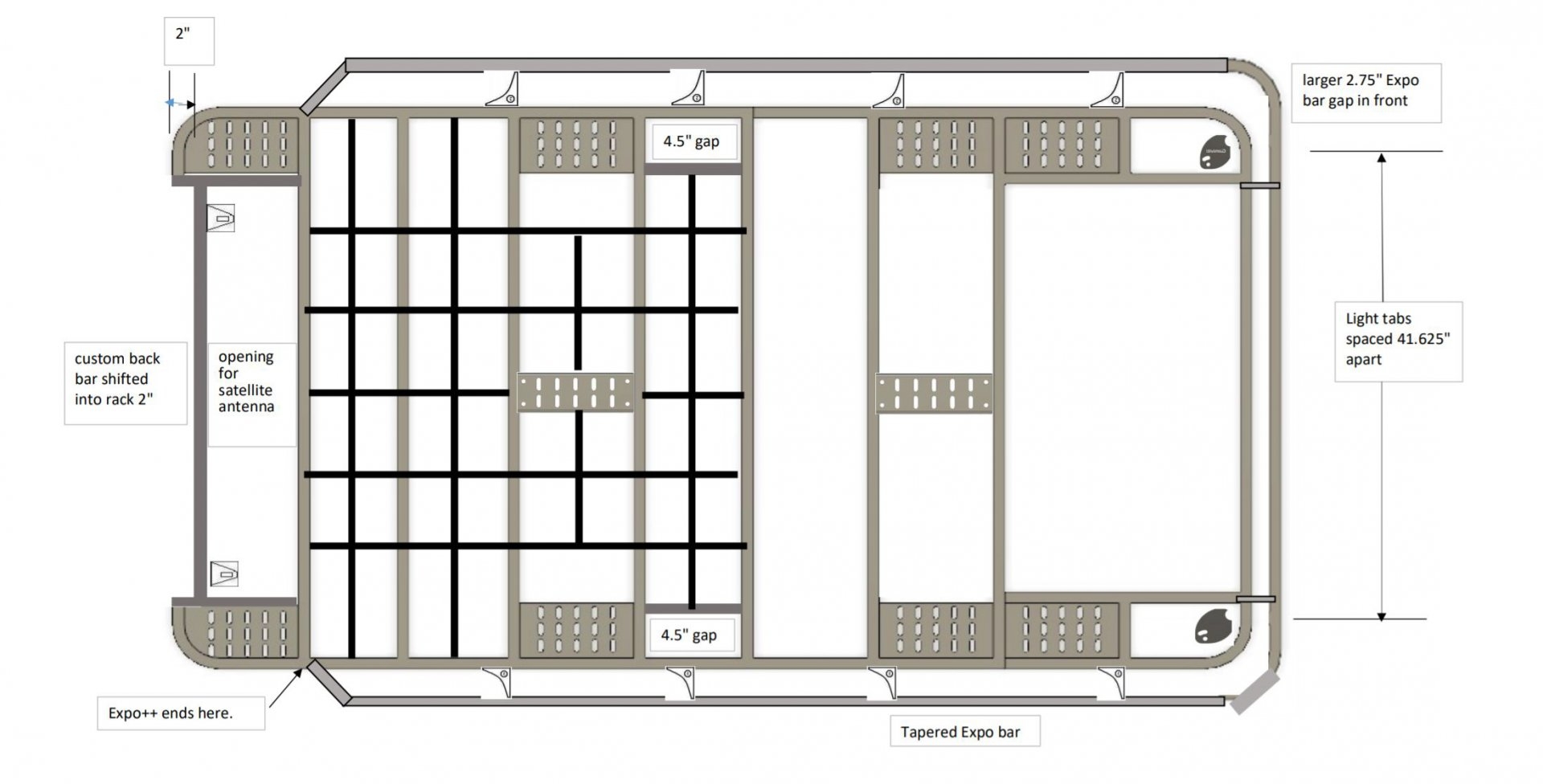

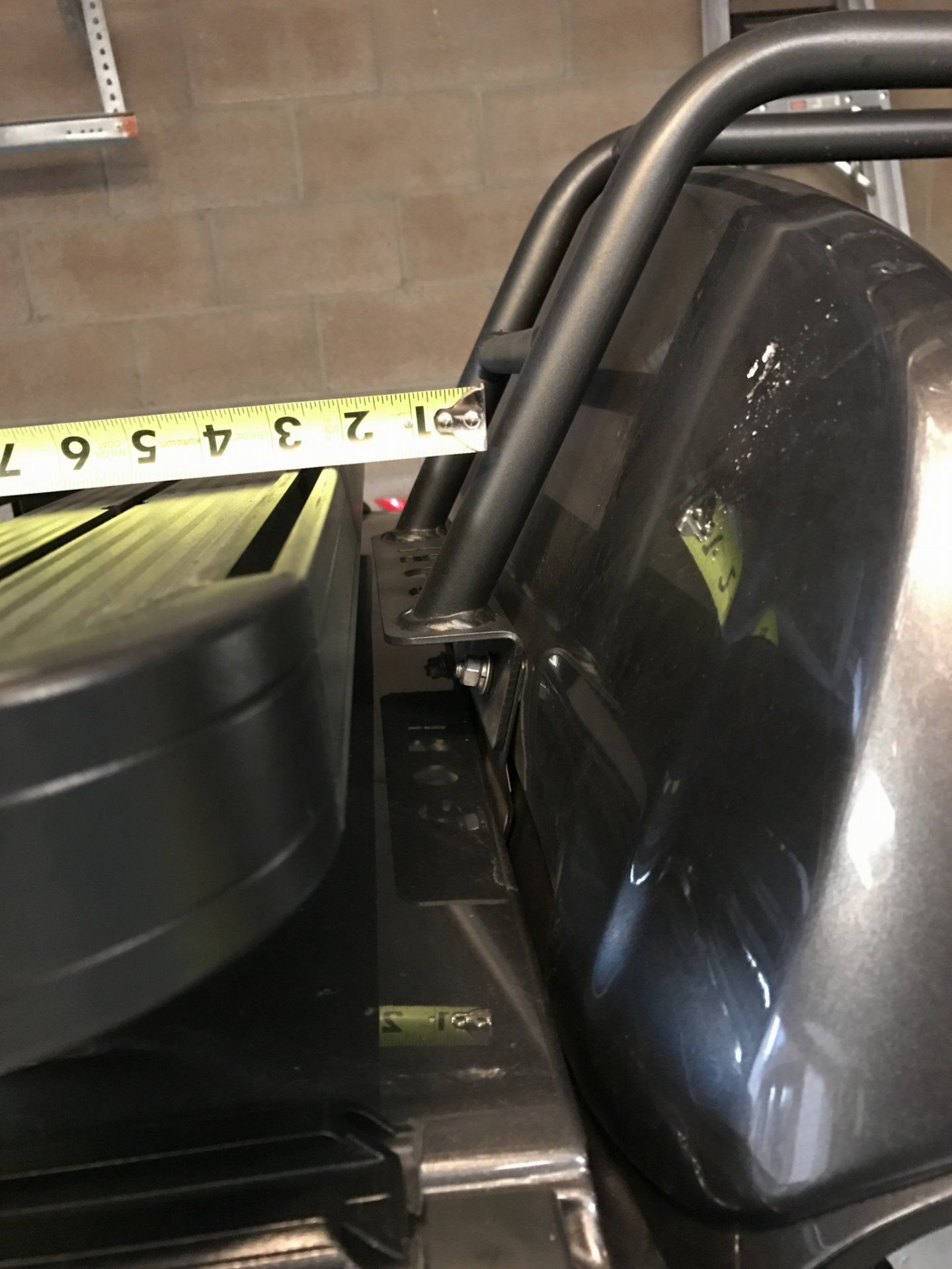

I read this thread a year ago and also had trouble finding a ladder rack combo that would fit my needs. Tim at Gamiviti came through with a custom rack.
Gamiviti Rack + Gobi ladder. Works like a charm.
Hats off to Tim, all the stuff he makes is awesome.

Do you like that grid portion now that u got it? Is that what he calls the basket? Is it useful? Also I agree. Tim is one of the most knowledgeable dudes I've talked to. Very honest. Very informative. Doesn't try to over sell you.
Love my Gamiviti. Tim built it is March and helped me install it in May when I was in Colorado to visit family. Instead of the grid option I went with the plastic "pergola" floor thing that you can snap on when you need them. I keep the rearmost "pergola" on all the time and added a few zip ties to make sure it stayed put in extreme wind situations. I have 2 more sections - enough to cover the whole roof - for when I want to use it as a platform to stand on (for photography). Time also helped me install the MaxTrax holders he makes on the crossbar just behind the sunroof and we did a quick mod to that one pergola piece so it could all fit. This was an on the fly mod while installing. Tim was awesome!
Since I use a Gobi ladder Tim also made that adjustment to the rearmost crossbar to accommodate the top of the Gobi ladder. (As for the Gobi ladder, I had to order the new version for the auto-open lift gates like I have on my new 2021. I will be selling the Gobi ladder I had on my 2016 which will not work with the auto-open lift gate model 200 series.)
They call it the 'grid floor'. Tim said the drop basket adds a bunch of weight. I do like that it adds some more lashing points and protects the roof from stuff you put up there. Would definitely get in the way if you ever want to mount a tent up there though...

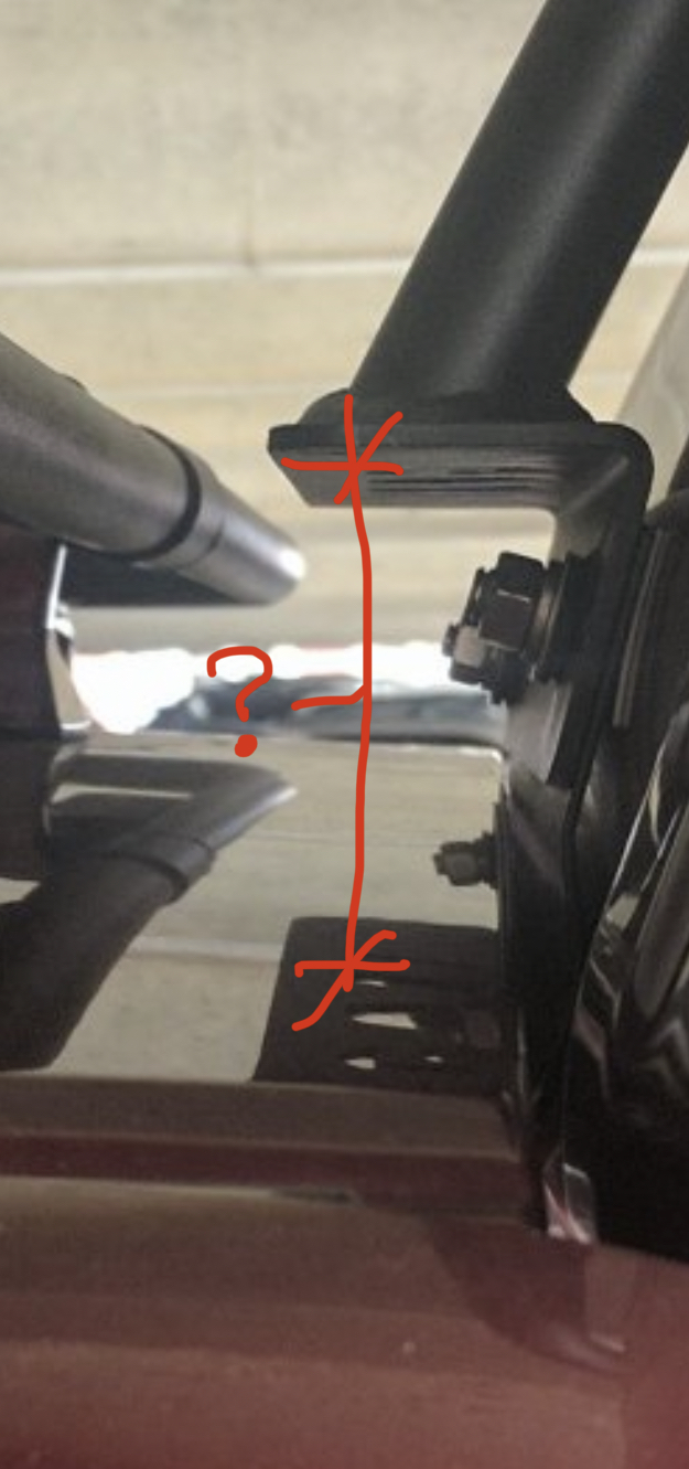

Hmmm, I ordered a Gobi ladder for my LX570 but am now a little worried it won’t clear the roof rack. The ARB rack does not seem to be adjustable front to back- not to say it couldn’t be modified to fit, but it would take some effort and be a bit of a drag.

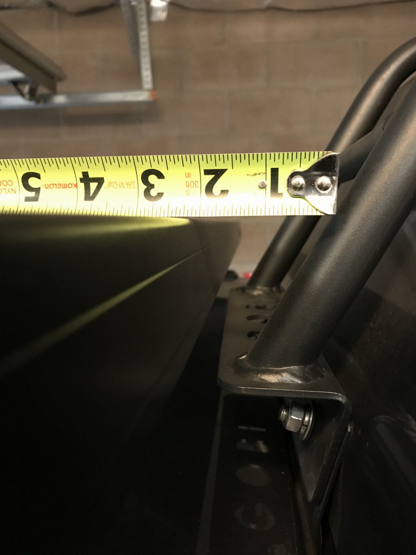

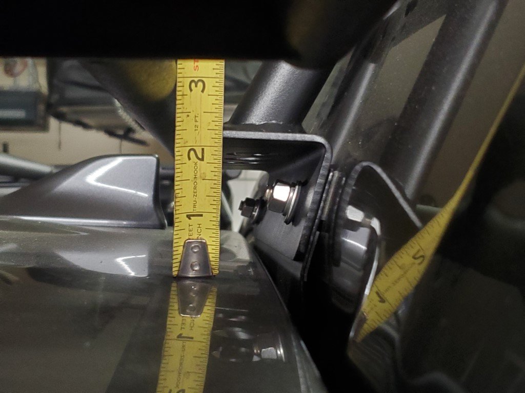

@mcgaskins any vertical measurement available between the roof of the truck and the “GOBI” flange at the top of the ladder, when in the open position? Maybe the ladder flange will sit below the roof rack.
Hmmm, I ordered a Gobi ladder for my LX570 but am now a little worried it won’t clear the roof rack. The ARB rack does not seem to be adjustable front to back- not to say it couldn’t be modified to fit, but it would take some effort and be a bit a drag.

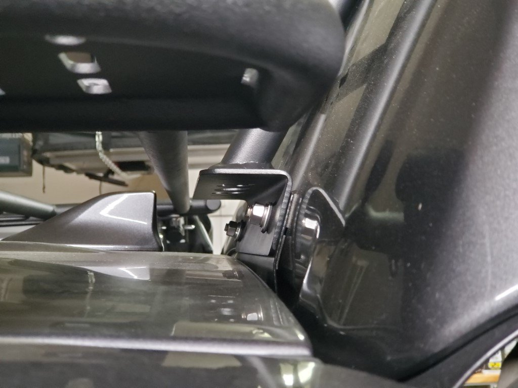

It sits pretty level with the fin. Check it out.
Awesome, thanks for the quick reply. Will check my truck tomorrow but I assume I’ll need to modify my rack to move it foreword, to accommodate the ladder. Appreciate it.

One more thing. I don't know how the ARB Base Rack works. For my Gamiviti rack, Tim customized to move the rearmost bar forward a couple of inches so that the Gobi ladder could clear it when the rear tailgate is open. This is evident in the picture by @YellowDoor which I believe shows a similarly modified Gamiviti rack. (People ask why I went with Gamiviti. A huge consideration for me was the ability to customize the build.)
