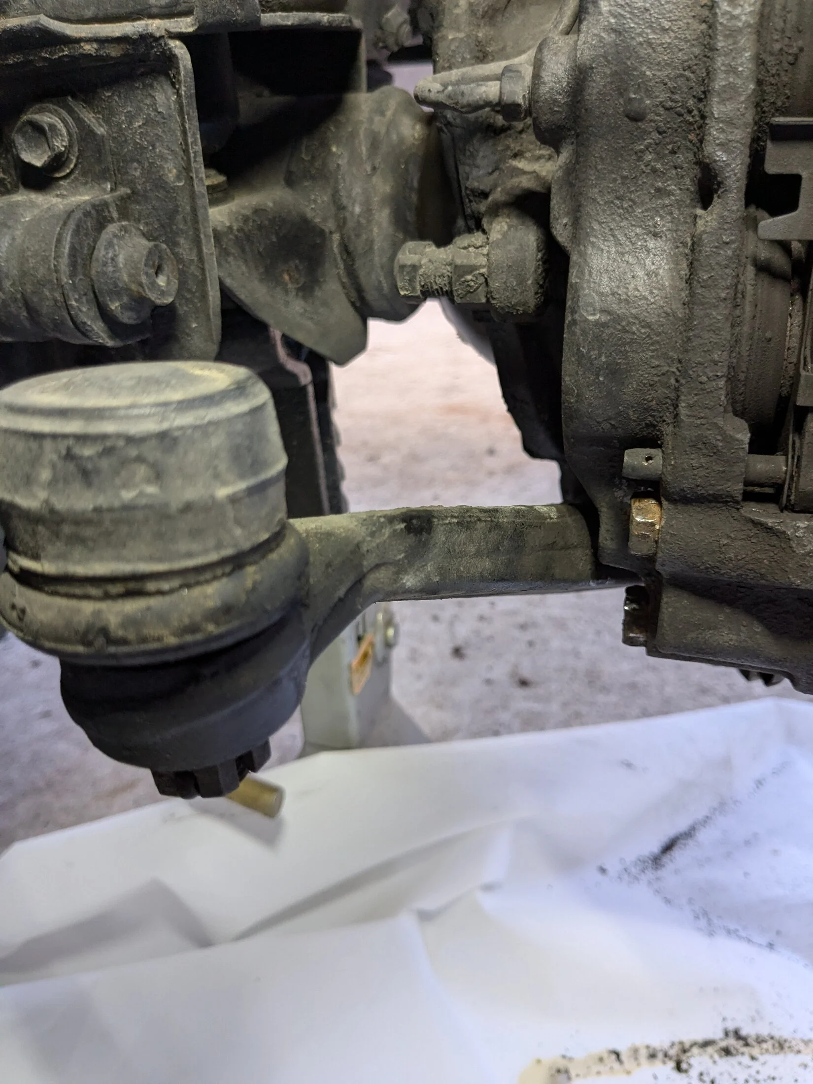

Any one have any tips for the two lower caliper bolts (pictured lower right) on front end bakes? Lower control arm doesn't allow for socket and box wrenches having hard time fitting. Believe 14mm, but just won't give and believe I'm starting to really goober up the head of the bolt. Awesome video BTW @Mellim!

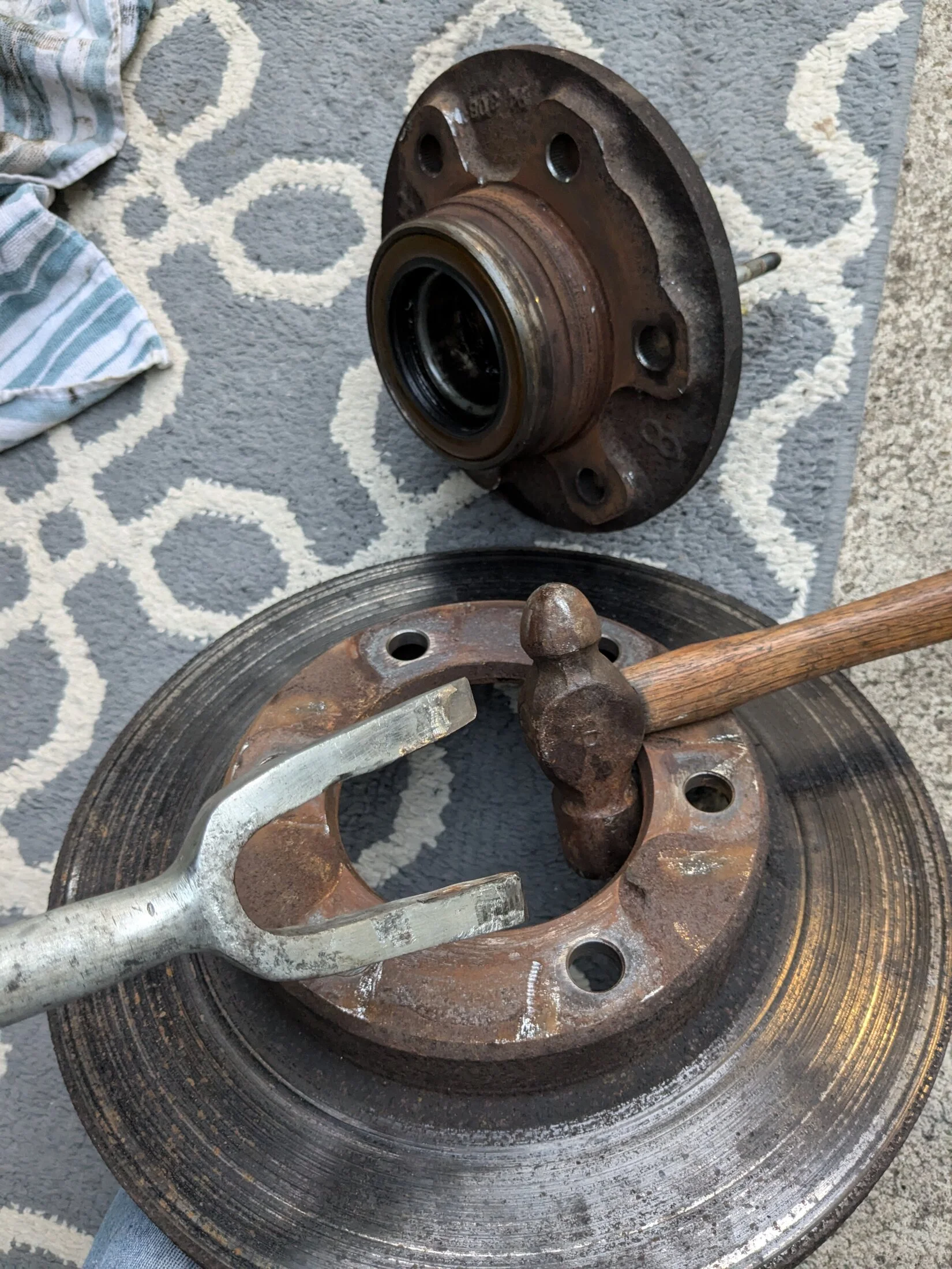

Found the perfect tool combo for separating a 30 year old, rust welded hub and rotor - ball joint / pickle fork slips right between the bold housing. Tap tap taparoo.

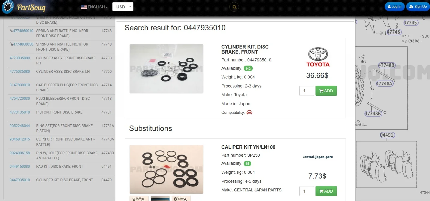

PS. You forgot to mention part number for the piston seals.
