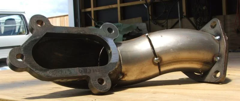

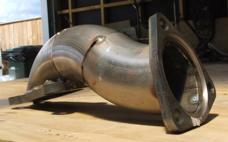

go 3" it fits , I bashed floor in a little to fit my homemade one and ripped off the soundproofing/heat stuff as well, Im 6ft with big hands and two left thumbs and I can still fit my fingers up to do the bolts / nuts up for the flange, also while its out check oil return on turbo as this will be way easier to replace with the exhaust out of the way(prone to cracking, oem replacement only bout $75USD , comes with a trick "joined copper washer" for easier install).
You could possibly fit 4" but making clearance around the flange for the nuts would be really hard as 3" only just clears the nuts on my homemade one.

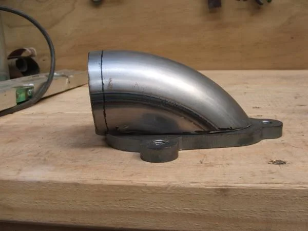

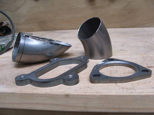

Did you TIG or MIG weld your dump pipe? I'm going to make my own as well with a 2.5 inch stainless weld elbow, I've found the Turbo side flange but haven't found an exhaust end flange. Would love to keep the flange on the exhaust side even though i'm going to make my own exhaust as well out of 2.5 inch mandrel bent. Looks great, cheers.
Marc
The flanges are MIG Welded, the tube is Tig, Tig welding is much more manageable on thin pipe, ie no chance of a blow hole. The triangle flange is machined recessed to fit the ring gasket.
Thanks Oldblue. I have a MIG welder but not TIG so I'll be able to make the dump pipe at least and then see if I can beg borrow steal a TIG welder.
