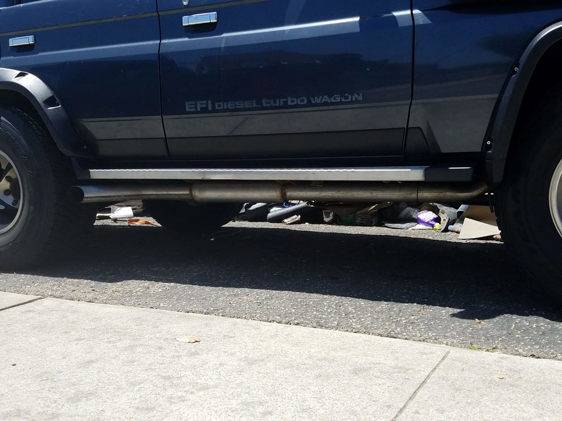

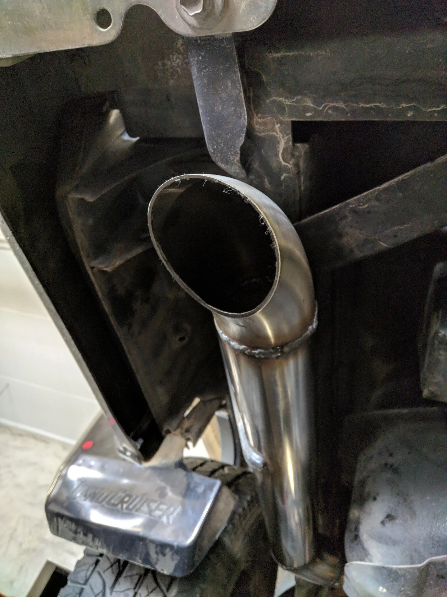

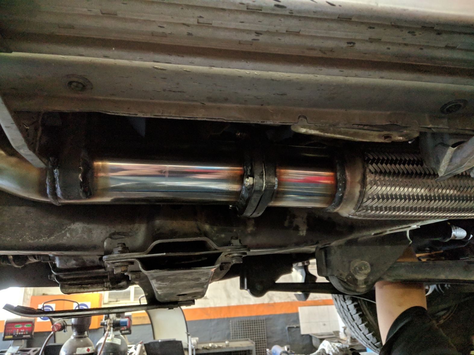

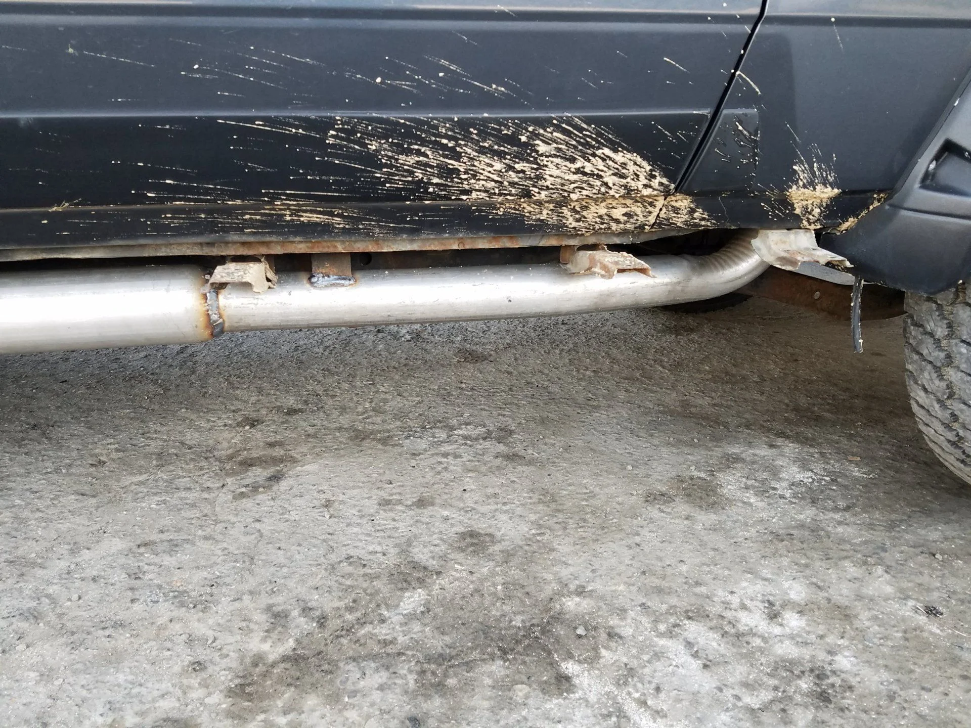

Here are some images of the exhaust and downpipe:

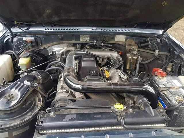

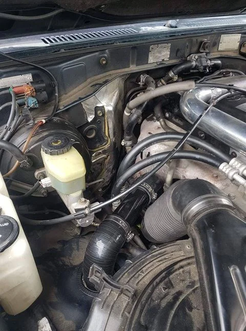

Phase 5: A Front Mount Intercooler. Here are some images of what I will be opting for...
The pictures were provided by Cori Hammond at Kaiapoi Repowers in New Zealand. Cori provided the downpipe pictured above for me as well.

dont forget doing a front mount can be cheap, my intercooler was only 200NZD
I used old off cuts from my exhaust tubing , a can of black paint, a steel drop saw and a mig welder , a Tig welder and a Saturday without the kids
And a bit of roughness, I stick to the theory of pressure over flow, when flow starts to suffer get on that boost tap and crank it up, these 1KZTE motors love 18-20psi run super cool no smoke and whistle like crazy

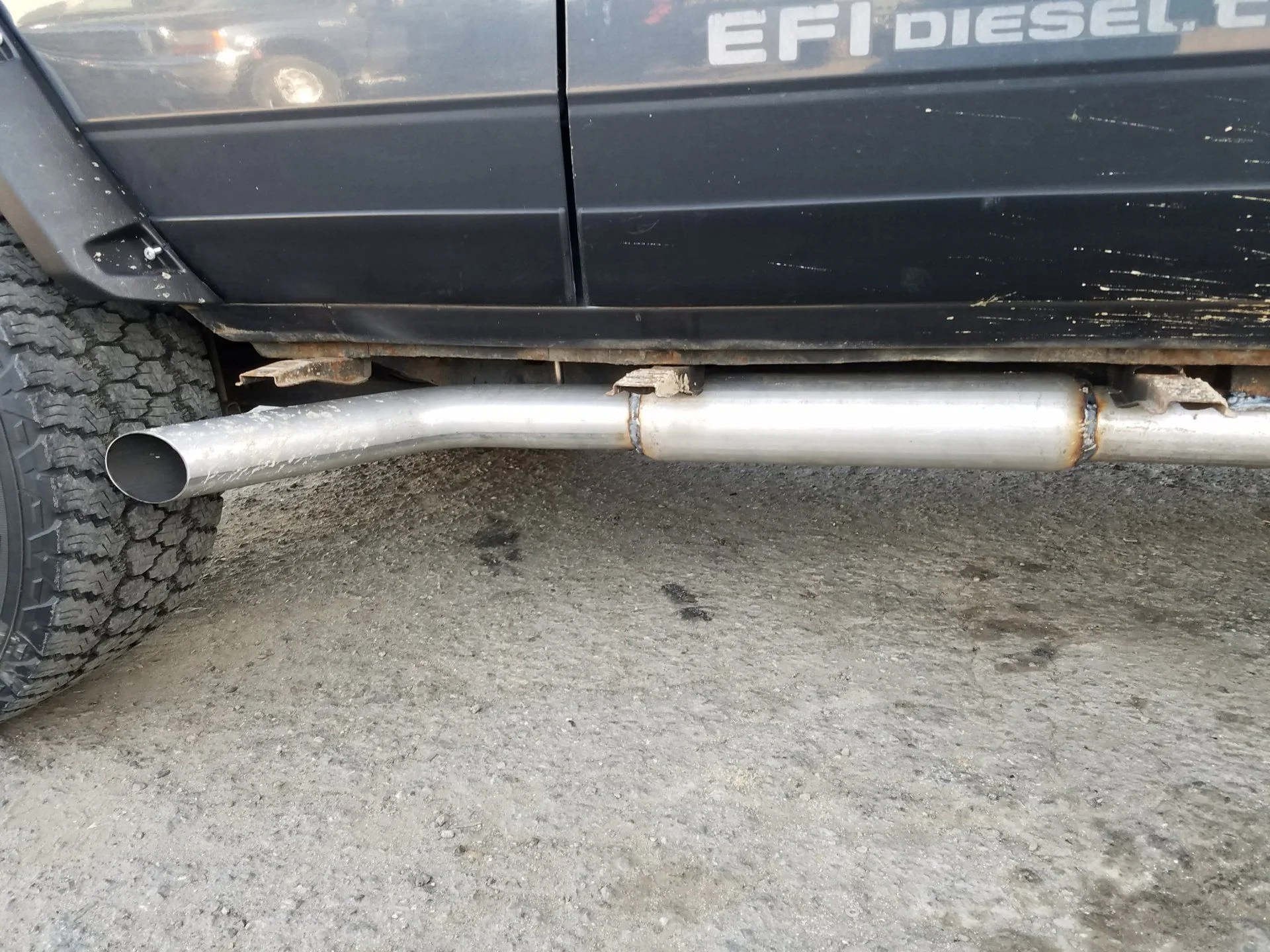

your EGT will give better info if it is installed upstream of your turbo.. I actually left in the stock downpipe, and installed the 3" exhaust as in the pics.. one bend & about 6ft in overall length.. I installed an O2 bung for Lamda sensor.. I am going to be installing a 2nd EGT sensor to measure system heat loss.. the lower the heat loss the more grunt & better "sweep" of gases thru head

With the new dump pipe and 3" exhaust, the truck has almost no turbo lag and is an absolute joy to drive. I (as in they) fitted an EGT gauge last week and in doing so it was noticed that there was a leak at the aft end of the exhaust manifold due to some minor warping, apparently very common on the KZTE, so it was skimmed and at the same time they tapped the thread for the EGT probe. So upstream of the turbo, which is ideal.
