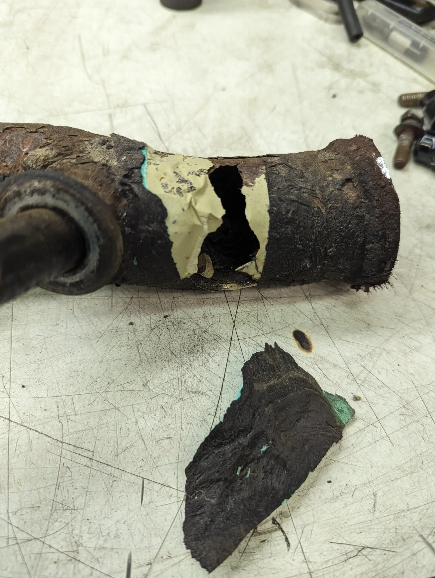

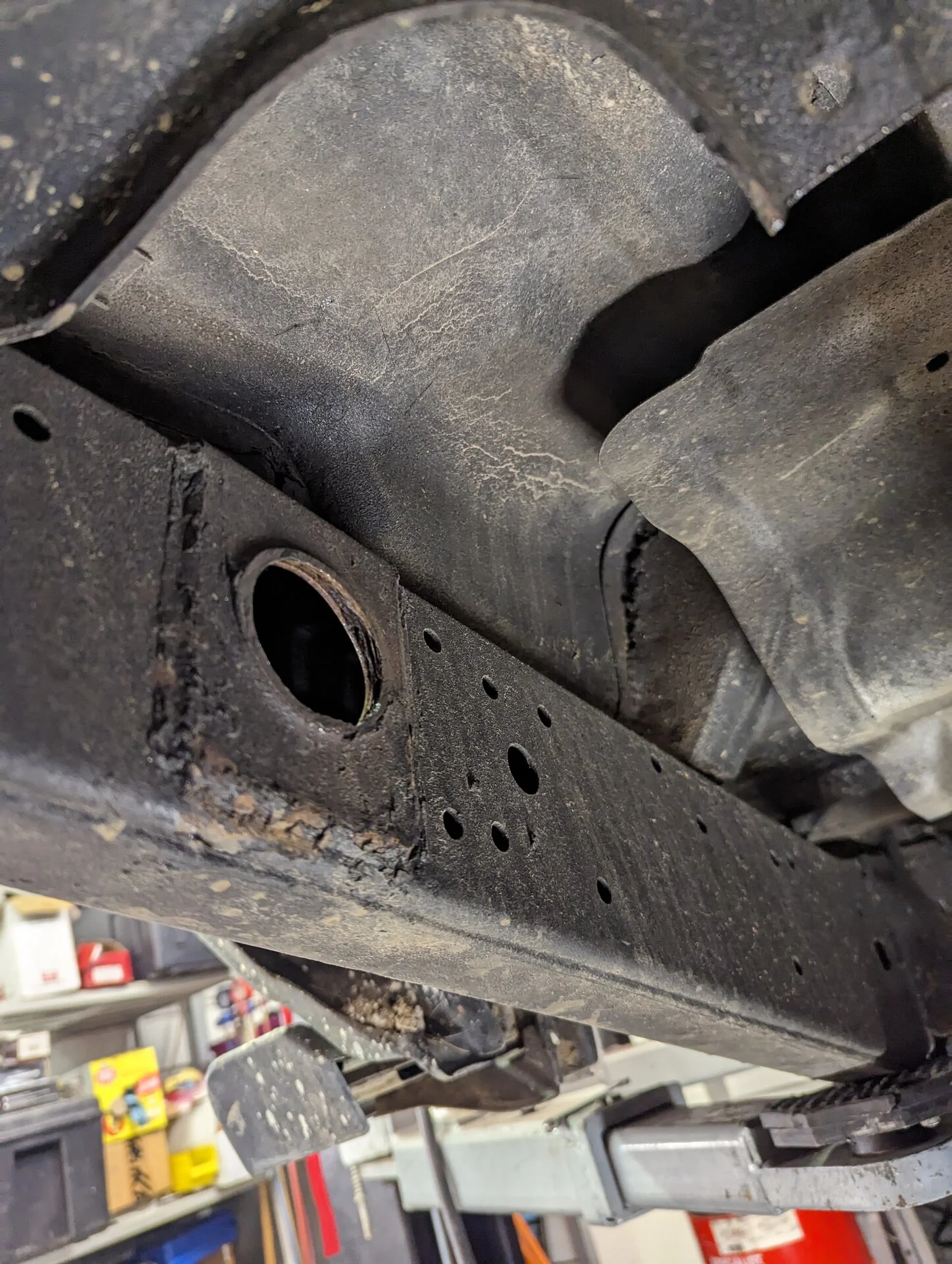

The biggest and really the only area of concern came in the rear upper shock mount tube that also holds the forward edge of the rear upper spring perches in place. Structural bondo and masking tape.:mad:

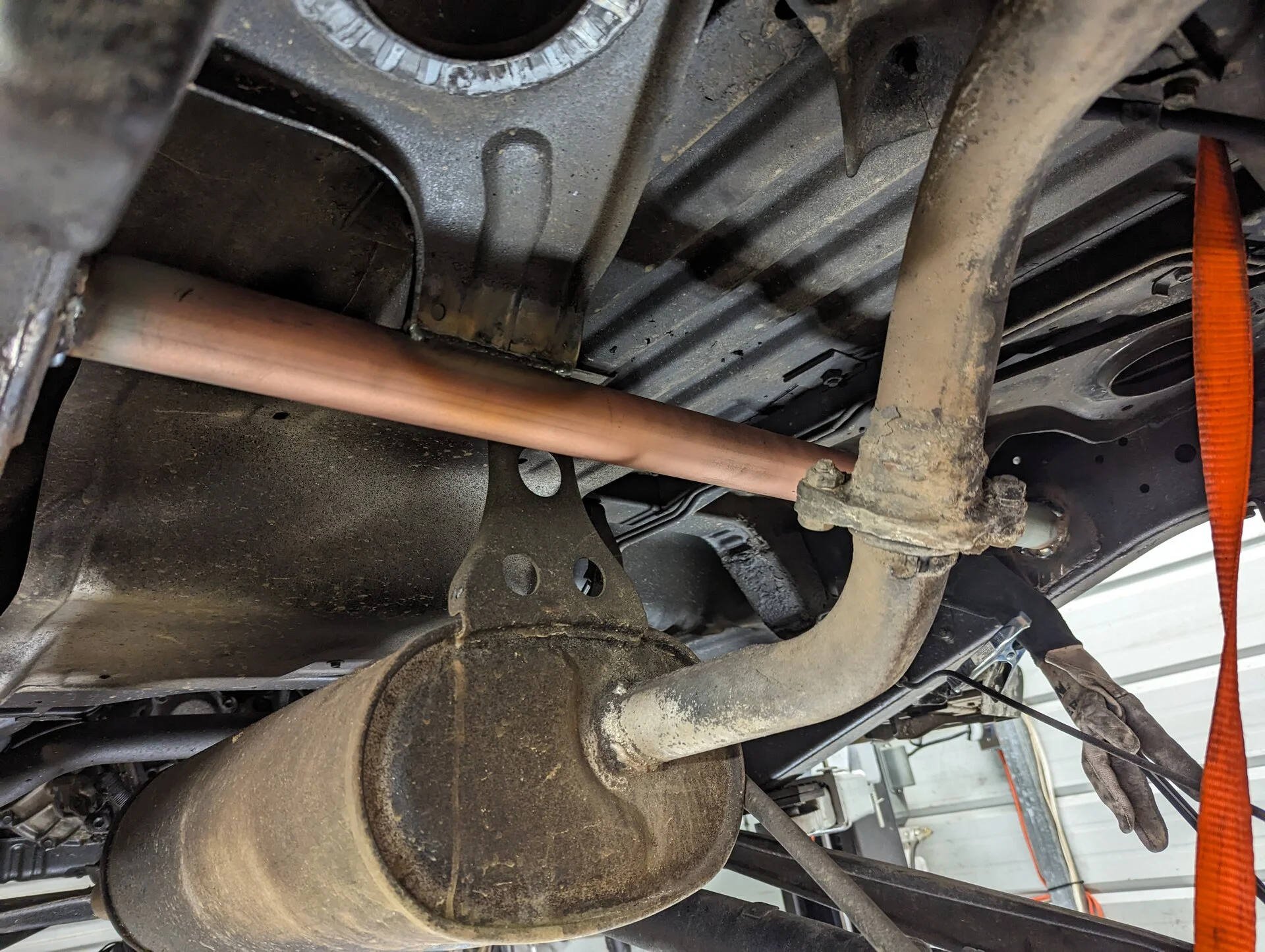

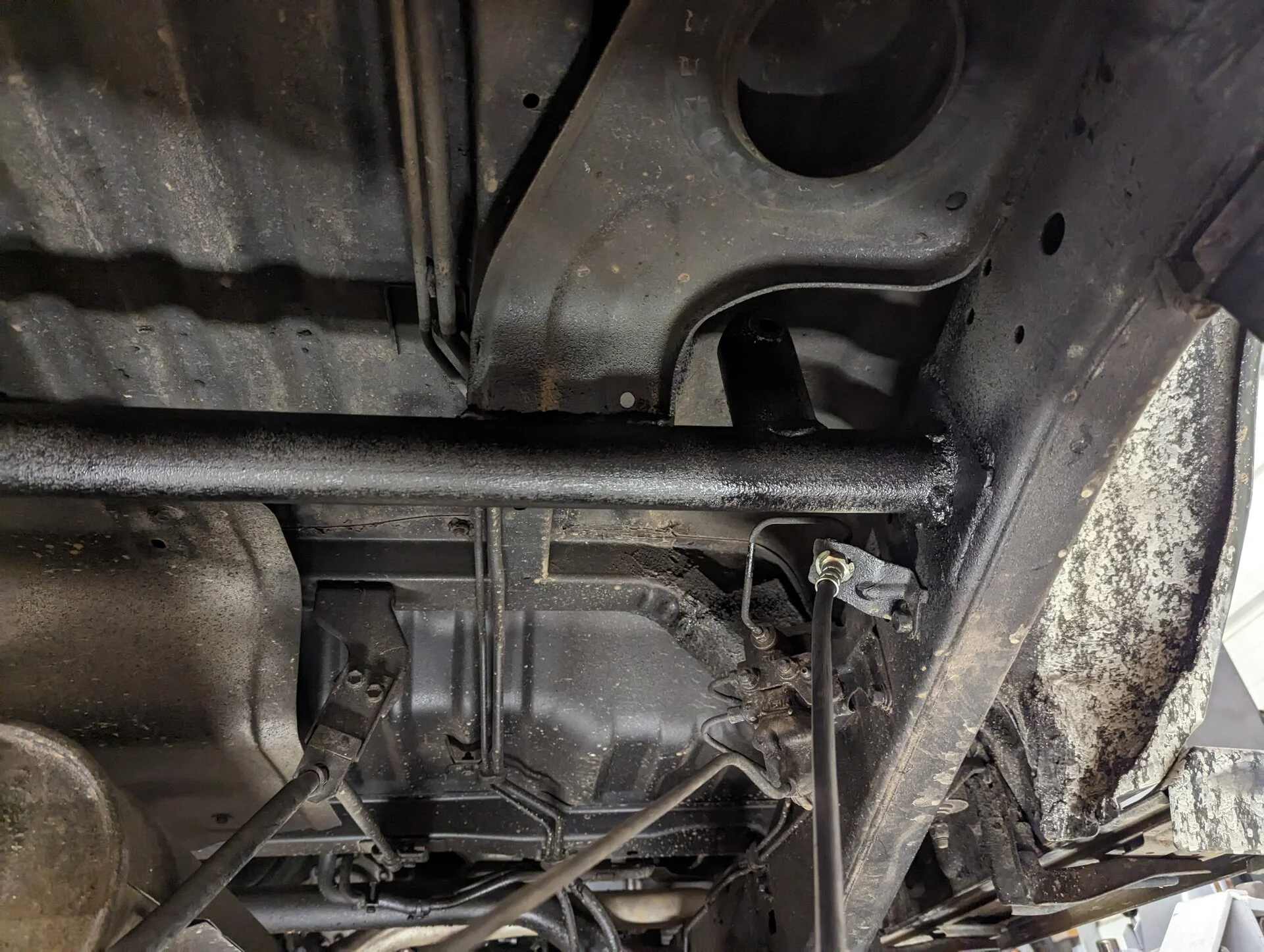

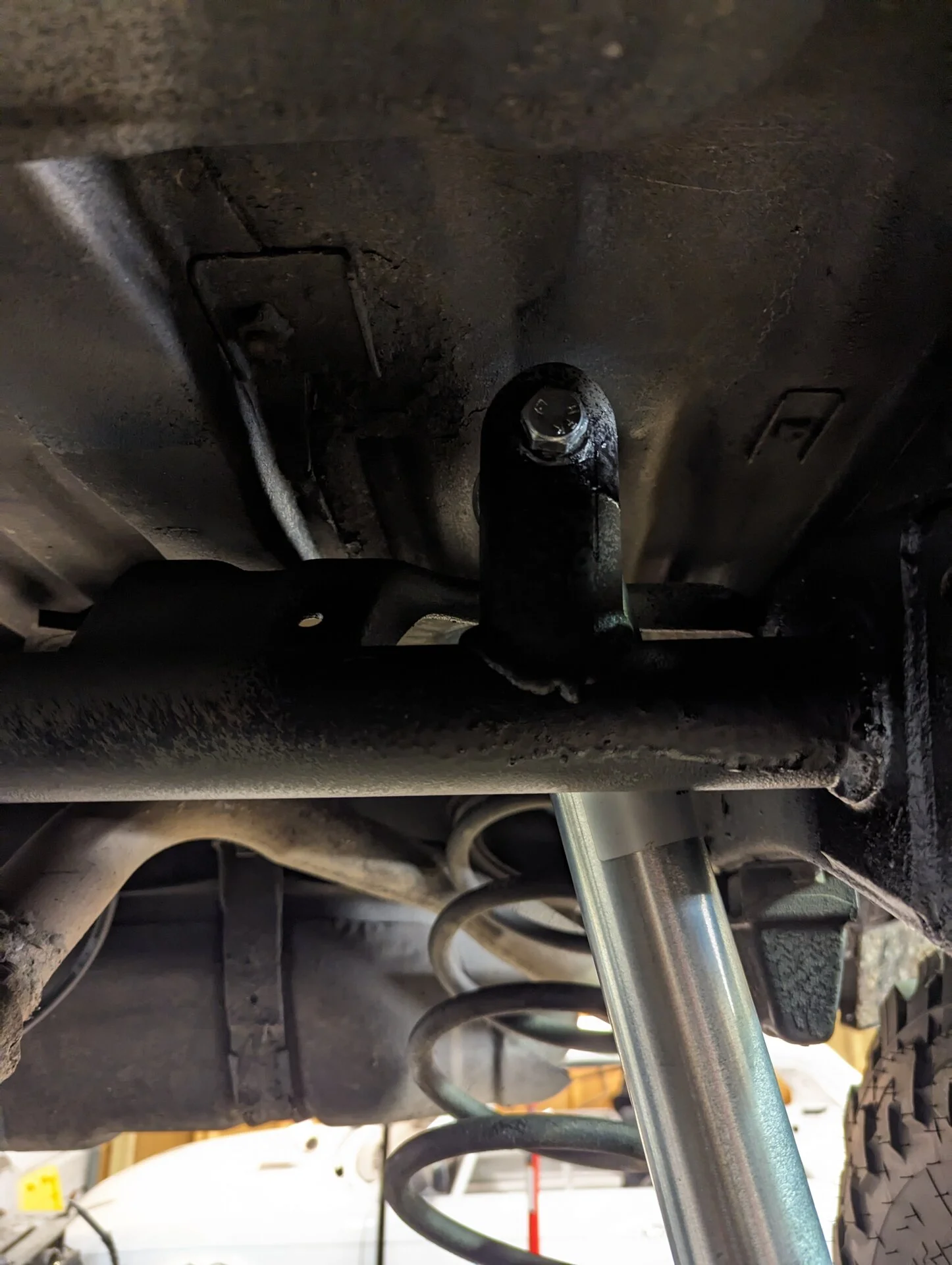

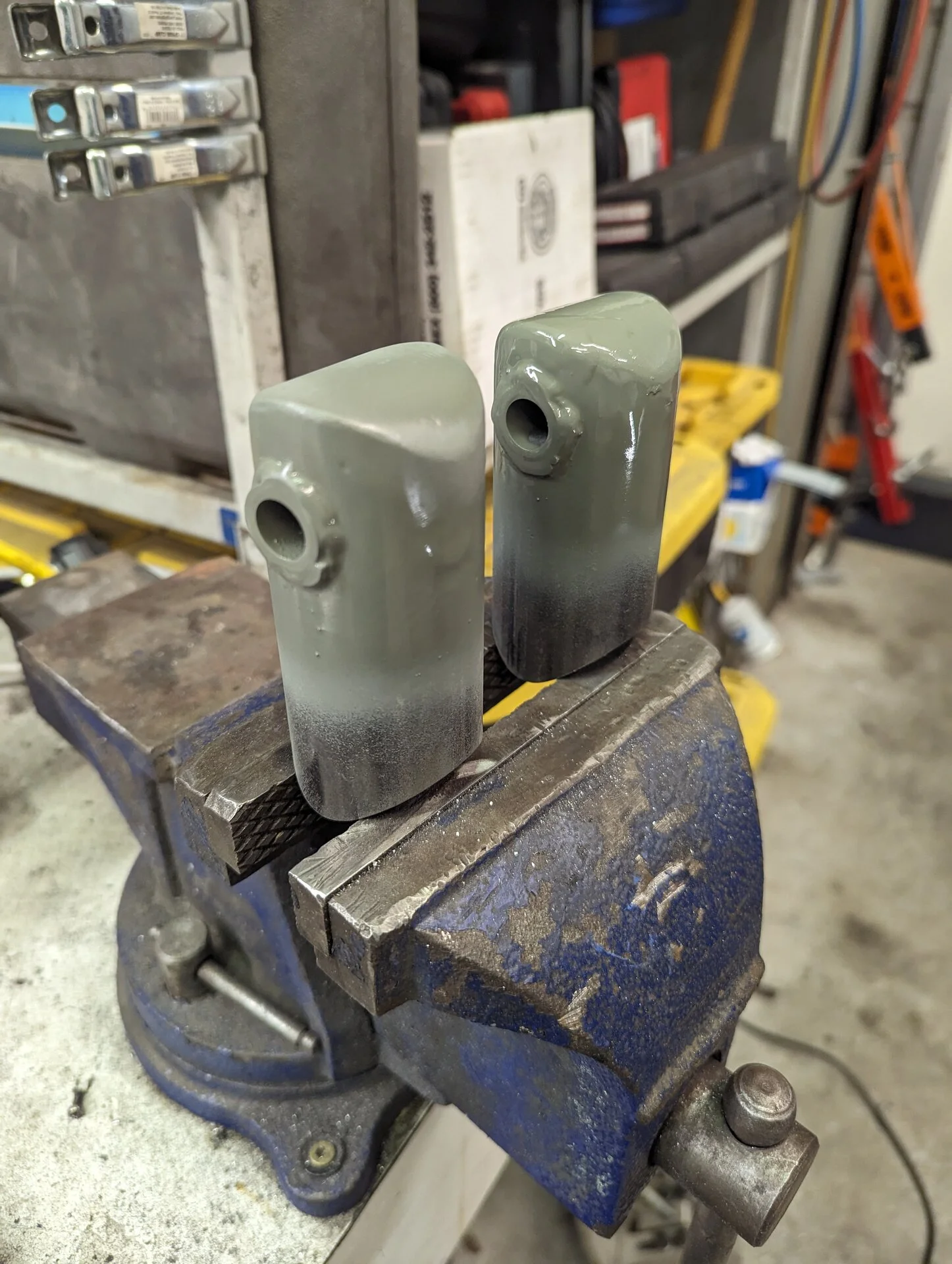

I used a 2" OD 1/4" wall straight section after looking at the frame mounts and spring perches and decided to make my own upper shock mounts rather than bend the tube and try to reuse the factory pieces. Its easy to assume this tube rusted out because the factory shock mount goes through the tube and it wasn't adequately rust proofed inside. Pretty simple fabrication overall but my main goal was to raise the upper rear shock mount 2" so I could use 10" travel Bilstein 5100s instead of the presumably stock length replacement shocks that came on the truck.
Wire brush off the flaking undercoat, weld through primer in necessary areas, then self etch primer and undercoating on everything. I ran some cavity wax through the inside of the new crossmember as well.
Shocks I used are:
Front Bilstein 33313146
15" collapsed 23" extended
Rear Bilstein 24238885
14.9" collapsed 24.6" extended
