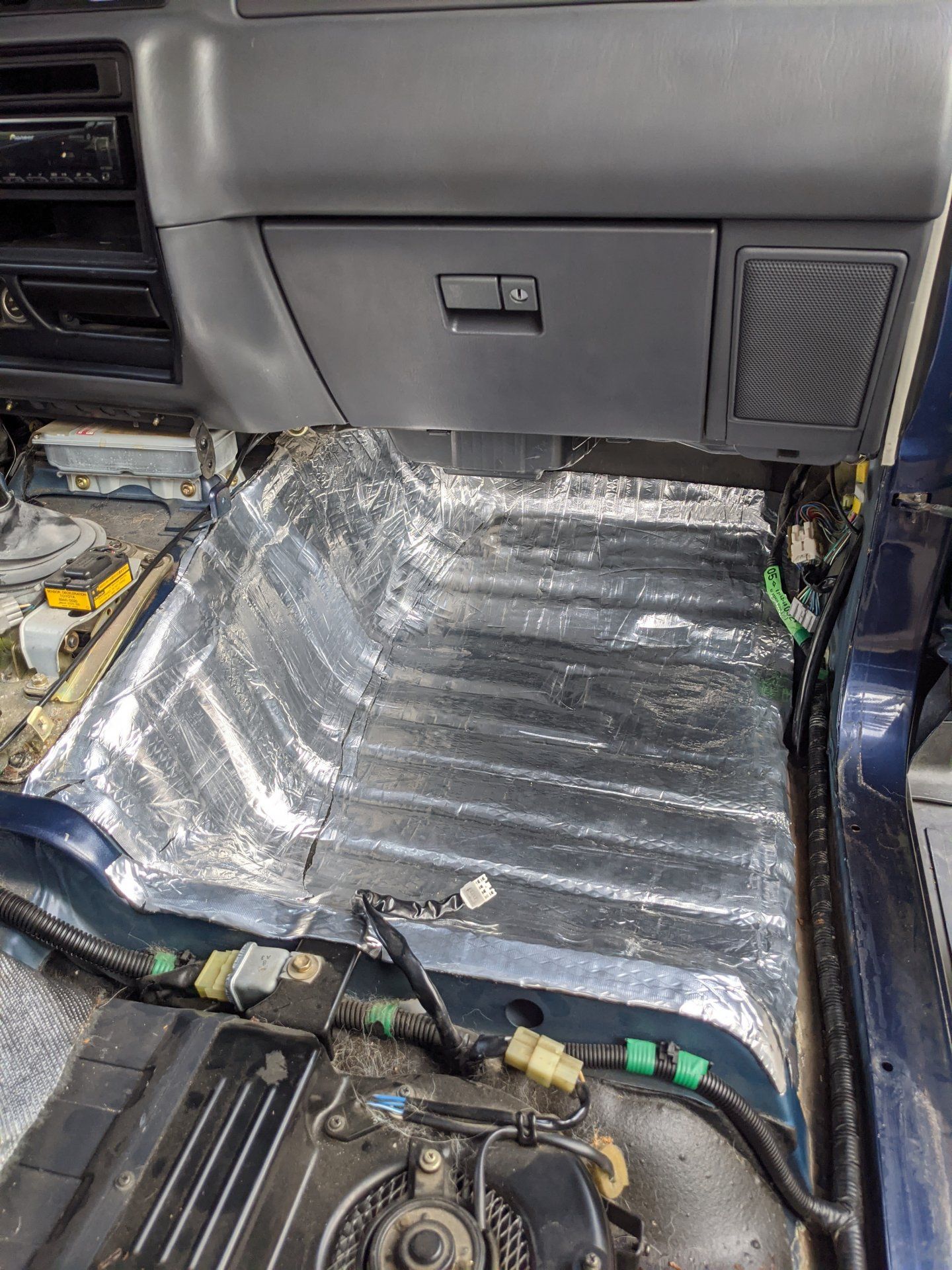

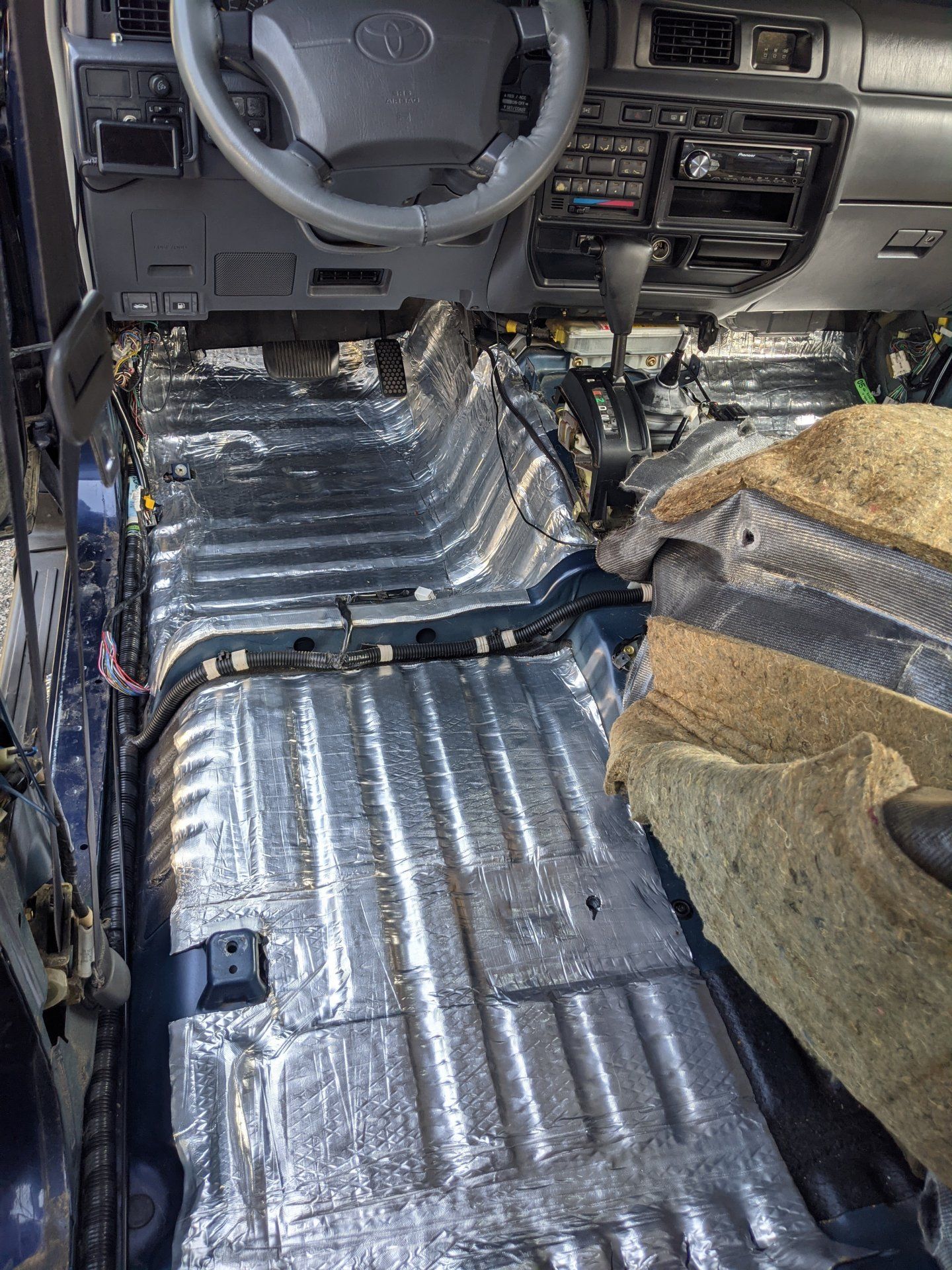

While the seats were getting re-upholsered I lined the floors/ doors and quarter panels with sound deadening/ thermal barrier.
It significantly reduced outside noise and also keeps the center console from getting as hot.

I did the sound deadening myself (when the seats were out getting re-done) My friend in San Diego did the seats and I can send you his number if you'd like. Happy to help and answer any questions. we can take it off the build thread and move to a conversation.

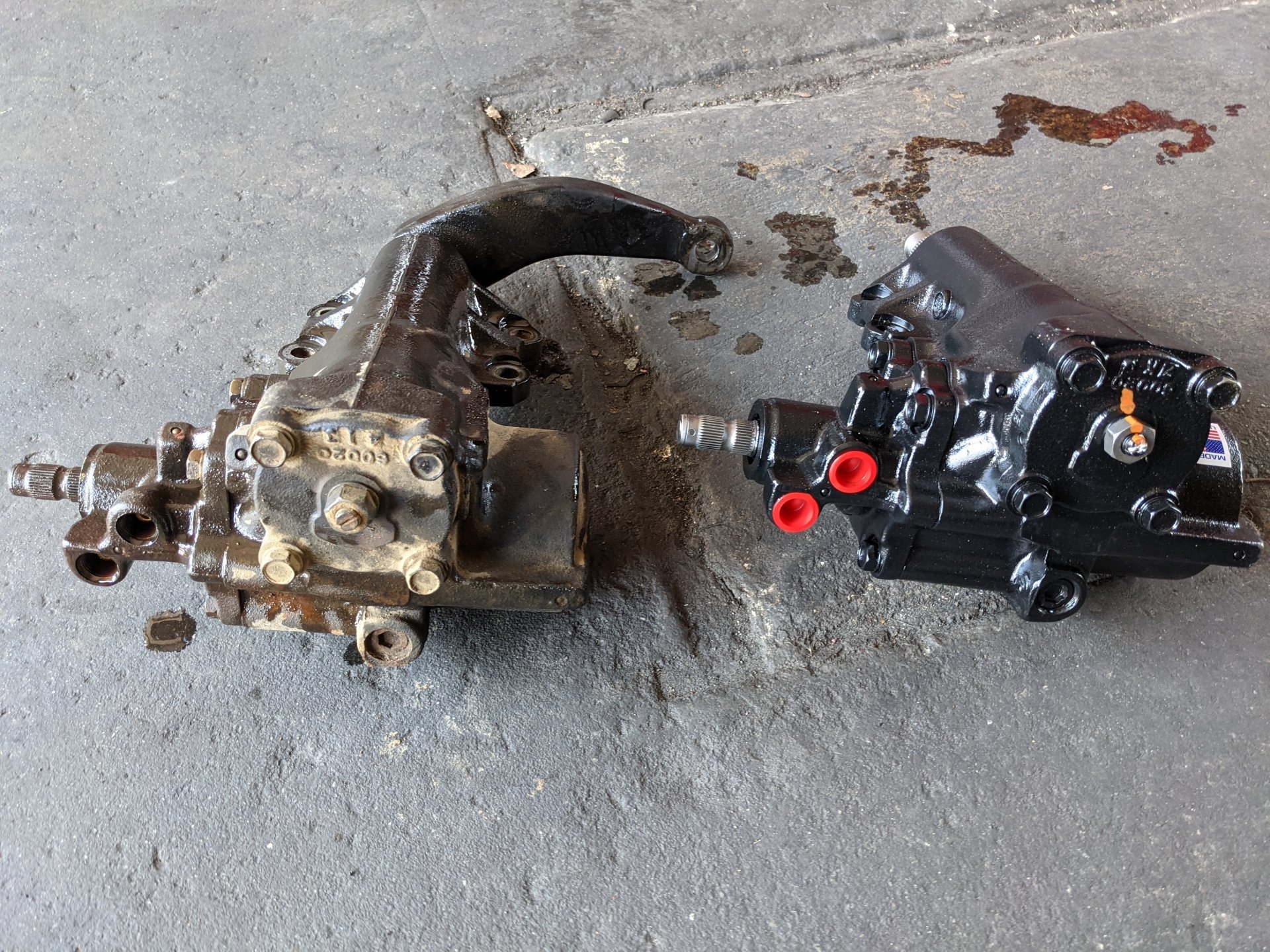

Made steering feel responsive and turns the 35"s with ease.

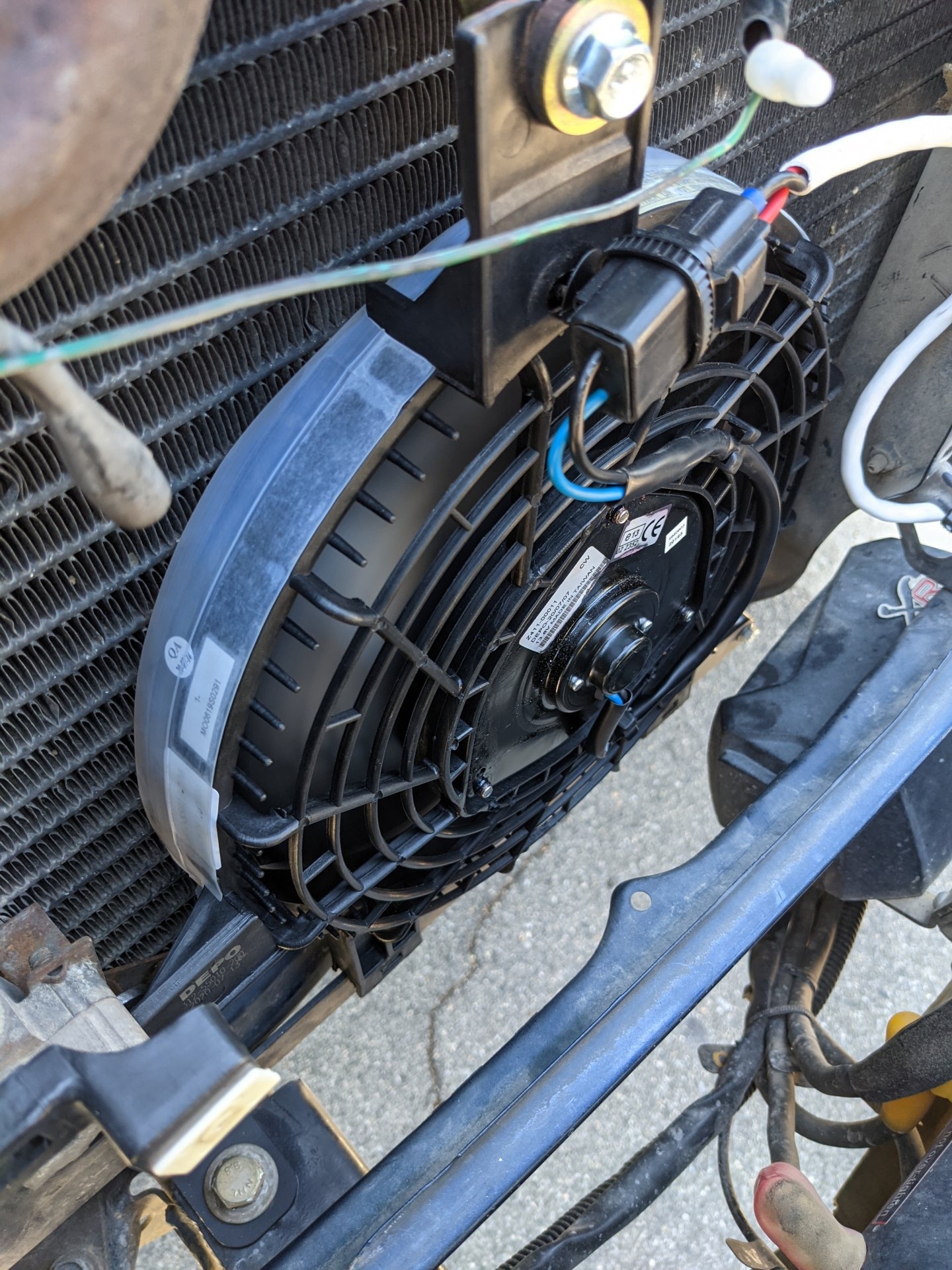

Added the LCP aux fan kit, along with the yodateq gull wings

This fan will not help at speed, Low speed rock crawling or stopped in traffic. I'm running the same one.
When does it help? Just with the engine off?

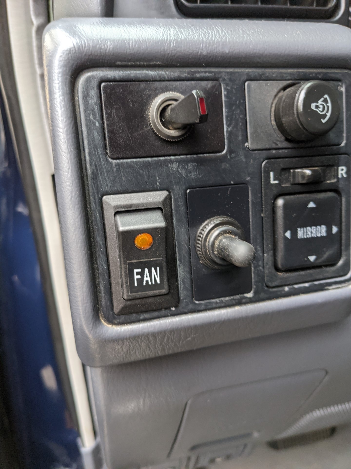

when you going 5MPH or slower, Like sitting in stop and go traffic or low speed rock crawling it helps keep the AC colder. I do have mine wired so I can run it with engine off to help with heat soak.
Did you add yours to help the AC or just to keep everything running cooler under load? My AC hasn't been tip top for a while.
Not to help with engine cooling. Engine cooling system in order with radiator, hoses, fluid, t-stat, fan clutch modified, insulation around shroud...etc.
Your AC should be in good working order before adding the AUX fan. AUX fan helps with low speed crawling mainly.
I did the same - I will leave the fan on when I run into a store or even on the trail and stop for lunch for 30 min - helps when I get back in and turn the ignition back on - the AC starts out colder than it did w/o the fan.
- - Its important to get your system (engine temps & AC vent temp) working as intended FIRST, i.e. normal driving and even off road. You want to make sure you don't have another issue. The AUX fan wont help engine temps either. - then add the AUX fan to help keep it cooler when crawling or if you frequent areas that are scorching hot.
