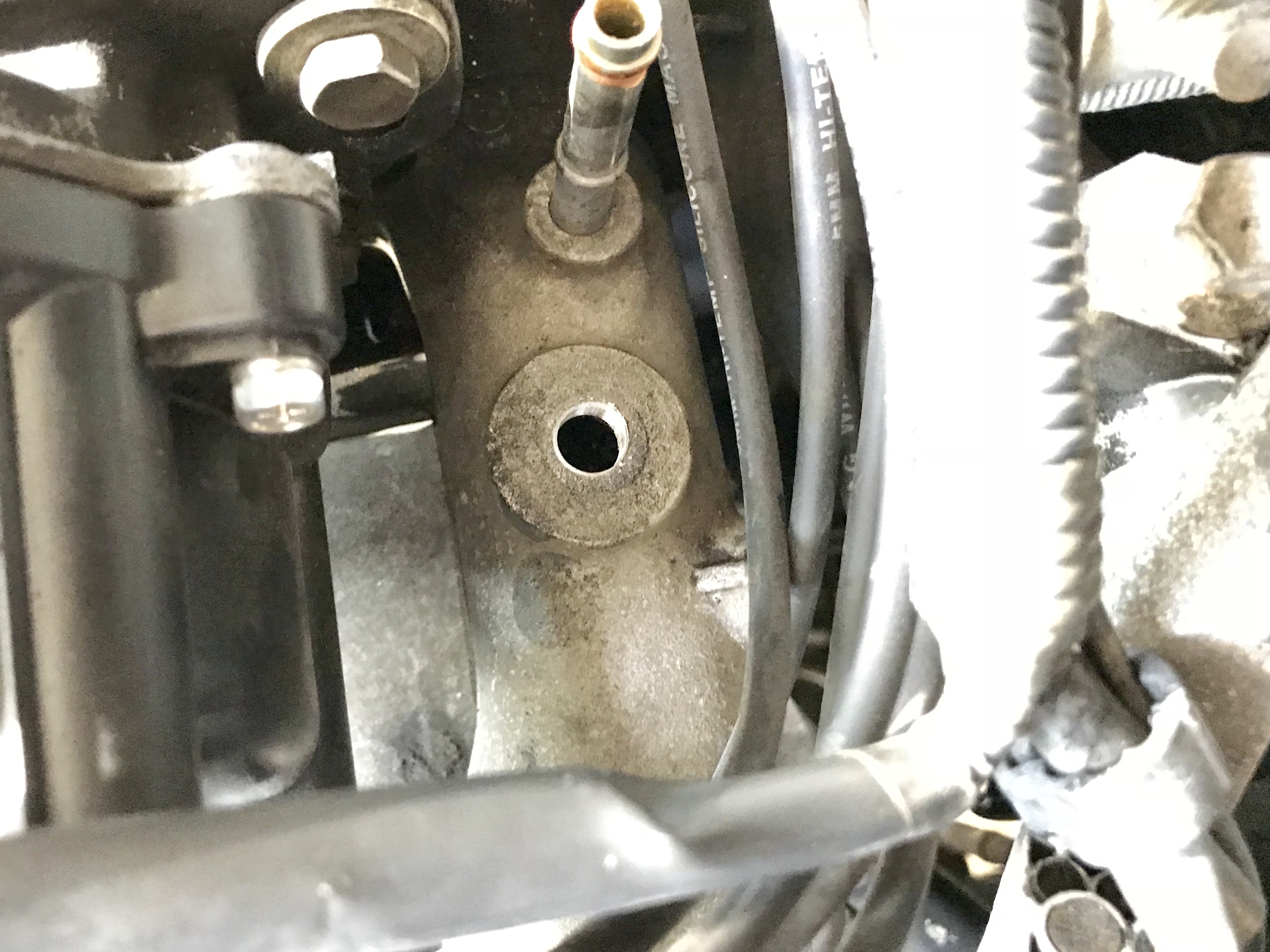

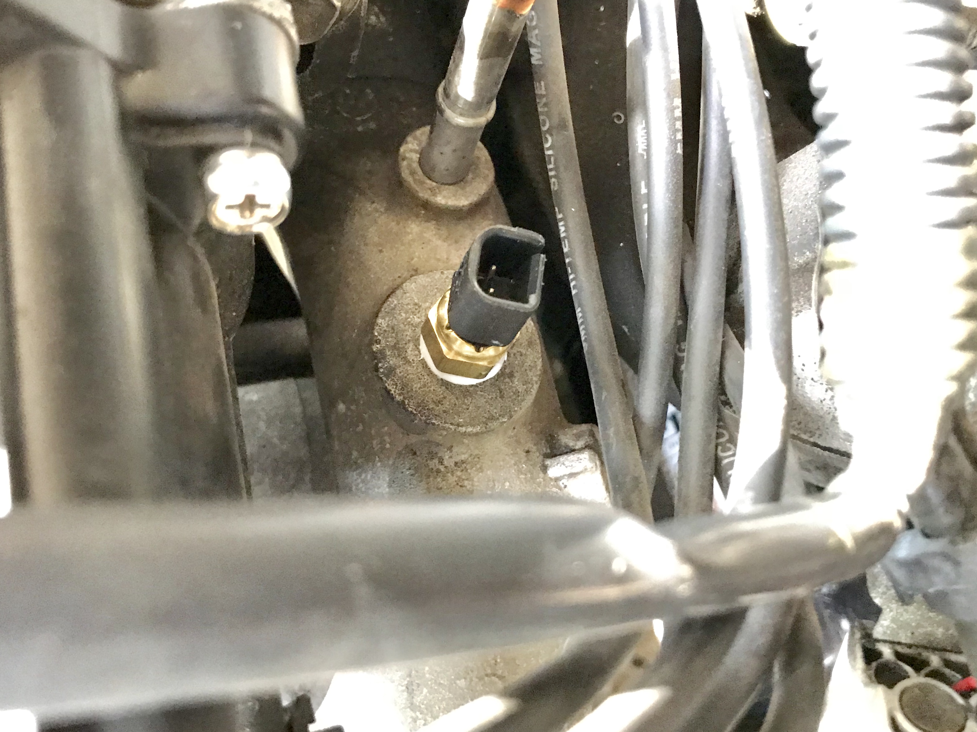

Just purchased the guage from koso. Still on the fence between tapping the outlet pipe or ordering a radiator hose adapter.
Has anyone ran a comparison to what the stock sensor is reading verses the Koso unit? I typically see a 7-11 degree difference between the stock sensor (higher) than the Koso coming off the drivers side upper rad hose.
i run mine at the upper radiator hose and it has worked for me for most of the winter and now beginning of summer. Just 1 thing to consider tho with the sensor in that location; the sensor tends to heat soak in long slow wheeling condition and it will read high, mainly because the Koso sensor is a 1/8" male BSP, so i had to use an adaptor from male BSP to male NPT to make fit. I have since added a heat wrap/shield around the adaptor and it seems to help with the reading. drill and tap into the water jacket seems to yield better readings.
The stock gauge location will yield hotter readings until the thermostat is fully open since the stock sensor is down stream of the thermostat and the Koso sensor is upstream.
Yeah I understand that I'm talking about when at full operating temp, steep inclines loaded on hot days the biggest difference I'll see is 199f from the factory and 187f on the Koso, around town and such it'll be between 191-195f on the factory and 183-185f on the koso
understood...how are you getting readings from the stock temp gauge sensor? Also how are you tapping your aftermarket koso sensor for readings?
I use the Toyobd dongle and app for the factory sensor readings and the Koso is inline on the upper rad hose on the drivers side.
