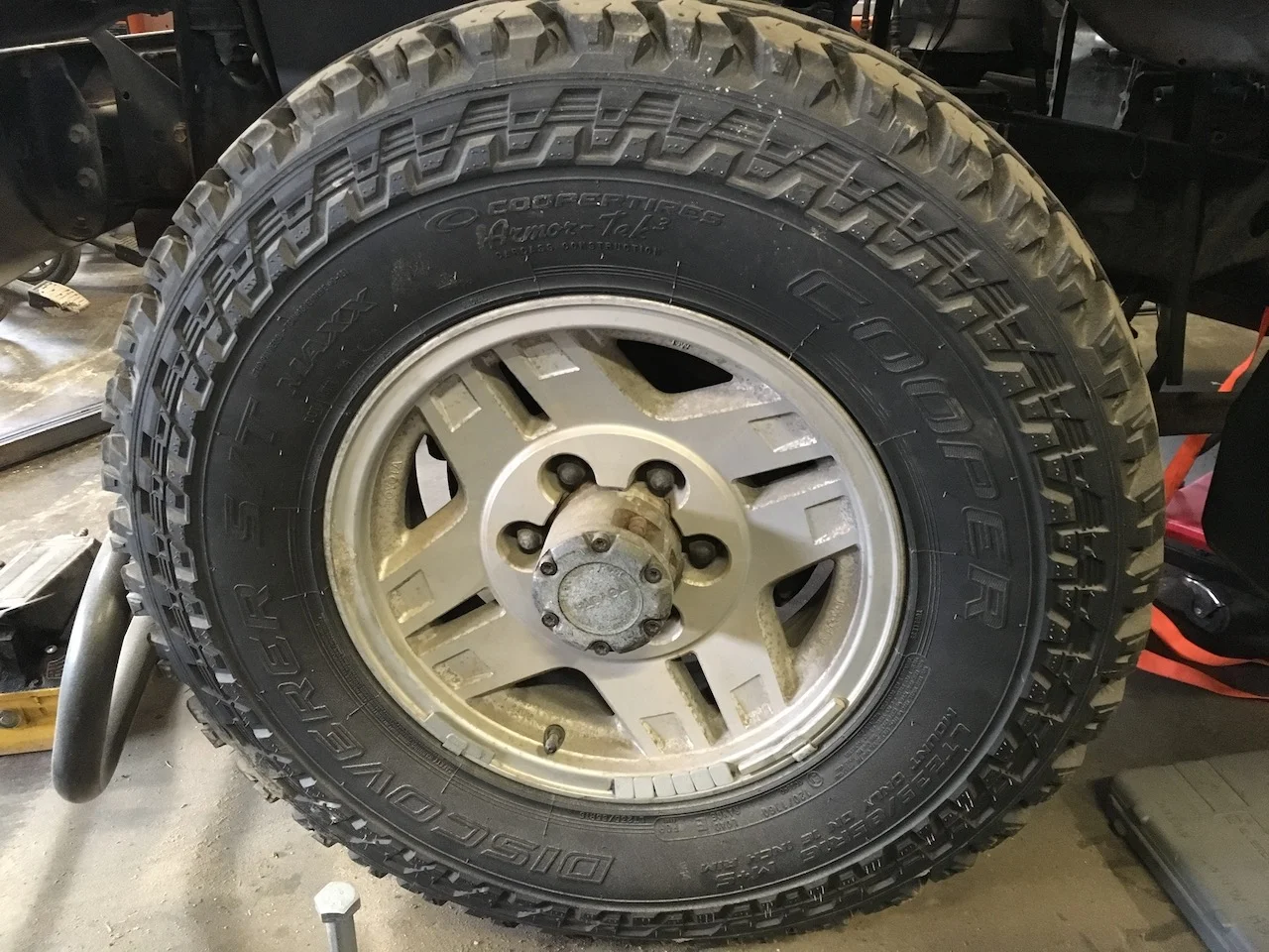

I recently purchased a 96 KJZ78 with 16x7 ET 15 3rd gen 4Runner wheels with some janky Chinese 1 inch spacers. I don't think the spacing is correct. The spare is an original (I think) 4-spoke 15x7 ET -20. I'd like to go to all original 4 spoke wheels, and it seems like the 4 spoke design was produced in several sizes and offsets. Anyone know what my original wheel spec is? Much appreciated.
Is this the style of wheel you're looking for? These came stock on the LJ- and KZJ78, it is a 16x6 ET 0.
I think kzj78 got that style in 15x7. Lj78 are 16x6 as mentioned. So your spare likely is original to your Prado.
