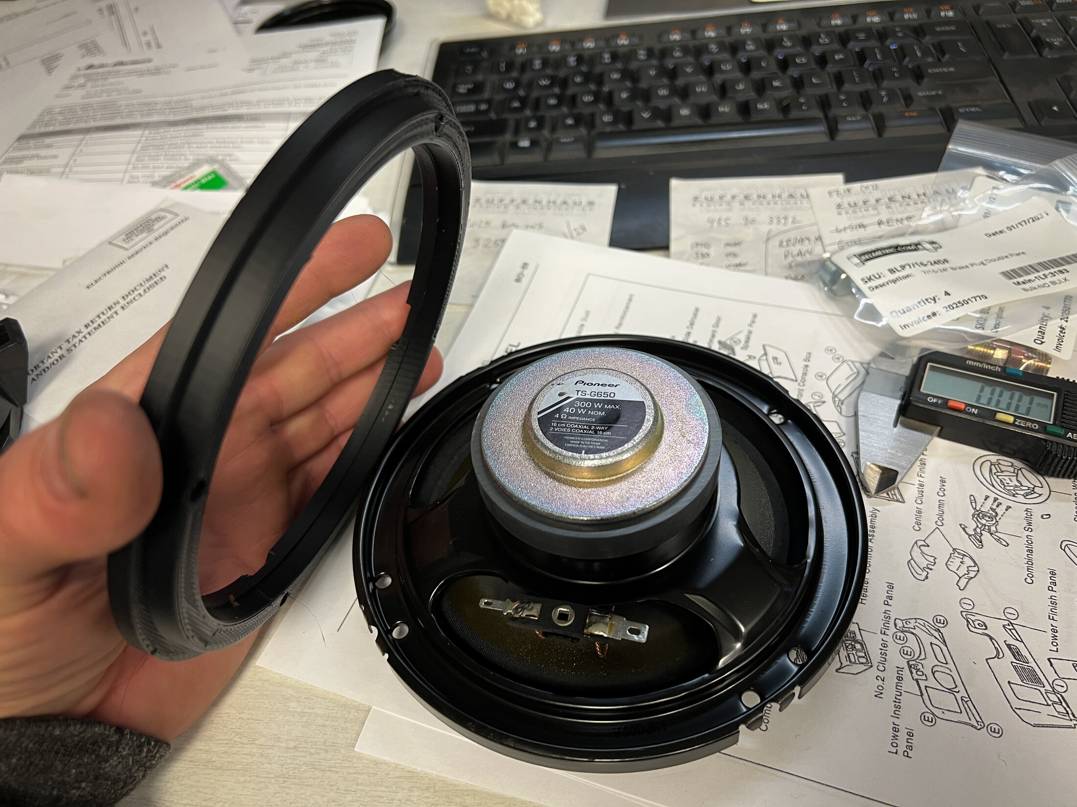

Also, earlier in the week I printed some spacer rings/mounts to move the Pioneer speakers off of the window tracks on the front doors. Hopefully everything clears the door card speaker grilles (prefer to run factory grilles).
