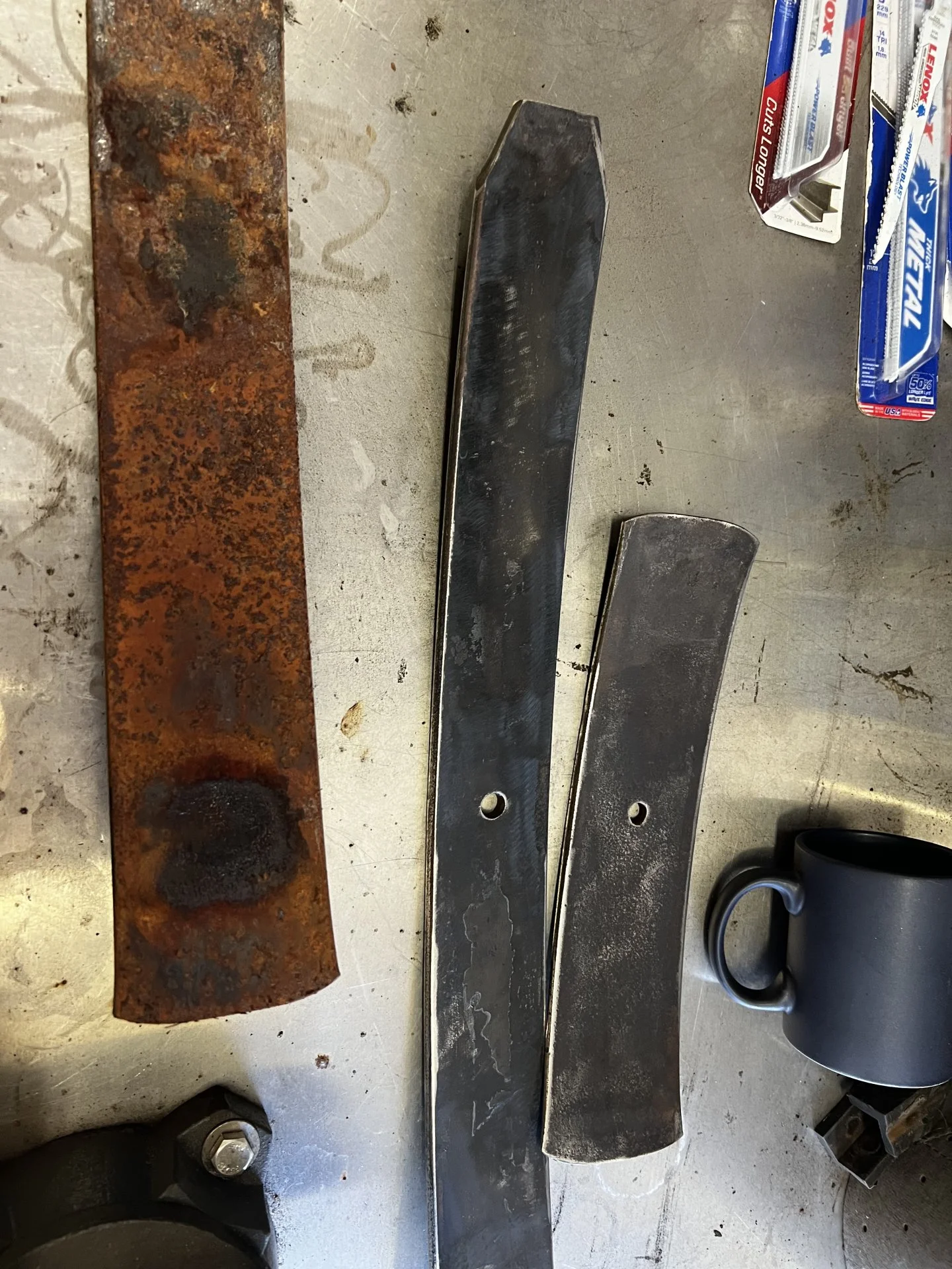

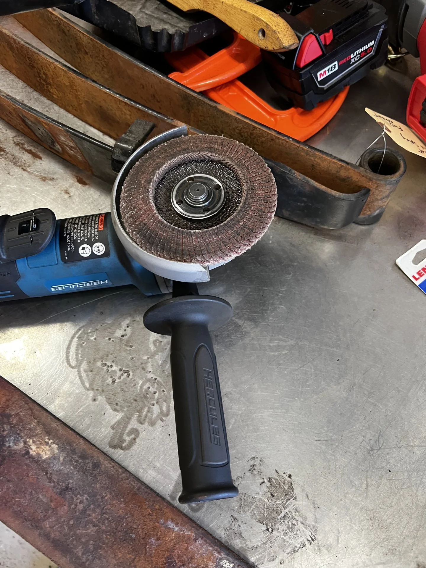

Started the one set of leaf springs today. Lots of grinding. Using a flapper disc works the quickest.
Don't remove the motor mounts off the frame. My 3fe dropped right in with a slight slot of one mount and some existing motor mount bushings I had lying around. People use graphite paint avail at farm and home stores on the springs.
