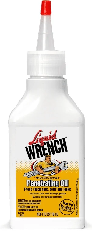

I will likely use the liquid wrench method to loosen the screws and apply grease so the don't rust again, but in reality I should never need to adjust this since I have completed my build.

Just curious what your calling the "liquid wrench" method?
Separate question; what kind of metal is the KDSS valve made of? Does anyone know?
I think he means this stuff, or similar...
