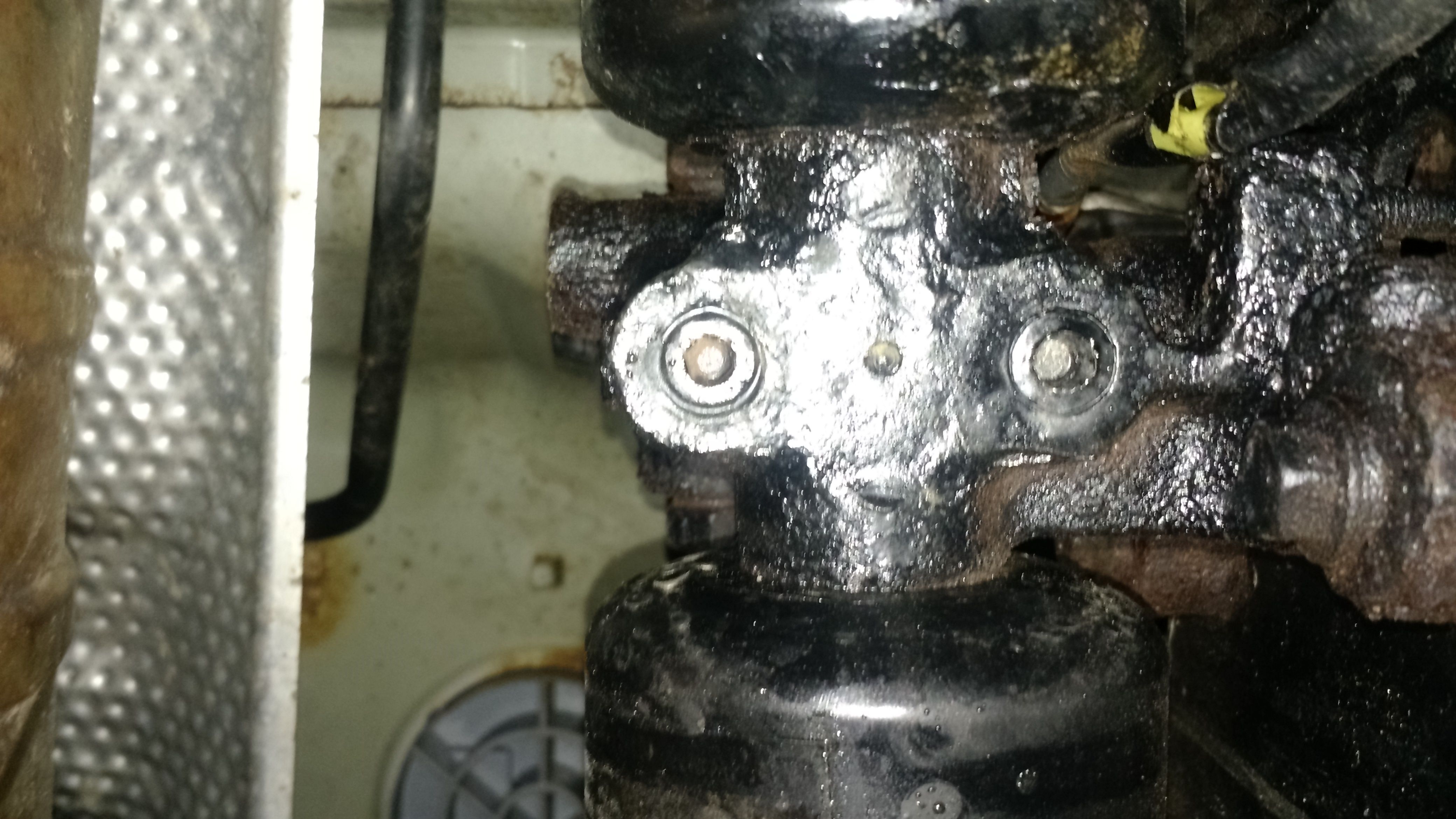

So i took the cover off...which it doesnt look like the shop actually did since the cover bolts were lightly rusted on....
The valve screws themselves actually werent rusted at all. Hard to tell from the pic with the flash, but the left valve screw (in the pic) actually had a layer of paint over the bolt edges. This quickly scraped off and I was able to turn that one with a 5mm allen socket. Turned really easy after a little PBlaster.
The OTHER one (right side) is mangled, and apparently was the one the shop had trouble with. It is stripped, the 5mm allen socket doesnt come close to fitting, just spins with no purchase. Ive soaked them both in penetrant and am going to try to tackle the stripped one tomorrow. Planning on hammering in a one-size-up (6mm if its enough) allen socket in and trying that.
Was pretty disappointed with the shop after the first one i tried turned so easily and clearly hadnt been touched since it still had the paint around the edge...makes me think that the other was probably fine before the shop started messing with it.
Hoping i can get the other one loose tomorrow.
Instead of another allen bit, you might want to try hammering in an appropriately sized Torx bit. It would probably be easier to hammer in further than an allen bit, and would allow more purchase area to avoid further stripping.
Just a thought.
It's great news you only have to deal with one and not both.
HTH
Good tip...ill try the torx bit instead. Have a bunch here, so should have something that will work.

Heh. I was JUST about to suggest a torx bit and then saw your post. Seems it might bit/cut in a bit more and possibly grab more and with more "teeth" than just a bloated allen.
Torx strip easily if you apply too much pressure. Just a word of caution. Been there done that.
Can you cut a slot with an angle grinder and then back it out with a large flat-head screwdriver?
I tried this with no luck.

Question for you guys who are able to back out your KDSS valves. Is the bolt threaded on the end that protrudes past the body of the valve?
I'm thinking the threads on the bolt itself are somewhere inside the accumulator and maybe the rust is has fused the outside of the bolt to the accumulator body.
Do any of you know if it's threaded ?

another thought, if the threads are internal, can you try wire brush/ sander to remove the top layer of material from the plug and housing, then use the penetrating oil?
