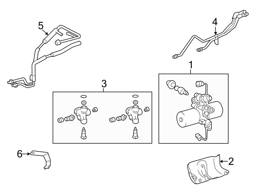

Thanks for the responses, going to look around for a replacement valve. Anybody have the Toyota part number off hand? 4800660023 sound correct? So, #1 in this pic? (Hard to visualize without the truck/part in front of me)
