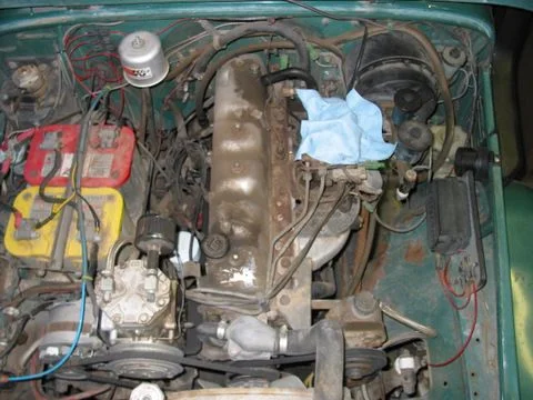

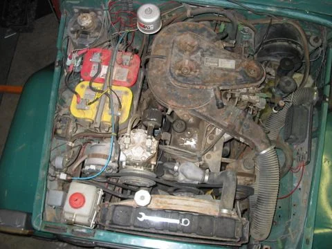

Minor updates today. This cruiser showed up yesterday. I spent some time today removing a few parts and sizing up the engine bay. Not as much room under there as there is in an HJ61 so I will have to get a little creative.
Looks like Ill have to rearrange the dual battery setup and put the batteries end to end. The york that is on the 2F is going to be installed in place of the stock compressor on the 12HT with a new bracket. The 40 already has saginaw steering and it looks like the steering shaft is going to be close. Not sure where the air cleaner is going yet.

The engine itself should be straight forward - its all those darn gadgets stuffed in there with it...
I was planning to try to keep the batteries on that side because the 40 already has a snorkel on the drivers side. If I can work it out I will remove the air intake crossover and put an air box on the drivers side between the snorkel and the turbo.

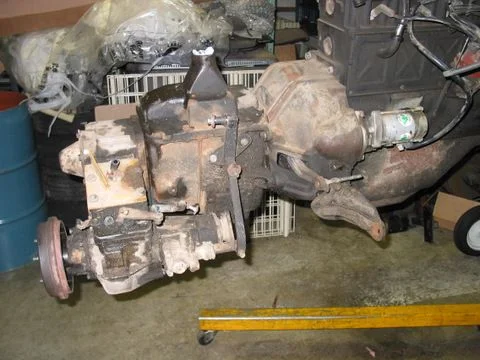

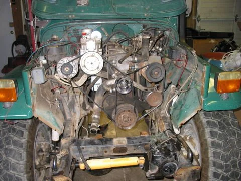

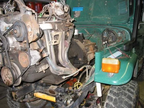

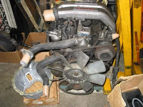

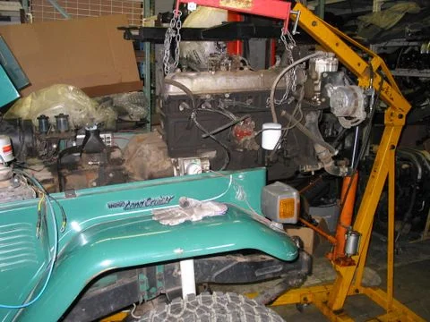

Now its on to cleaning up under hood and moving forward with test fitting the engine and trans. The engine will get a new rear main seal, then mated to the H55 with all new clutch parts and a new bellhousing.
A few pics of the 2F and 12HT. The trans that came out is an SM465.
