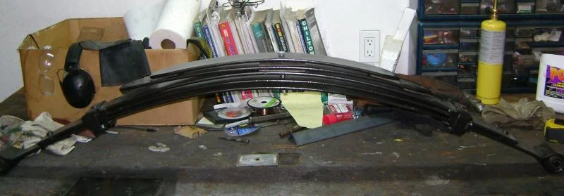

Went to the jy Monday and picked up 2 Blazer rears and one S-10 rear. Went back Tues for the 2nd S-10 rear. The S-10's will be the main pack, with the other 2 Blazer springs cannibalized to add spring rate. For 5 springs, I figured the rate at 257 lb in, I need to compare that to stockers and then to OME heavies.
1. Here's the packs mocked up. Starting from the #2 spring, the leaf length will stagger 5" to 4" to 3" shorter each successive leaf. Note the pen marks for each cut, if it helps clarify my plan.

So, thats the front SPRING hanger correct? Are you mounting the shackle below the frame in the rear?
I'm gonna give my two cents here. I've been down the road of long shackles and obnoxious hangers that drag on everything. Truth be told, I eventually went back to a six inch long shackle that sat in the frame, not below it and stock height hangers for the reversal on my FJ40. I had 4 inch lift springs on it for maybe two years and then I finally listened to the hardcore guys and sprung it over. I will never go back.
On my 62 I kept it simple. OME medium (Upgrading to heavy for winch) including their shackles and 31's. If I ever want to go bigger (part of me does) I am going to spring that over too and run some 35's with a hybrid flat spring pack (keeping it as low as possible) and sell the OME. I probably won't do a shackle reversal on my 62.
A lot of people take your route for money savings and most of them end up redoing it.
Dan
Yep, that will be quite the rock anchor, won't it? It turned out very similar to MAF's 4-plus SR kit, obviously. And yes, the rear hanger will weld under the frame. I'll start testing the resultant caster and spring motion with just the 4" long OEM S10 shackle I pirated along with the springs. Then, I'll build a permanent replacement of appropriate length.
This project is about specific compromises I'm making. I came back to this idea hastily as a response to a recently broken stock spring pack on my DD'd 62. Being needed for daily duty, I feel I can't leave it sit on stands for 2 weeks while I do a proper SOA. By 'proper' I mean frenched and or very short spring hangers, nearly flat springs, etc.
Not going spring over and wanting to use common JY springs leads me to two choices as I see it. Stupid long hangers or welding a zero-rate block ( or two) to the perches. (Well, a third choice could have been to simply replace with used OEM springs, but I decided that was too simple:doh: hehe)
For it's intended use (DD, hunting rig, and moderate wheeler) I'm hoping I'll be able to stand the way it turns out. If I get a year or so of acceptable performance outta this current mess, then I'll be satisfied.
