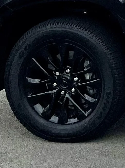

The previous owner had painted or powder coated the stock rims black which I thought I wouldn’t like at first, but I’m really loving it the more I look at it. It goes with the car. :)

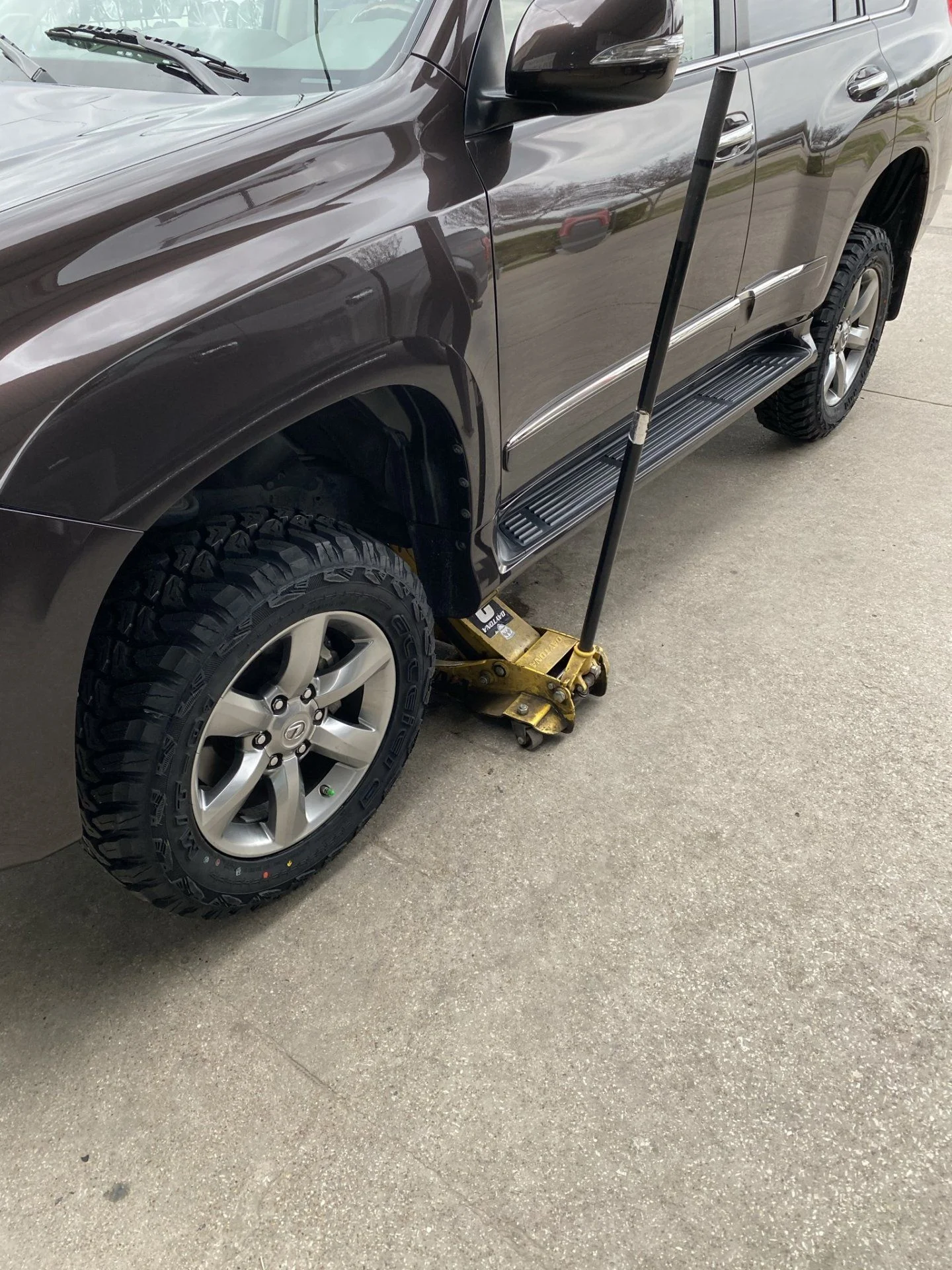

If you wan to see how my rig sits with those size tires and 3" suspension lift, here is my build thread: Builds - R2M 2013 GX460 Overland Build - https://forum.ih8mud.com/threads/r2m-2013-gx460-overland-build.1104719/
