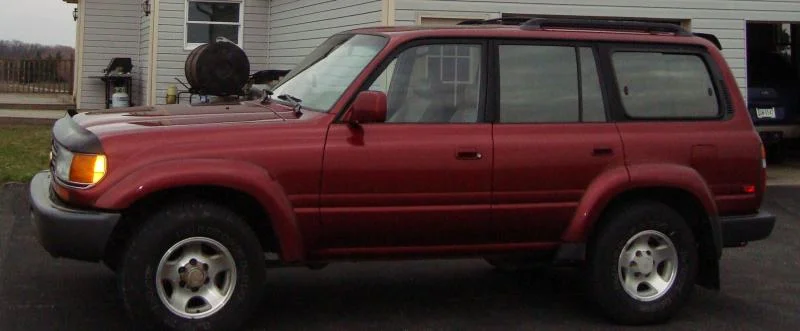

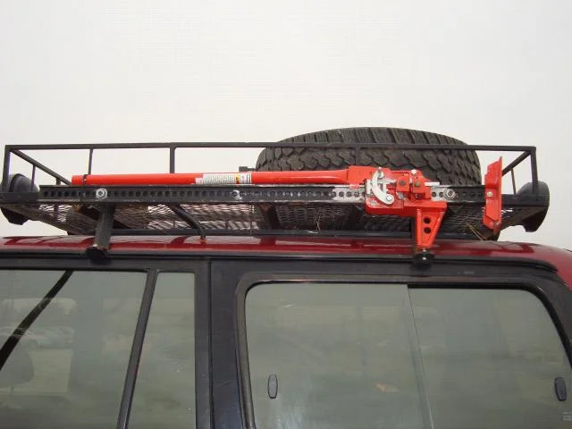

Here's a few pics of my rig. The first is a before (the only one I have, after I took the running boards/front flares off).
Where's the after pic?
Sorry, I'm at work and it took me a min to format the pics.

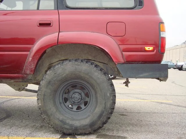

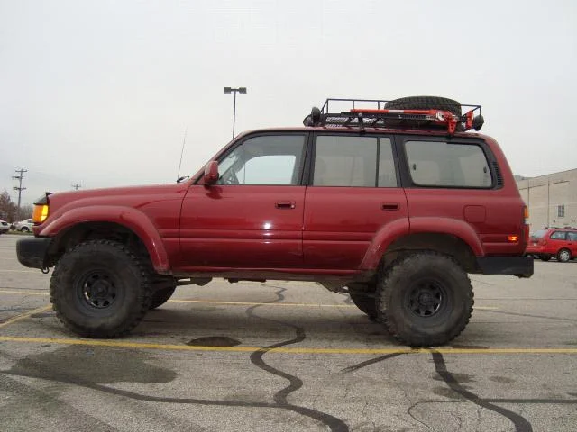

After the lift, tires, home made bumper/roof rack...
And I meant to say mud flapps, not flares, haha

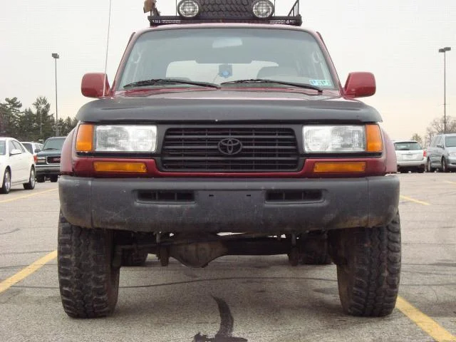

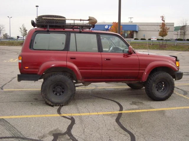

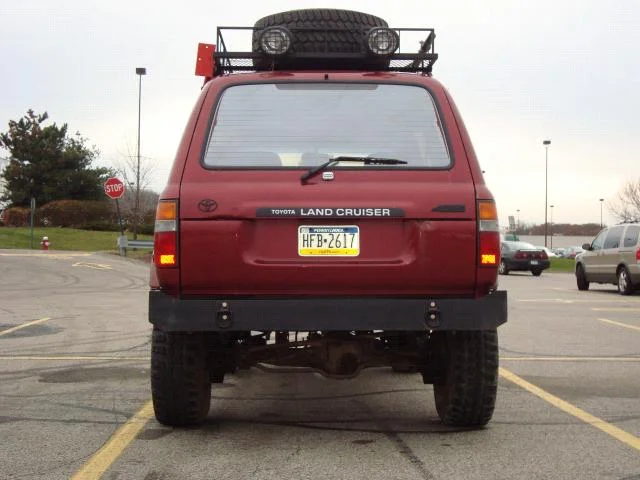

Some more
One More....
I painted the grill/headlight trim and the emblems on the tailgate with truck bed linner, as with the rack and bumper, I love the stuff, but I don't think it turned out bad, better than the factory gold kit, haha
