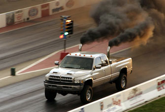

With a 6bt you also have to think of all the smoke you will spray on unknowing victims on the trail.
One young lady with contacts learned that you don't follow a 6bt in a jeep with no top.
I don't know where this originated from "if you have a diesel get ready for black smoke everywhere" phenonenom. On both my 6BT's, I rarely see any smoke & if I do it's only at startup & is barely a *puff. :confused:
