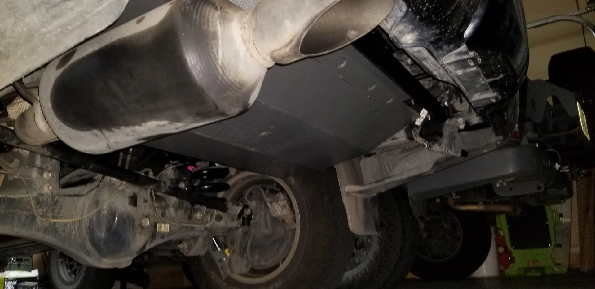

All good points from r2m. If you do the aux tank from LRA, you will want to factor that weight in as well. When we installed the 24 gallon tank on our 200 series we upgraded the springs at the same time to compensate. Very happy with the product and the extra range (especially the peace of mind that goes with it). We typically run the main down to about 1/4 tank, refill from aux, then gas up. That way we never have less than a full tank of range available. I will put some info about the tank on my build page, since they have similar tanks for the GX.
Thank you for the brain food! I must say I did read your build before even purchasing! I came from the track car building community so I'm no stranger to tools and mechanical work. I did consider the added weight of the tank. Any idea on how much extra weight you are carrying around on average with the tank and extra fuel? The piece of mind is really what I want. 300 miles average is not enough.
The 33 gallon tank assembly is about 100 lbs, and 33 gallons of gas right at 200 lbs, so in total you are adding 300 lbs with a full tank.
Do you run into any problems if you keep it less than half full? I may only fill it all for trips and just keep an extra ten gallons on average to help with weight and MPG's
No, that should work fine. You don't want to run it dry because that can burn out the transfer pump over time, but less than half full shouldn't be a problem at all.
