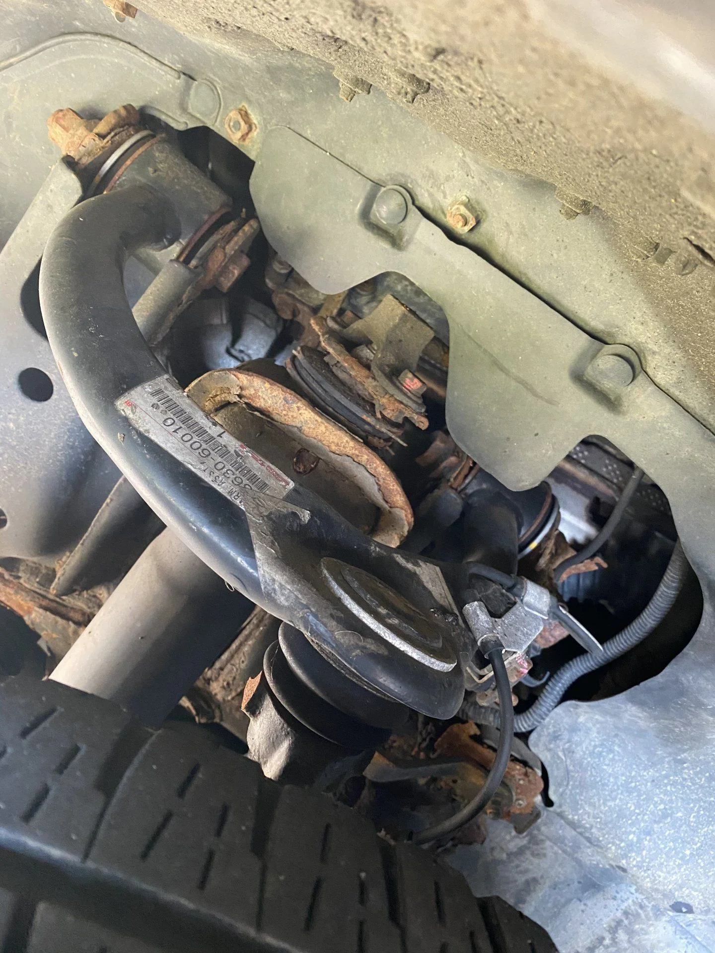

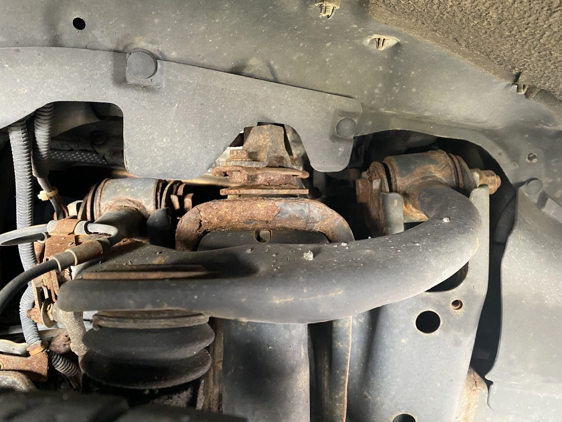

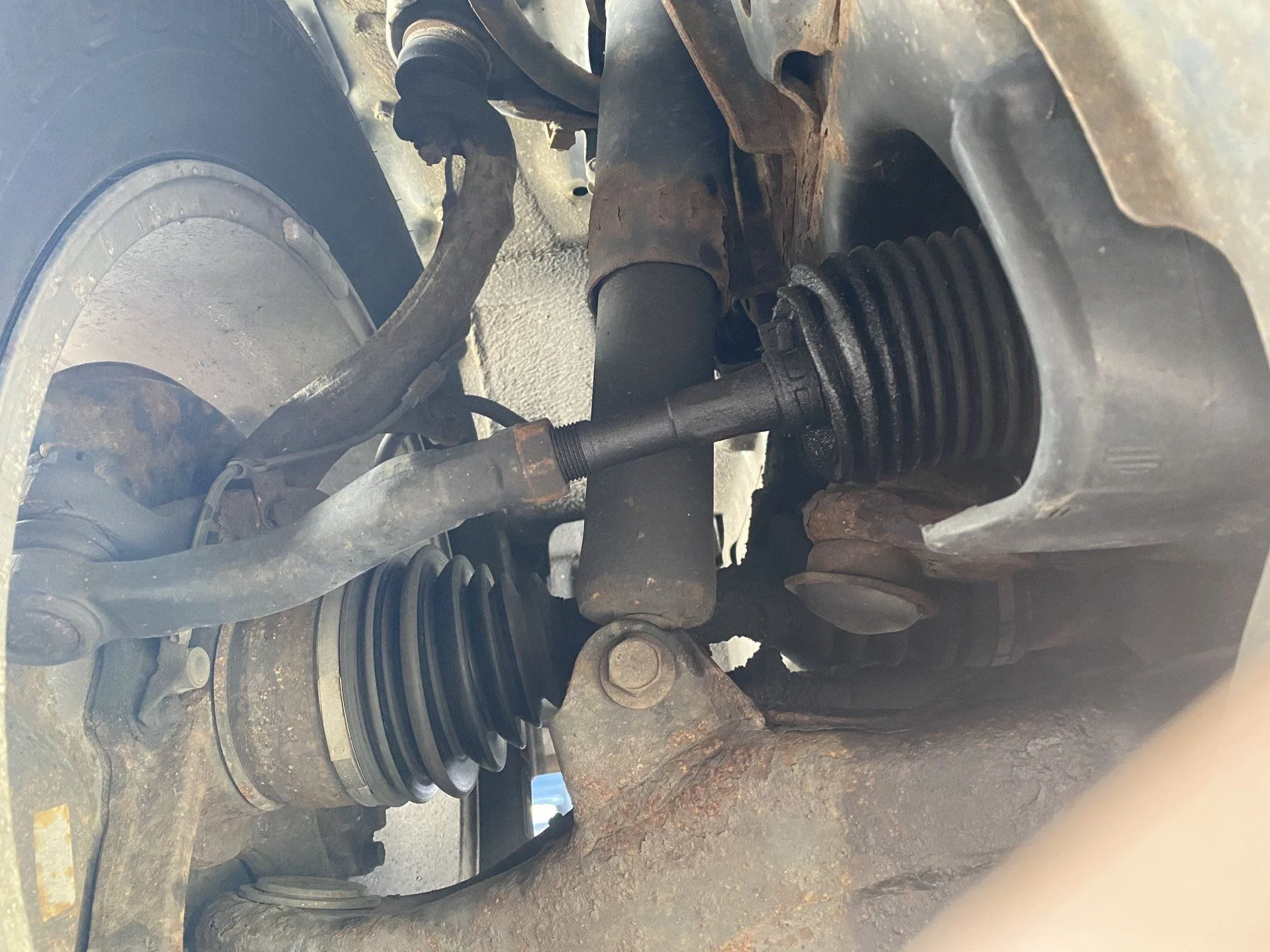

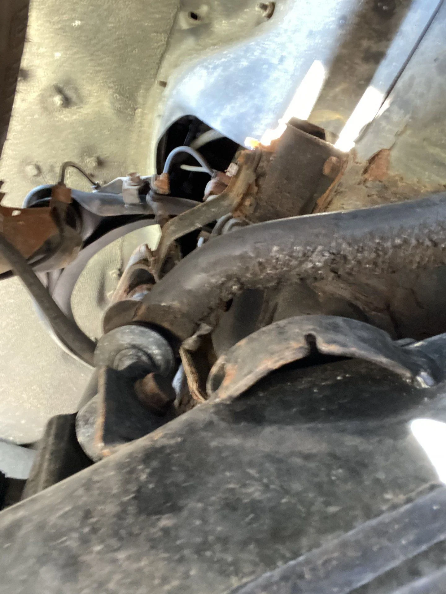

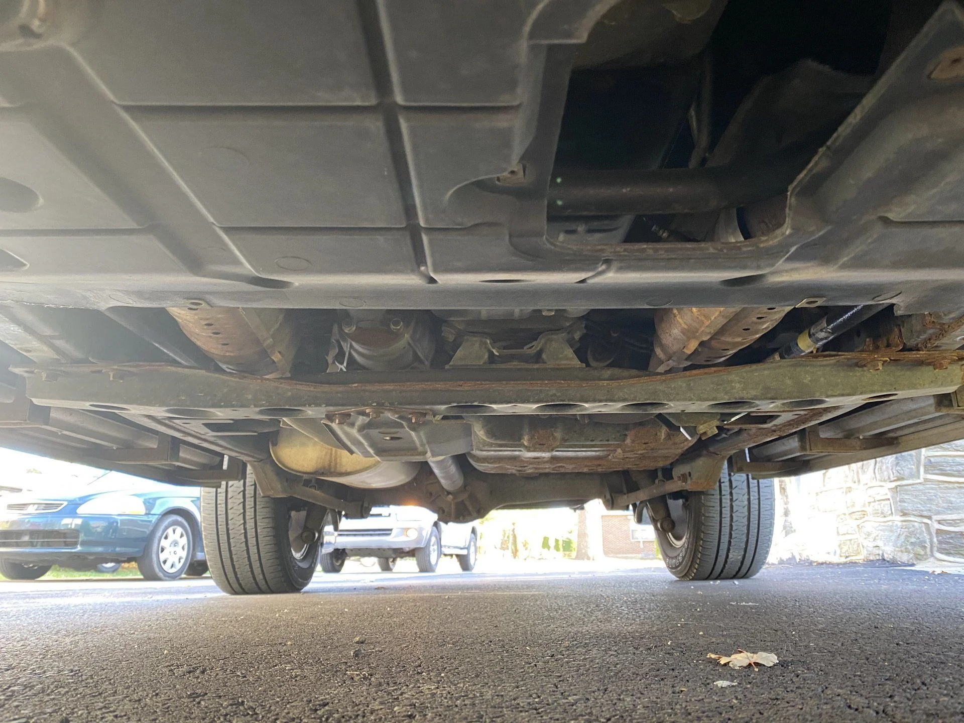

Some under carriage photos (southern owners avert your eyes!)

3a. Bushings, Steering - I find there is a little play in the steering, especially at highway speeds and the steering wheel prefers to be tilted to the right. I’m seeing a lot of posts of people replacing all the bushings at 200k and loving the feel. I would love to do that as my first project but its really hard to track down what parts and all that.
3b - Should I just replace the steering rack while I’m at it? I know, its a big project but if its worth it while I’m down there - it could be worth it.

5. Rust treatment and prevention.
I’ve seen a lot of products thrown around, what are the best options? I want to treat the rust I have and then apply something. I’ve heard Fluid Film, POR-15, and something by 3M. I reached out to Land Cruiser Heaven in Hagerstown, MD for a price on that.

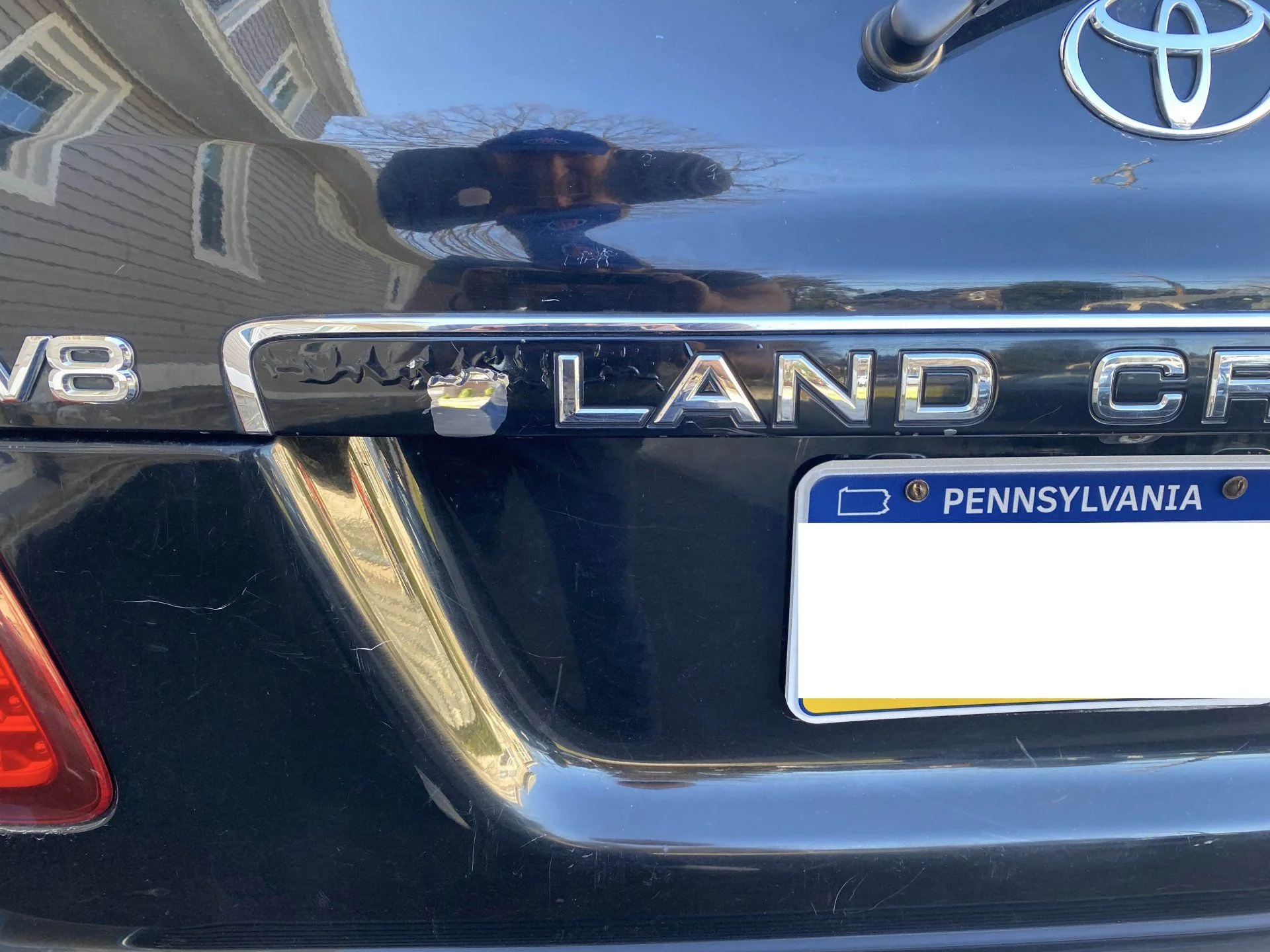

Also, here is the bubbling on the back hatch. Low priority but I'm assuming others have dealt with this:

3. You can only get aftermarket bushings. Toyota sells them with the rack only. This is on my to do list. Have the bushings on hand.
3b. I wouldn't. That's a huge jump in price/labor.
4. Bushings. All of em.

Bummer seeing all that rust. Common in your region, I'm sure, but a bit sad to see as somebody living in the southwest. That's going to make AHC maintenance/repairs quite difficult.
Bubbling on the tailgate is normal I think. I believe it isn't rust and is just the plastic/vinyl/whatever detaching. I just leave it but feel free to replace.

-As a heads up, AHC globes may start going bad soon. Would at least flush fluid, but if you have very harsh ride will need to replace.
-Replace or repack front wheel bearings unless service history says done <30k mi ago. Lots of threads on DIY. CruiserOutfitters has a kit online w parts.
-Replace diff's + Tcase + Trans fluid. First two easy DIY, trans is done using internal pump through cooler lines, a bit more involved, may want to just do some drain and fills. --Actually just do all fluids in the vehicle. Brake, Coolant, Power steering
-***Important*** Heater T's
-Rust: Wire brush and fluid film/POR/whatever everything you can.
-Spare tire winch: Drop it and grease the heck out of the system. Likes to rust up. Don't wanna get caught with it not working.
-Exercise the H/L shifter frequently, likes to corrode and seize up.

Yep, that's the plan for the bushings. I'm having a hard time narrowing down what part numbers and all that, I'm going to spend more time tomorrow. There seem to be a handful of threads but I haven't found a good one with all the numbers yet.

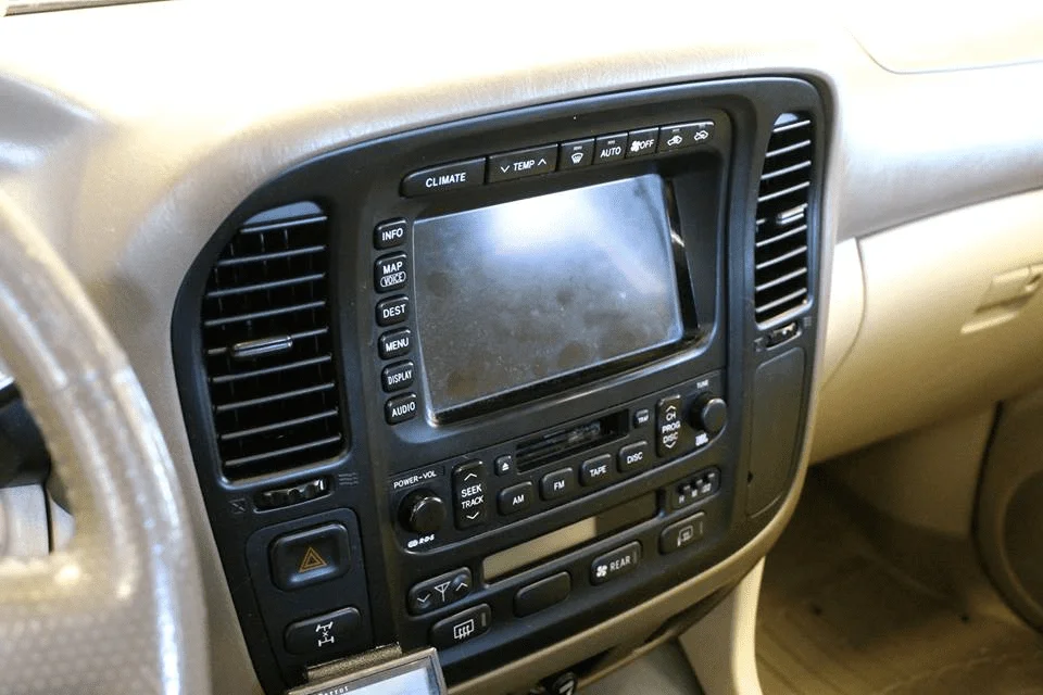

If it's w/nav, you'll have a head unit that looks like this:
We're just outside the Carplay party (available in '03LC's - onward) so a full head unit swap would be necessary to get Carplay integrated. I'd recommend checking out the thread for pre'03 nav-delete. Even though I'm a fan of learn-as-you-go, splicing in 56 individual wires to do the delete was too much for me.
The Grom unit plugs into the CD/DVD port and lets you control from the head unit or your phone. USB charging and Aux are bundled as an add on but you could easily skip it with 3 cigarette ports nearby. I end up using the wireless charging baked into my phone mount more often anyway.
