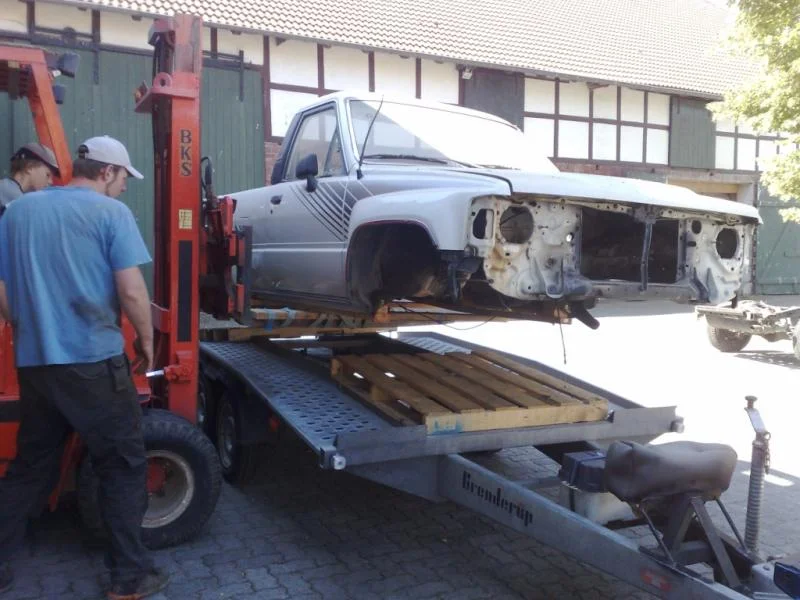

I got the body from Marc(___omt - offroad - solutions___).

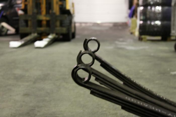

taking the rear with new perches

My plan for the Sunday was putting the body on the frame, simple thing with a lift. Body was allready located on a Trailer.
Move the Roller out, trailer in, lift the body off the trailer, trailer out,roller in, body down. Done.

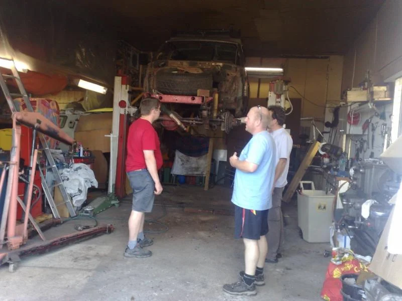

But for some reason(me:wrench:)the lift stoped working.
I called me girlfriend, the workshop is needed on monday. We got it, like Egyptians:)

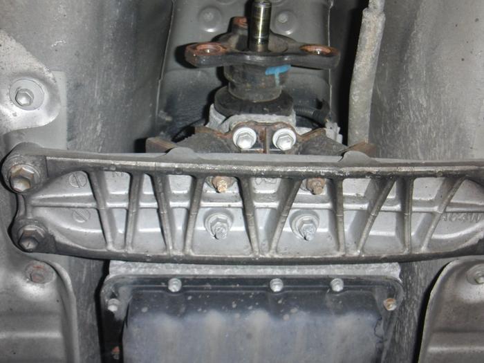

Bell from the 1UZ met the bell from a 2LT
We have here i Europe some Toyotas, Landcruiser for example with a 2LT or 2LT(2) and a R151F with Splitcase.
Same like last 60/61 Series.:)
The hole driveline looks verry compact, or just ......short.:)
