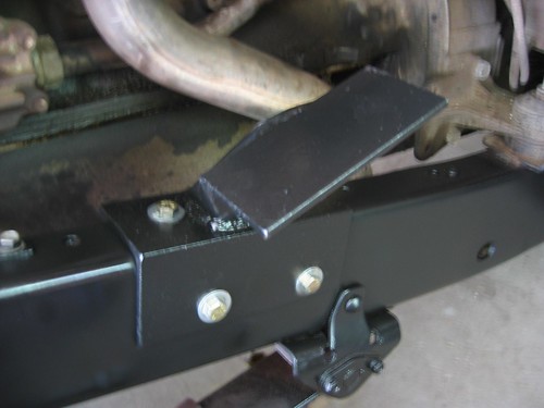

The I removed the gearbox off of the pedestal and removed the two remaining rivets using the same method I used for the first two. Once the pedestal was off, I cleaned up the frame where the pedestal was mounted and gave it a quick coat of paint. We let it dry a bit while we had some lunch.
After lunch, we mounted the new pedestal to the frame. The holes matched up almost perfectly (I had to clean out one hole to get the bolt through).
I had a tough time getting the washers and nut in through the back side of the frame without dropping them, so I used a bit of adhesive (Goop) on my fingertip (the "sticky finger method") to get the washers and nut on the bolts on the side of the frame.
For the bolts through the top of the frame, I "glued" the washers and nut together with the Goop so I could put them all on in one shot. I used some blue lock-tite on the threads for some added insurance.
