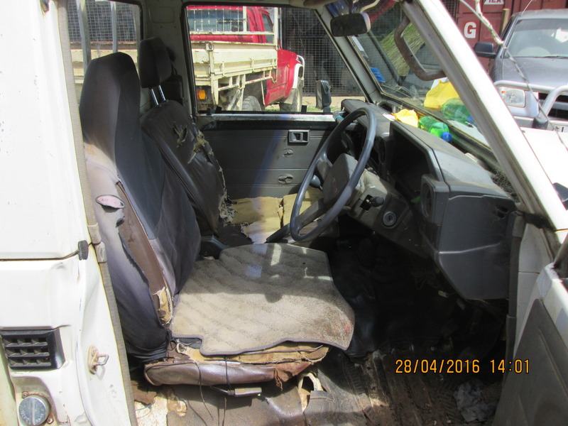

good interior, new driver's side seat cover:
Argh, the pictures don't do it justice--you can't see the body filler falling out all along the driver's side. Also doesn't adequately show the driver's side front wheel leaning inward alarmingly.

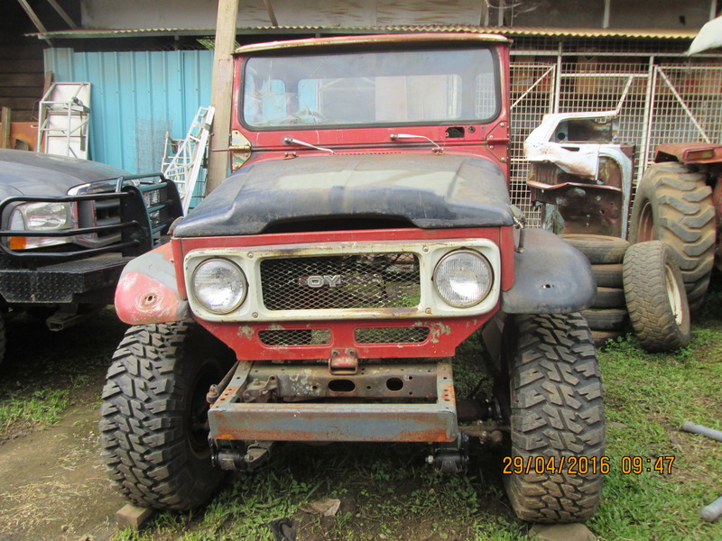

I took the headlights and headlight buckets from the 75, they are already installed in the 45. They might stick out maybe 4 or 5 mm farther than the originals, but they don't look funny. Interestingly, I had to swap them around, right side from the 75 had to go to the left on the 45 and so on because of the location of the spring and the adjustment screws. At first I thought that they weren't going to fit at all, because the buckets, although of similar design, do look a bit different.

OY is looking good with them lights. :)
:) I think the OY badge is going to end up staying. I may try centering it a little better at some point.
