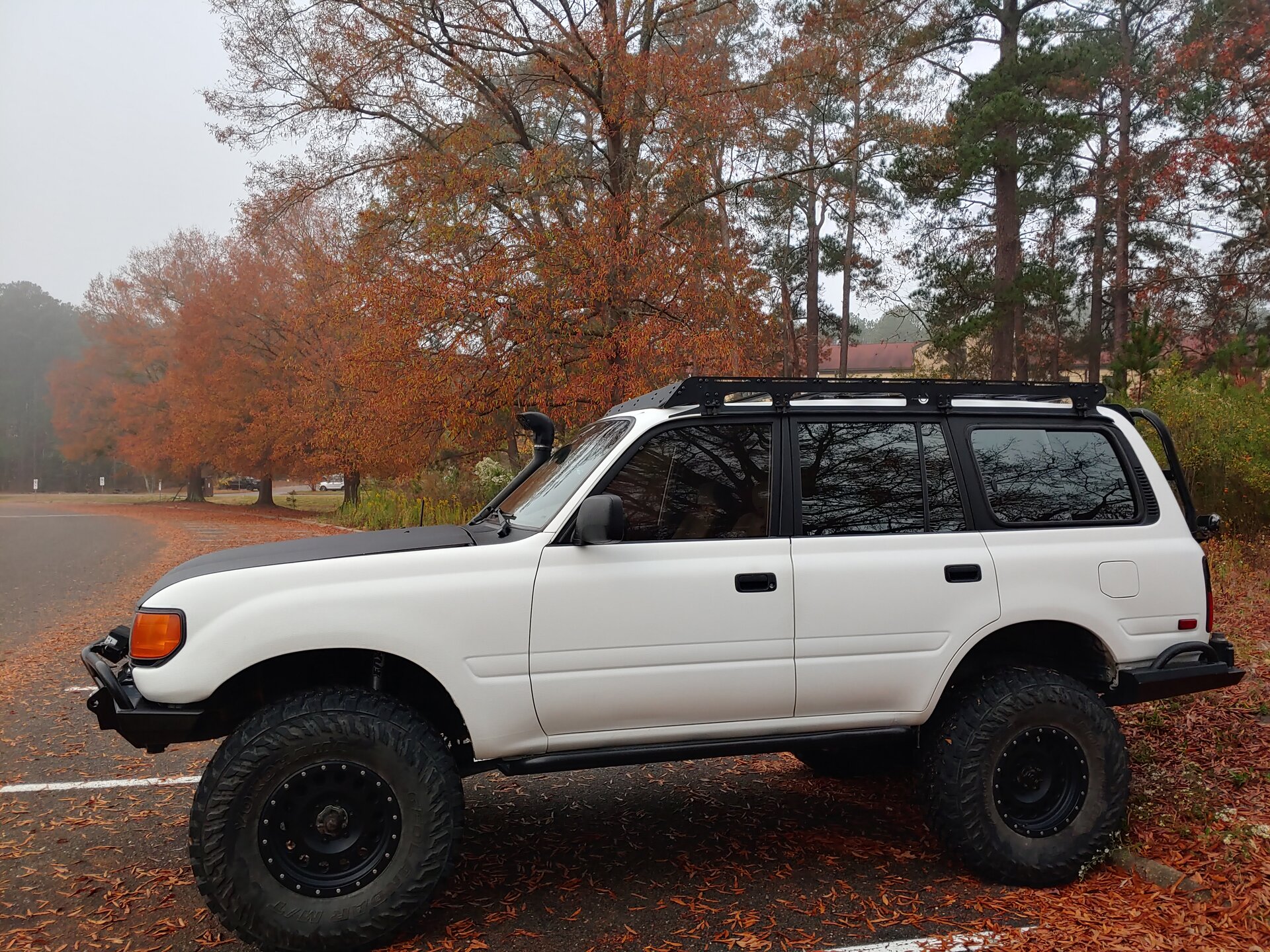

Left town for a week for work, but on the way to my buddy's house, I'm sure I blew the head gasket on the 80. I'll be able to diagnose it better when I get back this weekend, but at the moment I'm car-less.
The initial thought is since I'm leaving the country in a year and already have a project 80, just to sell this one as is. If I do this, what's an appropriate asking price? $15k? It's:
Supercharged and intercooler
Triple locked
529 re-geared
Slee front/rear bumper
37s
Cloth interior
and a bunch of other s***.
