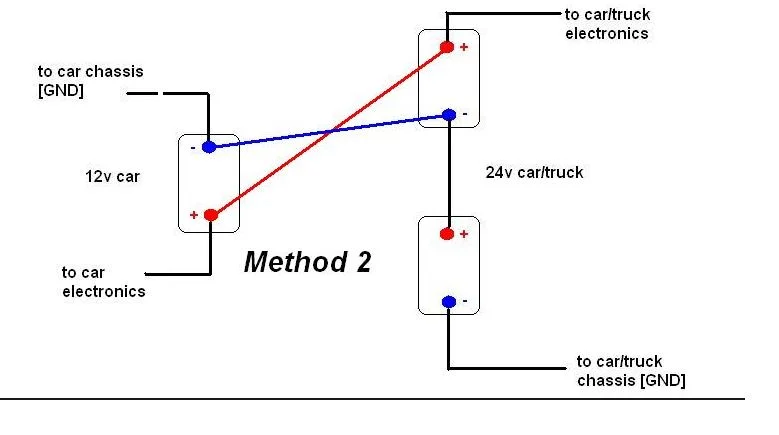

My truck is 24v. If my batteries are dead, what is the procedure to jump start from a 12v car with jumper cables? Would the procedure be the same if the 24v was used to jump start a dead 12v truck?

I usually do method 2. If I had a multi-meter with me, I might jump to the battery that has the lower voltage of the two, but I don't usually carry a multi-meter around in my vehicle.
And the same works going the other way (jumping from the 24V to the 12V).
Thanks for that but damn, it made my head hurt. I will read it again when I'm fresh and try to figure this out. At this point it looks like I need to ID the "high side" and "low side" batteries.

Thanks Owyhee. I'm going to print that and keep in my truck. Appreciate it.
