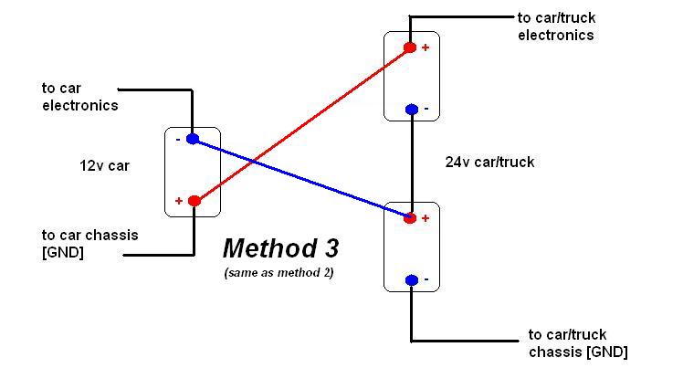

What does a guy need to know about jump starting a 24V rig. Or about jumping a 12v rig from a 24v rig.
This is doable.
24v truck jumping a 12v truck, on the 24v truck, connect positive cable to the low side positive terminal (which is 12v), and the negative cable to ground on the same battery (0v ground). Normal connections on the 12v vehicle, pos to pos, neg to neg. DO NOT try this same connection on the high side battery on the 24v truck as positive is 24v and neg is 12v!
12v truck jumping a 24v truck, on the 12 volt truck, connect positive cable to the positive terminal and negative cable to the negative terminal. On the 24 volt truck, connect the positive cable to the positive terminal on the low side battery (12v) and the negative cable to negative terminal (0v ground). DO NOT try this same connection on the high side battery on the 24v truck as positive is 24v and neg is 12v! To boost the high side battery on a 24v truck, use a jumper pack and connect pos to pos and neg to neg. There is no 'ground' with a jumper pack.
I recommend using a volt meter and becoming very familiar with the voltages present at each terminal in your system.
This is doable.
Wrong ...
The positive are 12v and the negative are 0v, so you can jump to or from your "high side" battery.
In relation to the 24v truck chassis you are right and you will see 24v in positive and +12v on the battery negative, this is the reason you cant jump/boost both your batteries in the 24v circuit from one 12v source, you will need 12v sources that are electrical isolated from each other.
If you take your voltmeter/multimeter and measure between positive and negative on your "high side" battery you will see something around 13v according to how well the battery are charged.
But I will tell you this, and this count for both giving a jump and receiving a jump: NEVER connect your jumper cables to "high side" battery positive and chassis ground! unless both vehicles is 24v, than that is the only correct way to connect the jumper cables ...
Conclusion: doesn't matter which battery you use as long as you correctly connect up your cables. If you for some reason do this often I would have jumped the batteries in turns, this will wear them slower, but by any means drastically faster than running them in straight 24v load mode ...
Wrong ...
I've read your post twice and I think we are in agreement so I don't know what you are saying is wrong. I assume you are referring to the statement that there is no 'ground' in a jumper pack. What I mean by this is that the ground is isolated from the vehicle so you can safely connect the jumper pack to the high side battery in parallel.
What I say is wrong is that you say you can't use the high side battery (24v battery), but you can.
2 different vehicles doesn't share ground so you can safely connect 12v car neg to 24v cars 12v (low side positive terminal and high side negative terminal) as long as 12v cars positive terminal are connected to 24v cars high side battery positive terminal, the same terminal you measure 24v.
If you think, thats what I said, then I misunderstud your post. It kind of look like you are saying that you can only jump with the low side battery, the one connected to 24v car chassis/ground ...
Made up these circuit diagrams as trying to explain circuit diagrams always lead to misunderstanding and confusion :hhmm:
Extra battery in circuit diagram can be just that or a booster, yet another car or any other 12v dc source that are isolated from the others ....
Enjoy :popcorn:

Lasse, those diagramme are great! So which one is wrong? Perhaps you could correct it and post it up again please? This is something electrically-challenged guys like me need! I would print it out and put it in the glove compartment for sure!! Thanks!
All of them are wrong in the way kim pointed out, but it just a minor text/description fault.
If you look closely you can see I have written that the positive terminal on the 12v car goes to chassis ground and the negative terminal on the battery goes to the car electronics. This little mistake are repeated in all the diagrams as I was to lazy to make the basic diagram from scratch for each jumping method. The connection itself are correct in all of them and thats what matter. To late here now to redo the diagrams. Maybe I do them over tomorrow or the day after.

Sorry, to revisit this thread so late, but is has the diagram been corrected? Is it method 3 that is incorrect? so that the negative should be to the low side negative and the positive to the high side battery? Thanks
All the diagrams still have a print layout error. The 12 volt battery image shows that negative (-) goes to "vehicle electronics" and positive (+) goes to "car chassis". This should be reversed. 12v negative pole should go to "car chassis" and 12v positive pole goes to "vehicle electronics"
If you ignore this error, the connections are correct if you match the (+) and (-) battery terminals.
It's also super confusing that the 12 volt battery terminals are upside down next to the 24 volt pair, which is why the circuit lines all cross each other.
All in all, not a very clear or correct diagram, but if you can get past the confusing bits, it could still be useful- And all the 5 different methods have correct circuit paths, none of them are wrong ways to jump the vehicle.
