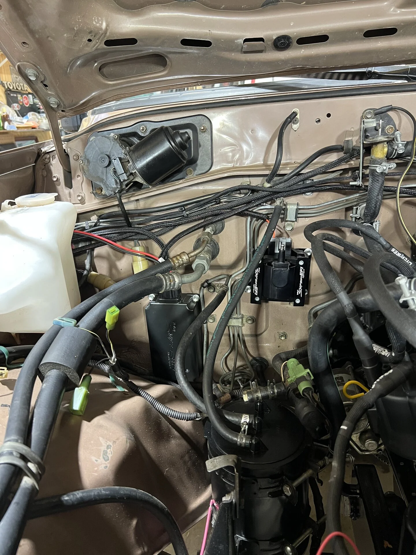

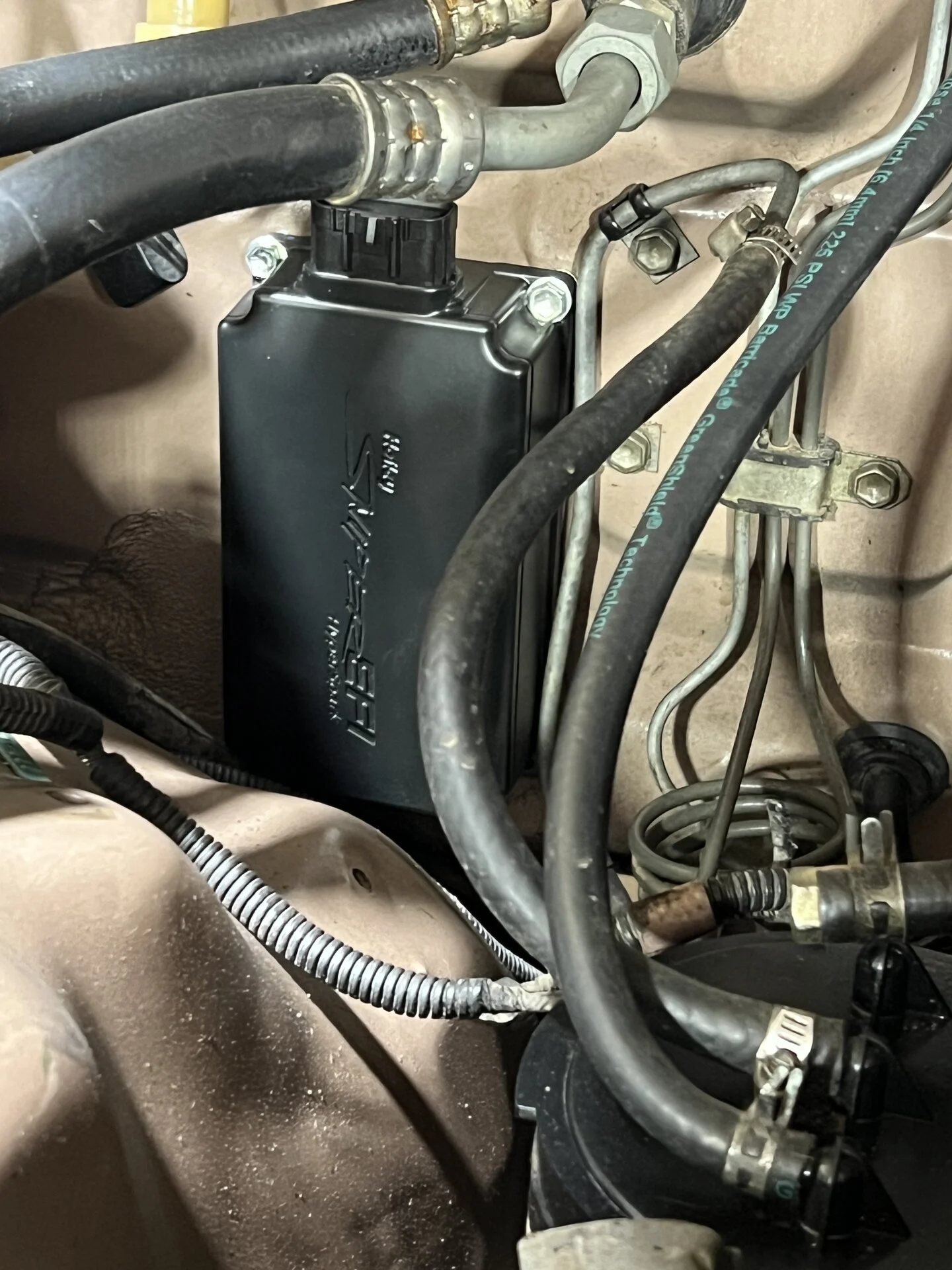

I got back and added the new AGM Series 27 battery and all the wiring back on that was here before and laid out my routing for the next round of wires.
Next I found some real estate for this Hyperspark stuff.
I briefly entertained self tapping screws into the firewall then caught myself and broke out the rivnuts. Pretty good location I think.

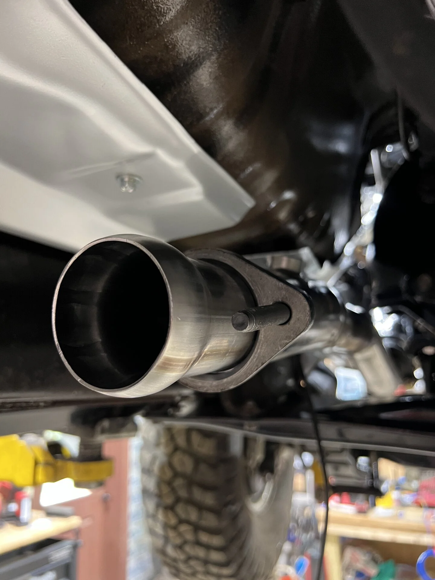

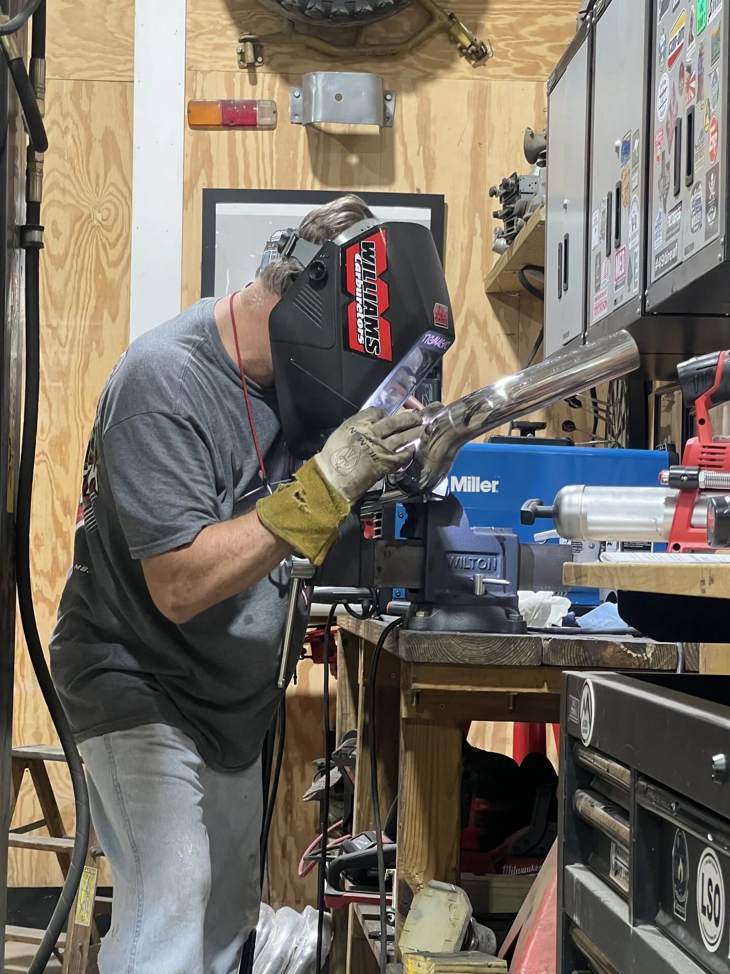

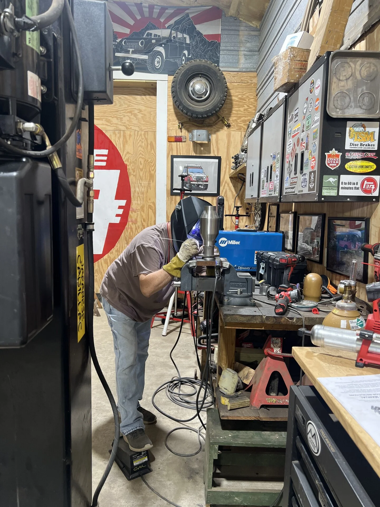

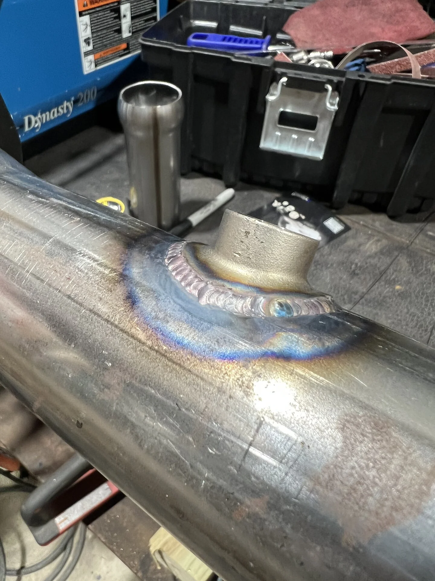

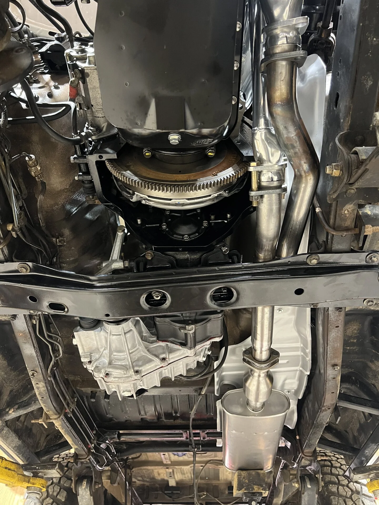

The Wizard has begun the exhaust ….

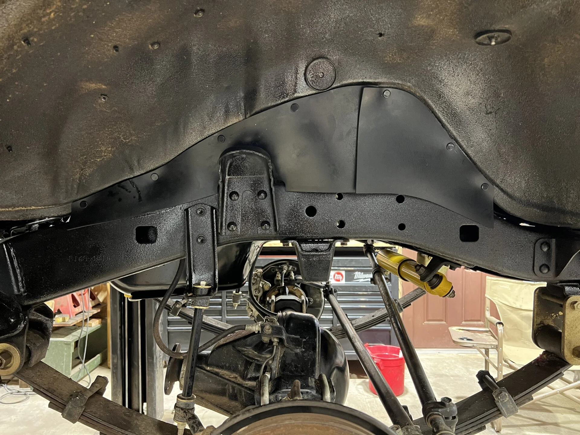

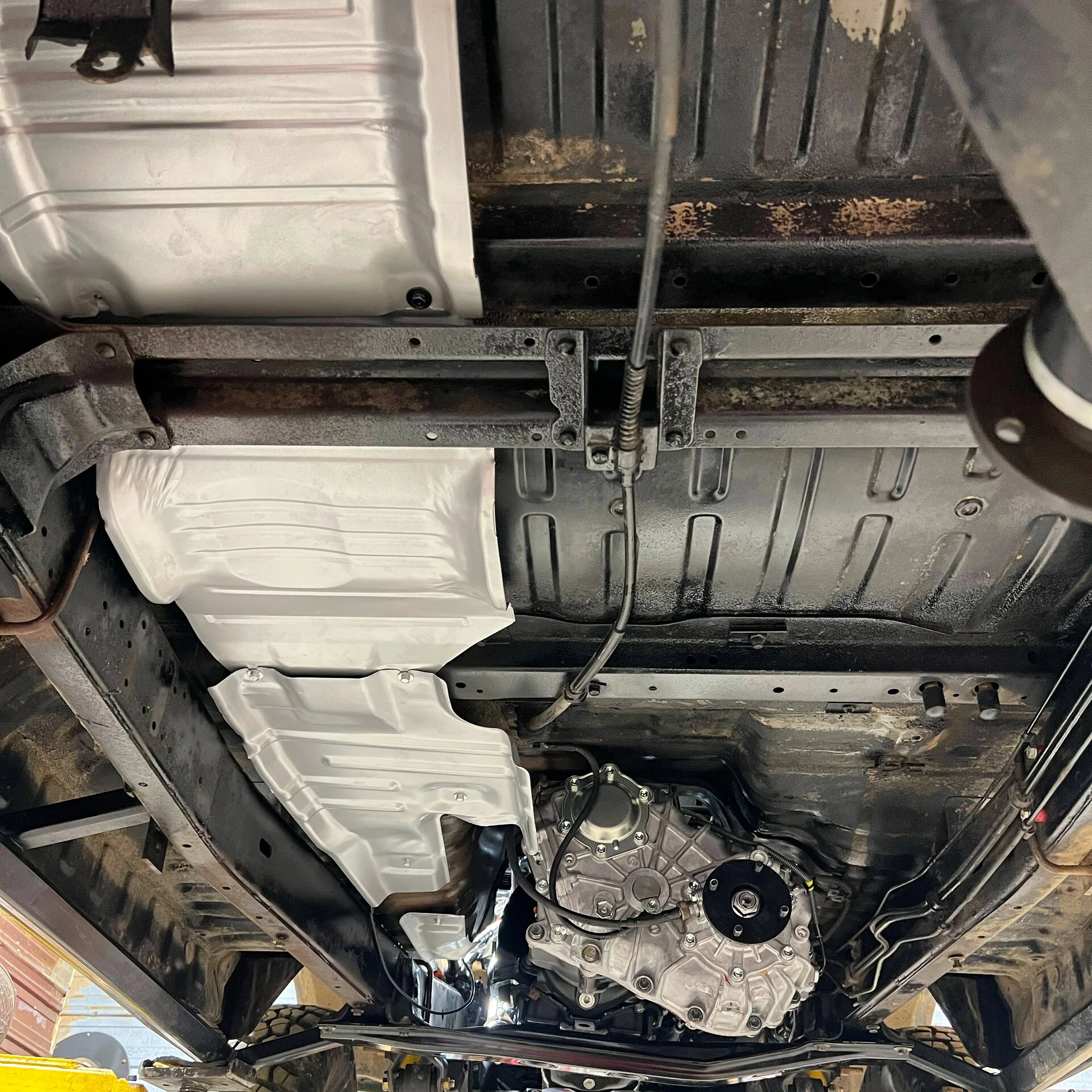

I pulled all the heat shields and had them powdered. I’ve scrubbed the inside of this thing inside the frame rails and applied a nice thin coat of Fluid Film. I personally like the look of clean OEM original steel with a little FF on it. Paint looks like you are hiding something. This is the most rust free 60 I’ve ever worked on.

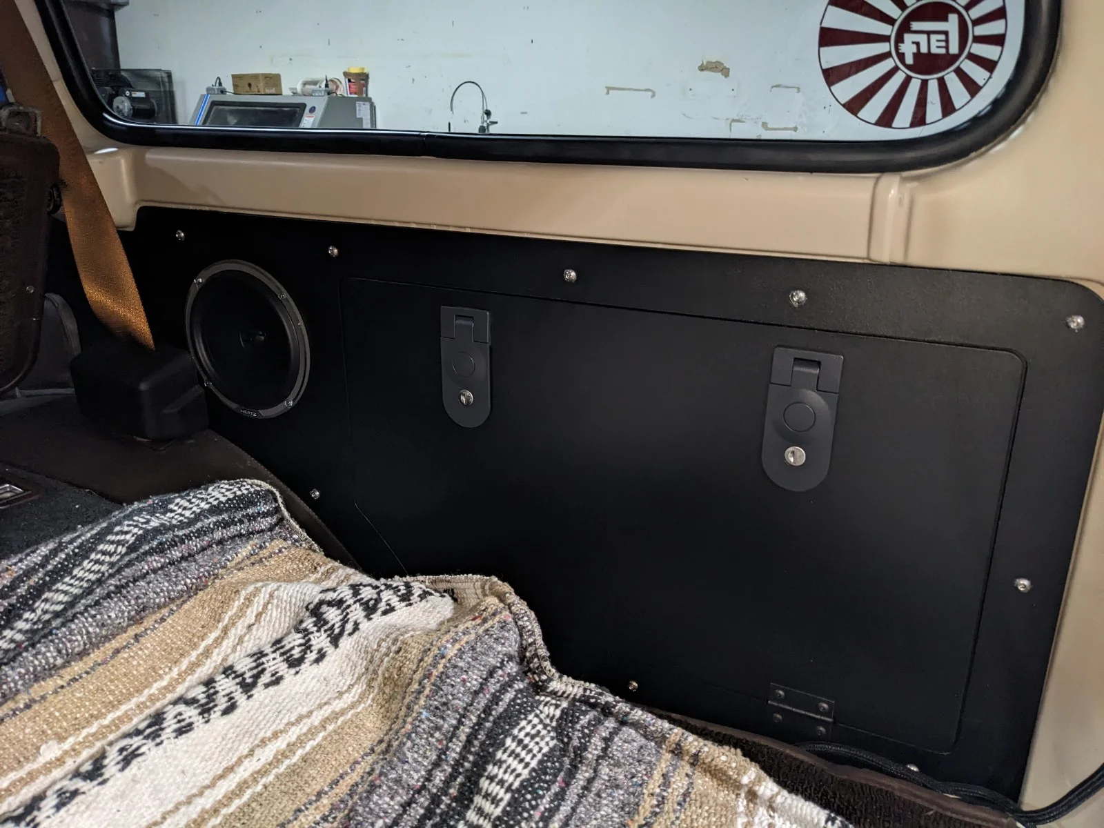

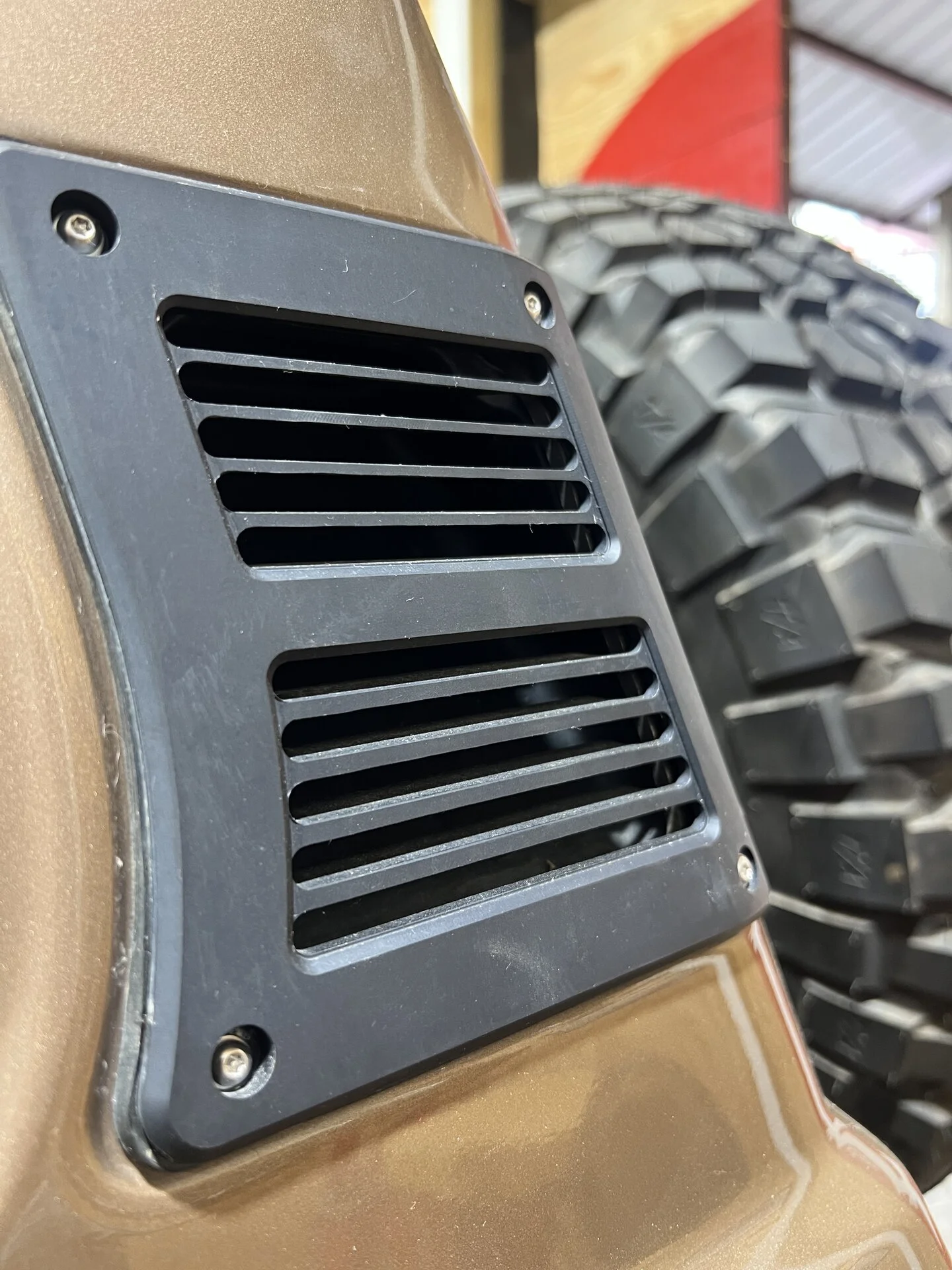

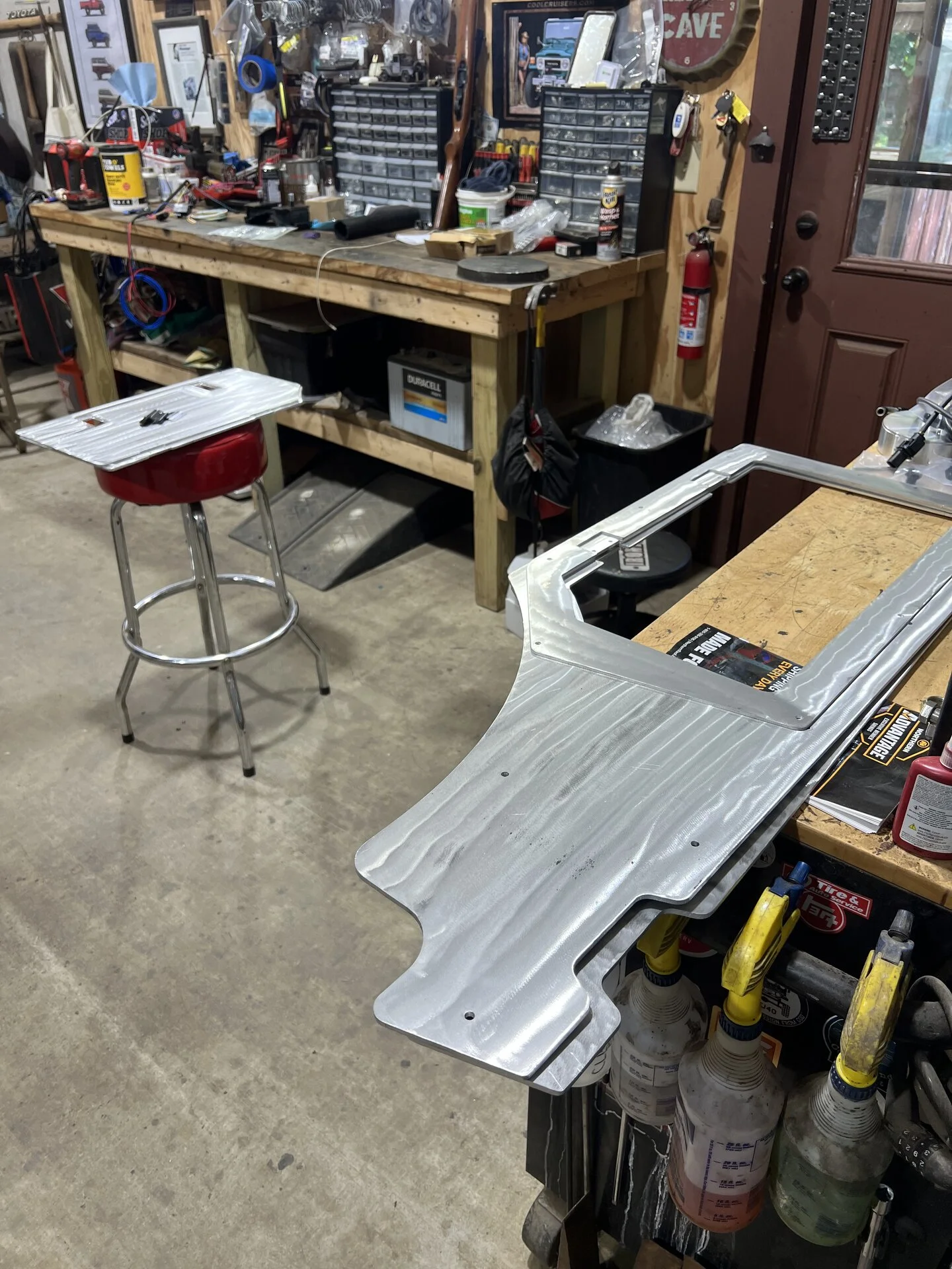

JTUs brother in law dropped off this Rubics cube set of side panels via @TRAIL TAILOR …. Taking them to Powder Keg. I think I see how they work
Meanwhile I’m holding this and measuring that for the Wizard
N,
1-Remove old panel
2-Remove upright supports
3- Install hinges to front of panel and door
4- Put thin backing plate behind panel
5- Install with supplied M6 hardware
J
I got two bags of hardware and 4 rubber buttons. Where the buttons go?

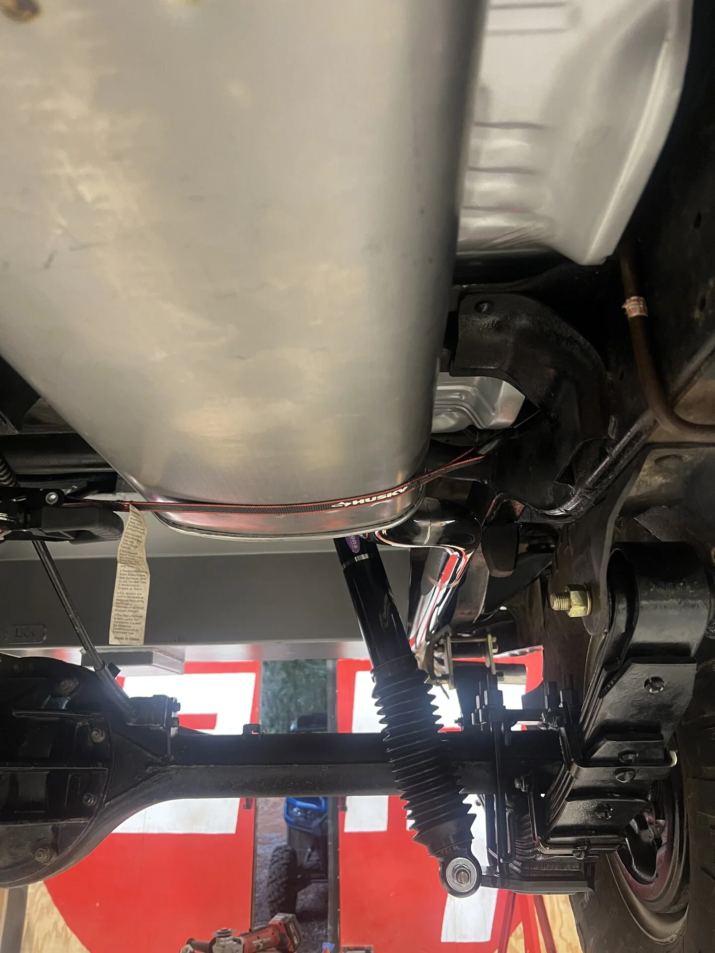

Exhaust is done through the muffler. Taking the non-stainless Y pipe for ceracoting and we will finish this up once we have the LRA tank in place
It’s been a @TRAIL TAILOR morning . Dropped the side panels and bezel off to PowderKeg this morning.

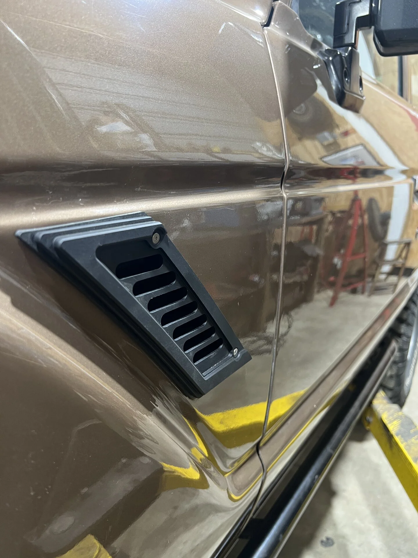

Added these cool billet items and cleaned up the front fender areas and added new TT skirts

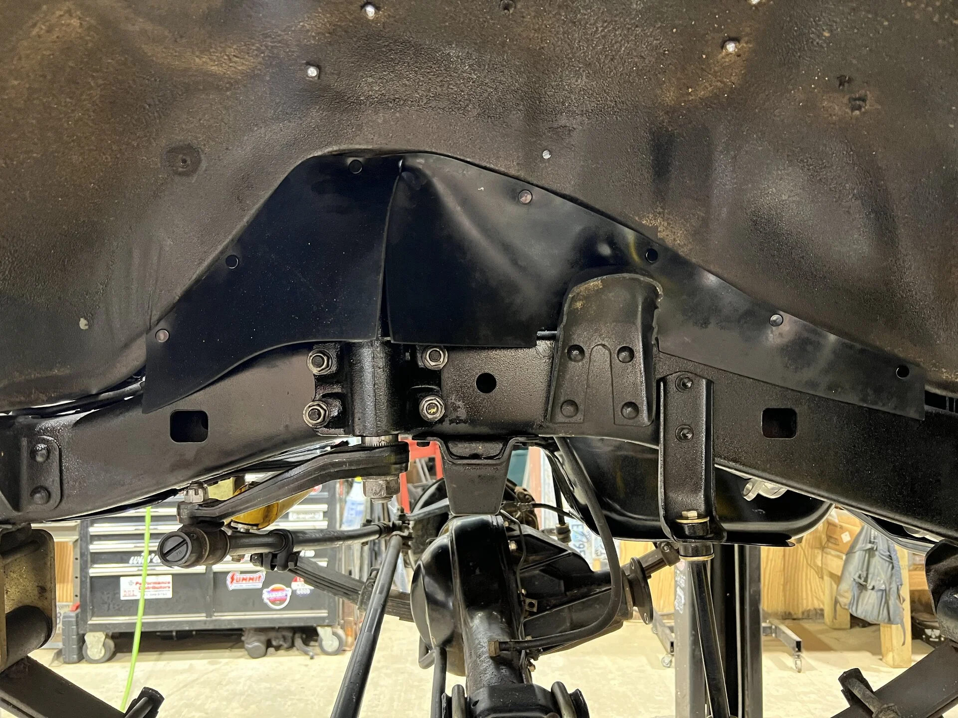

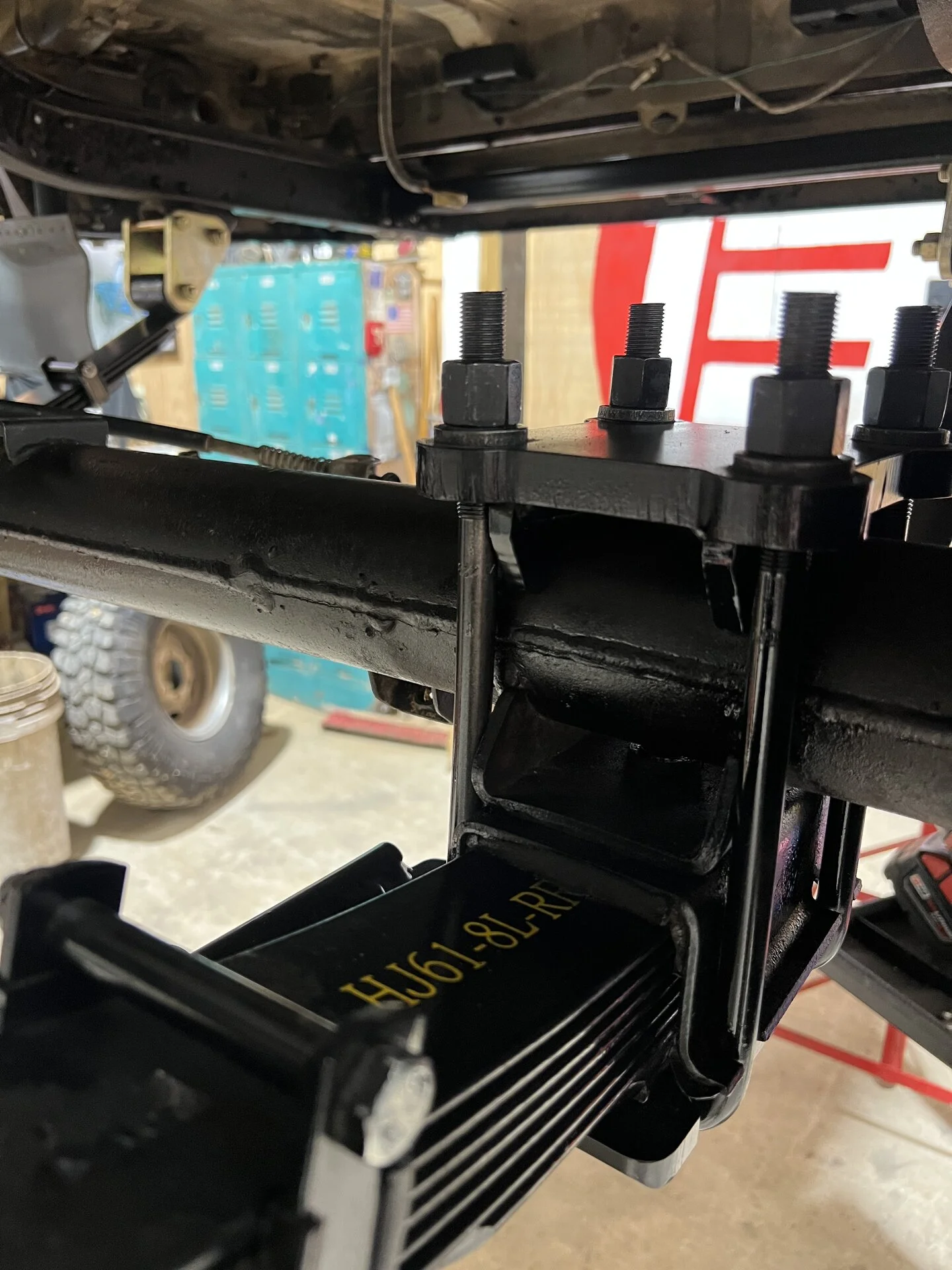

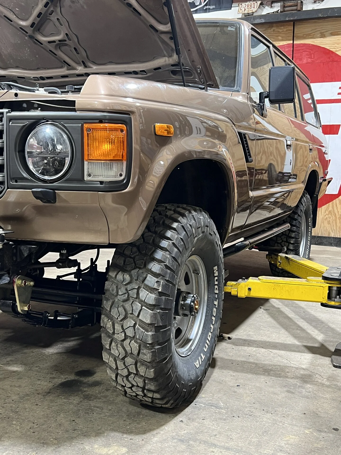

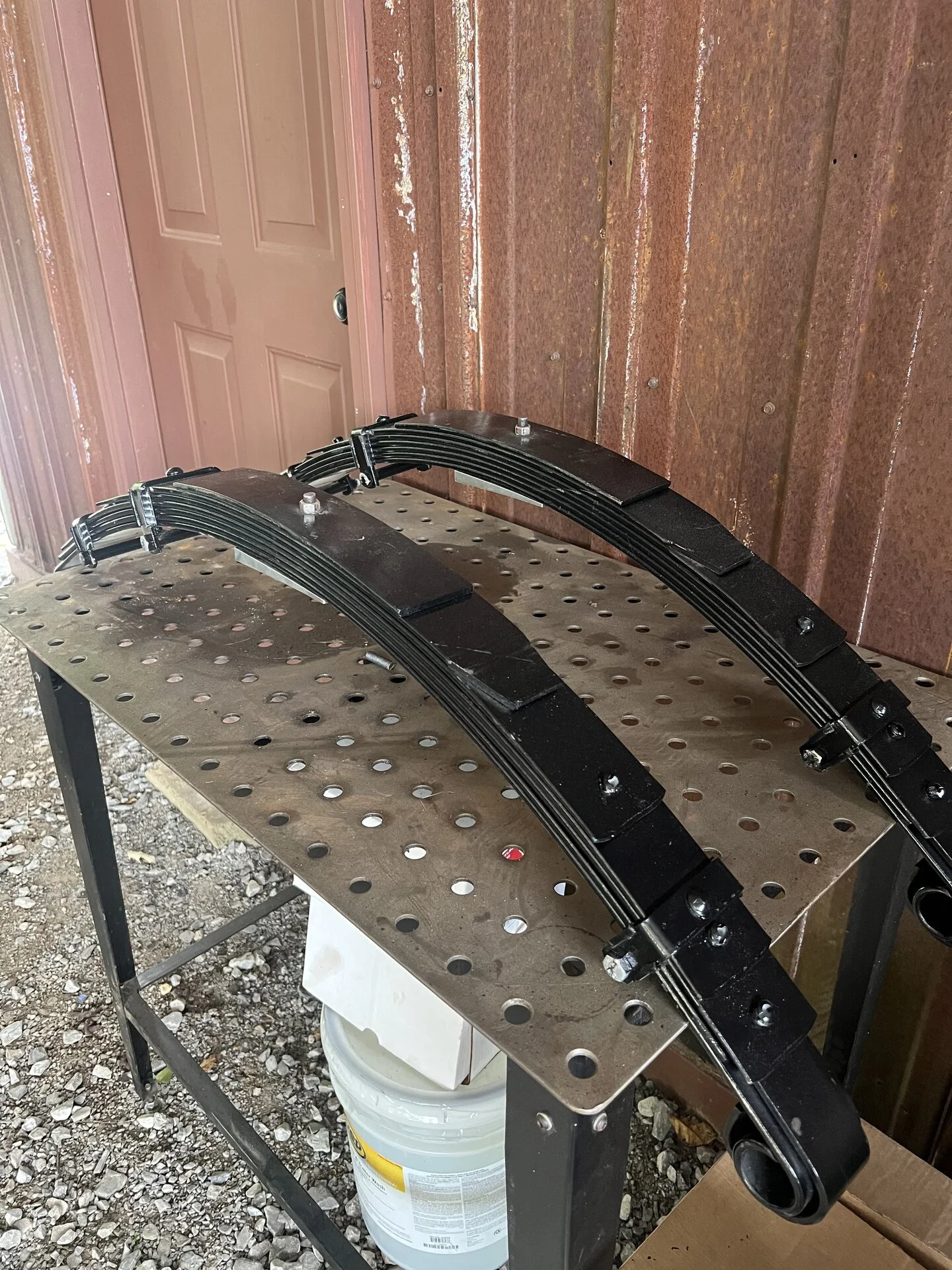

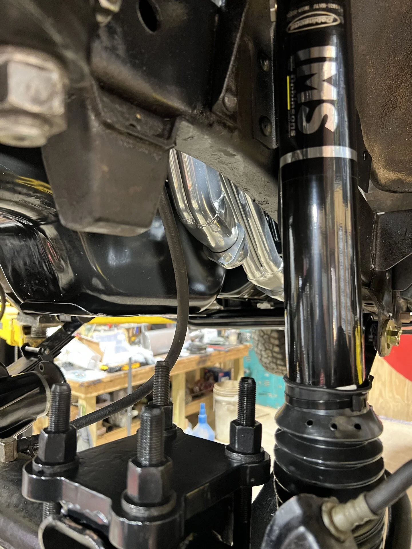

Added the steel 4* shims to the fronts

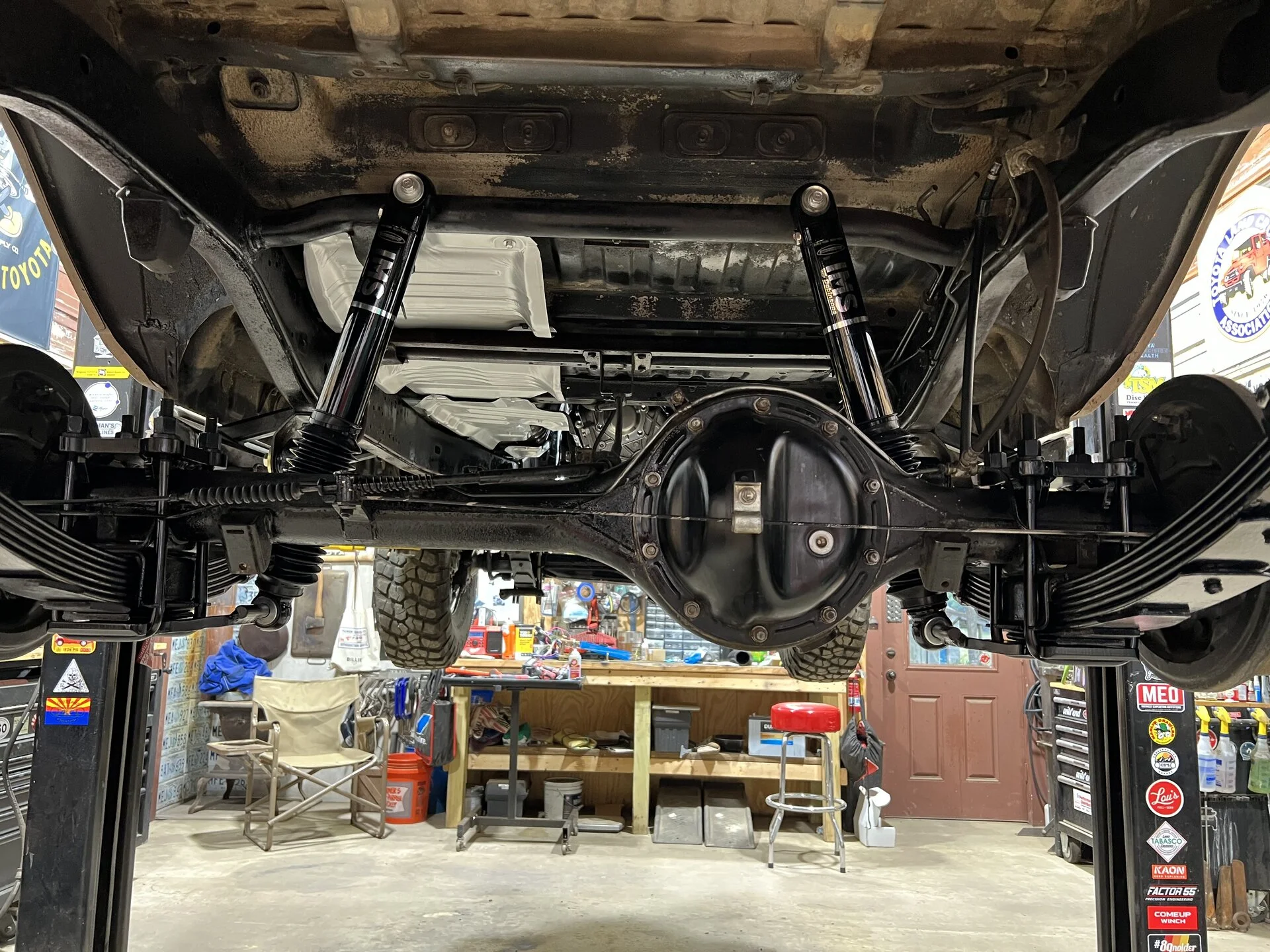

Got the rear completed with the beautiful 4Plus flip kit. Thank you @lcwizard
Ubolts trimmed. Painted.
Dobinsons IMS heavy kit going in.

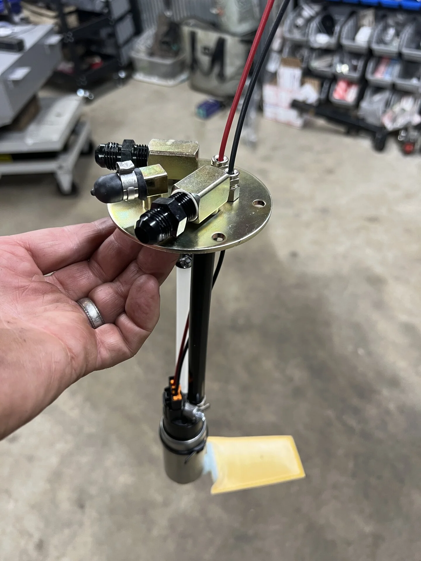

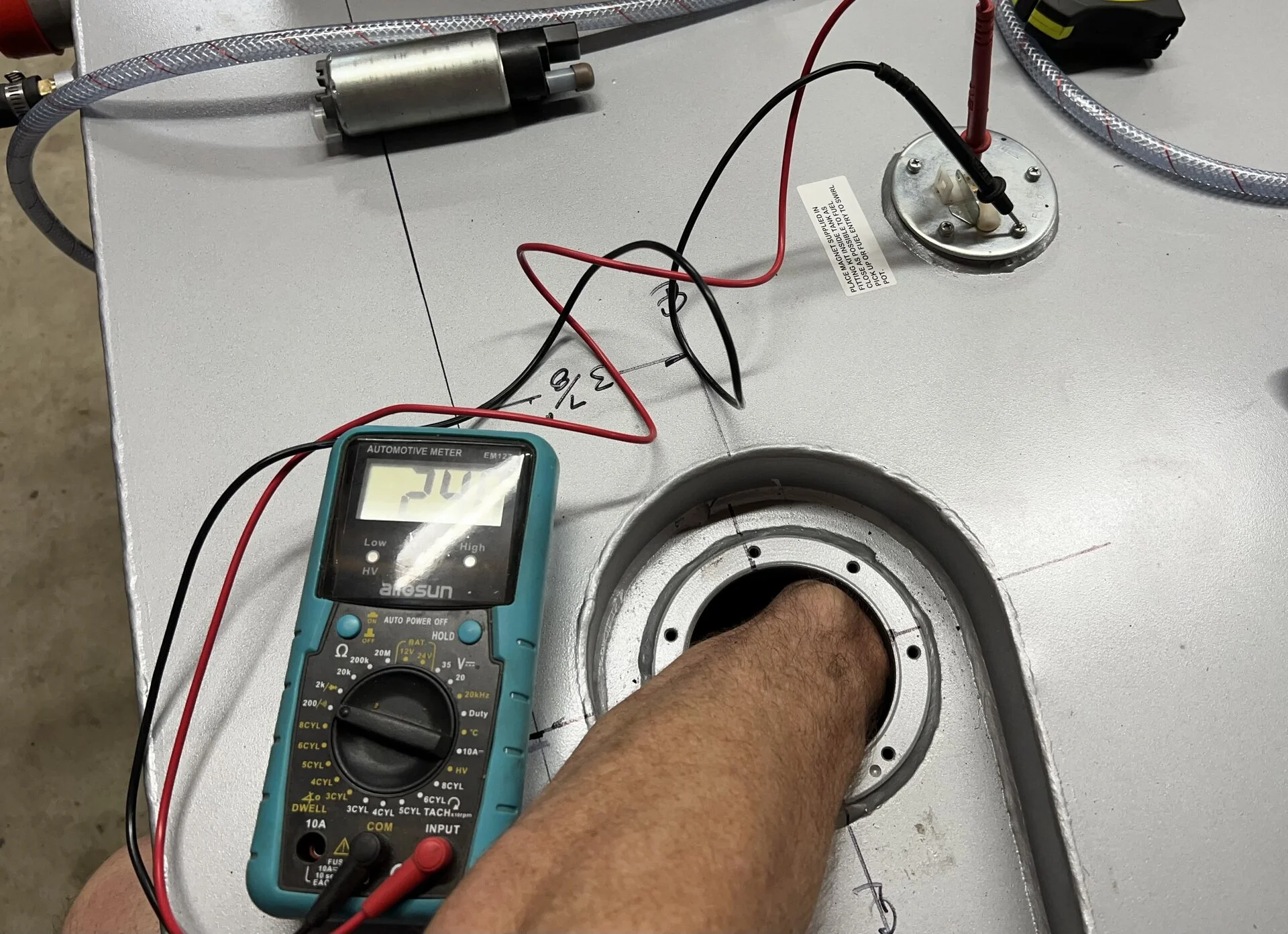

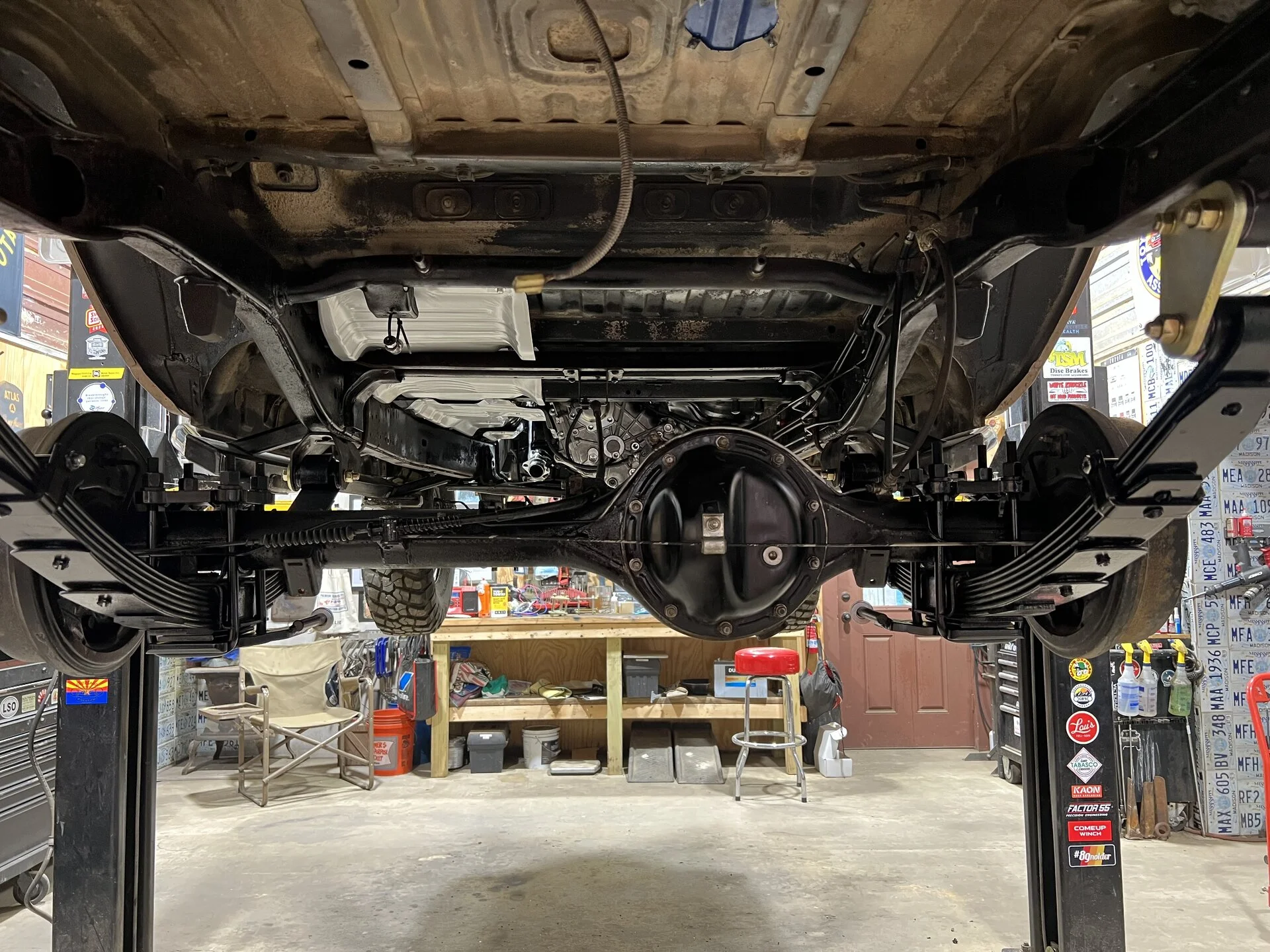

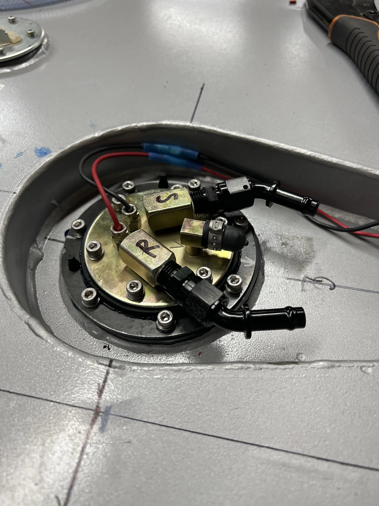

Got the @tmxmotorsports FJ62 to Tanks Inc adapter.
Got an OEM FJ62 gasket from @cruisermatt

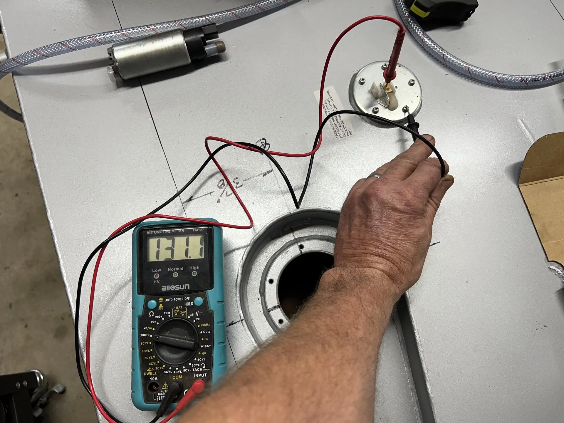

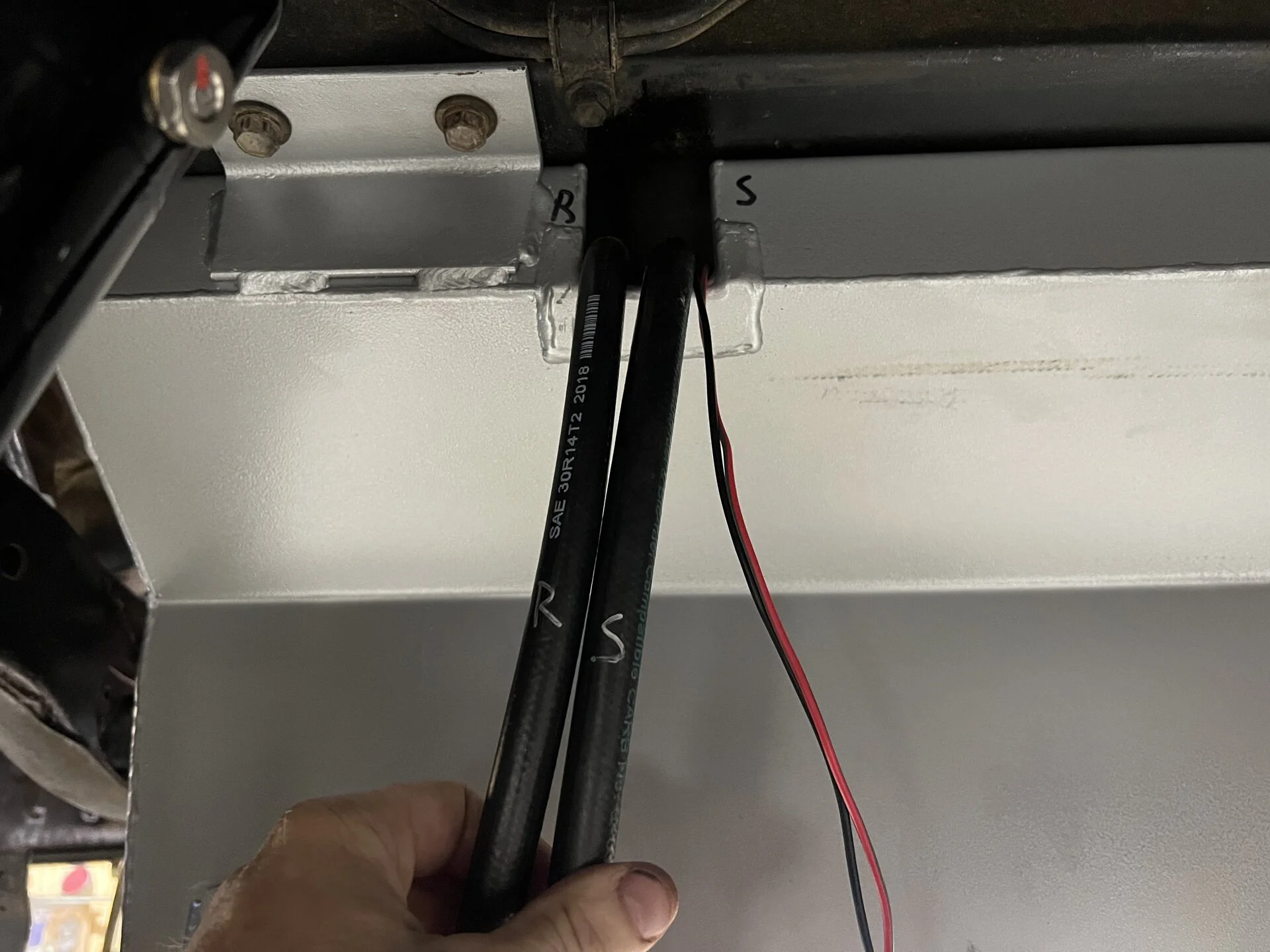

I tested the new OEM sending unit since there will not be an inspection door for it

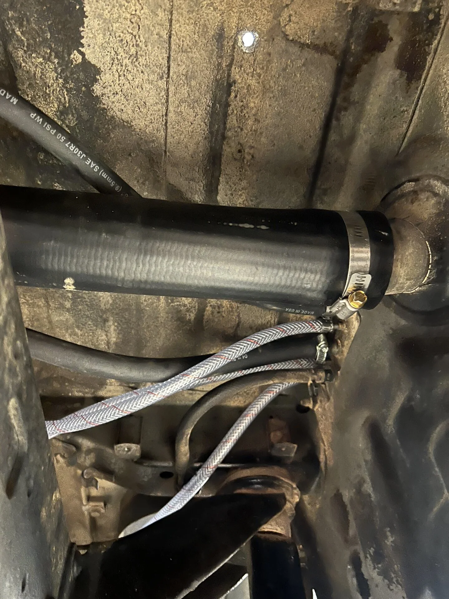

Added some wire extensions and will add a couple sections of fuel line before i stuff this thing in place

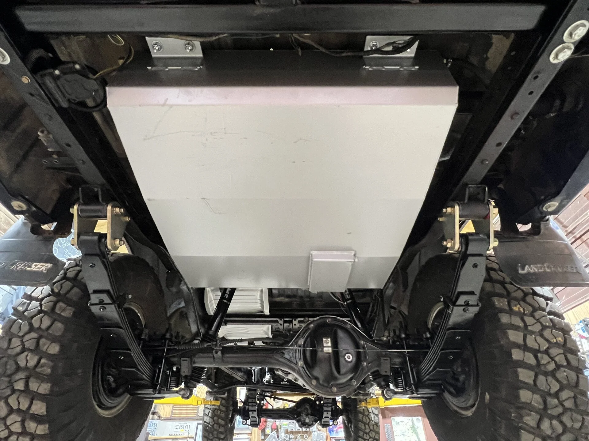

It’s in. My 1000# lift table was clutch for this.
Wire and plumb day tomorrow.
Hope the Wizard comes out for the final exhaust routing as well
